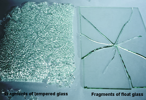

tempered glass shatters into a kabillion little pieces and tiny shard slivers
and if a slider, it was tempered glass ..it's the law
If cut pile, no way in hell you'll get it all out ...to give any kind of assurance of such, you'd be either stupid or ignorant ...or both
an 'ats a fak Jack
i was working at an old condo many yrs ago doing maintenance and had an old slider that wasnt tempered. i about got nailed i was kneeling in front trying too adjust the tract and door and glass flexed just enough and broke into huge heavy shards.
