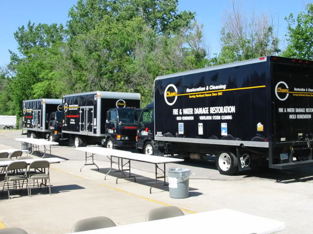

Michael
We have 8-box trucks, 1-LCF, 3-Izuzu's, 3-Ford's and 1-GMC, the LCF is the preferred truck of the group.
It's built better than the Isuzu's, the cab is built much more solid, but she will still shake your rocks out of the bag! If you're wanting smooth, Ford or GMC is your best bet.

nice trucks richard! i want the ford lcf as a water damage equipment hauler. it is becomeing a pain to ask friends or family to help me pick up equipment everytime i have a big job. at what point did you start needing trucks just to haul dehus, fans and other equipment? and do you think an 07 lcf 13000 miles with a 16 ft box w/liftgate is worth 20K? i am really anxious to buy because i am on my biggest water damage ever and alll my equipment is at one job and it will take three pickups two trips to pick everything up. plus like your trucks, it looks so much more professional. did i mention you had nice trucks!
Our LCF is a WDR equipment hauler, no TM in it just racks. It will easily 60-air movers and 10 Drizair 2000's a couple of E-TES's and Injectidry's.
We use it just as you mentioned, it can be used to pick up multiple jobs or loaded full waiting a large job.
We've only had it a couple of years but it is the favorite truck for moving equipment.
2-of our other boxes are empty and we have used them for years to move equipment when not in use for fire work.
