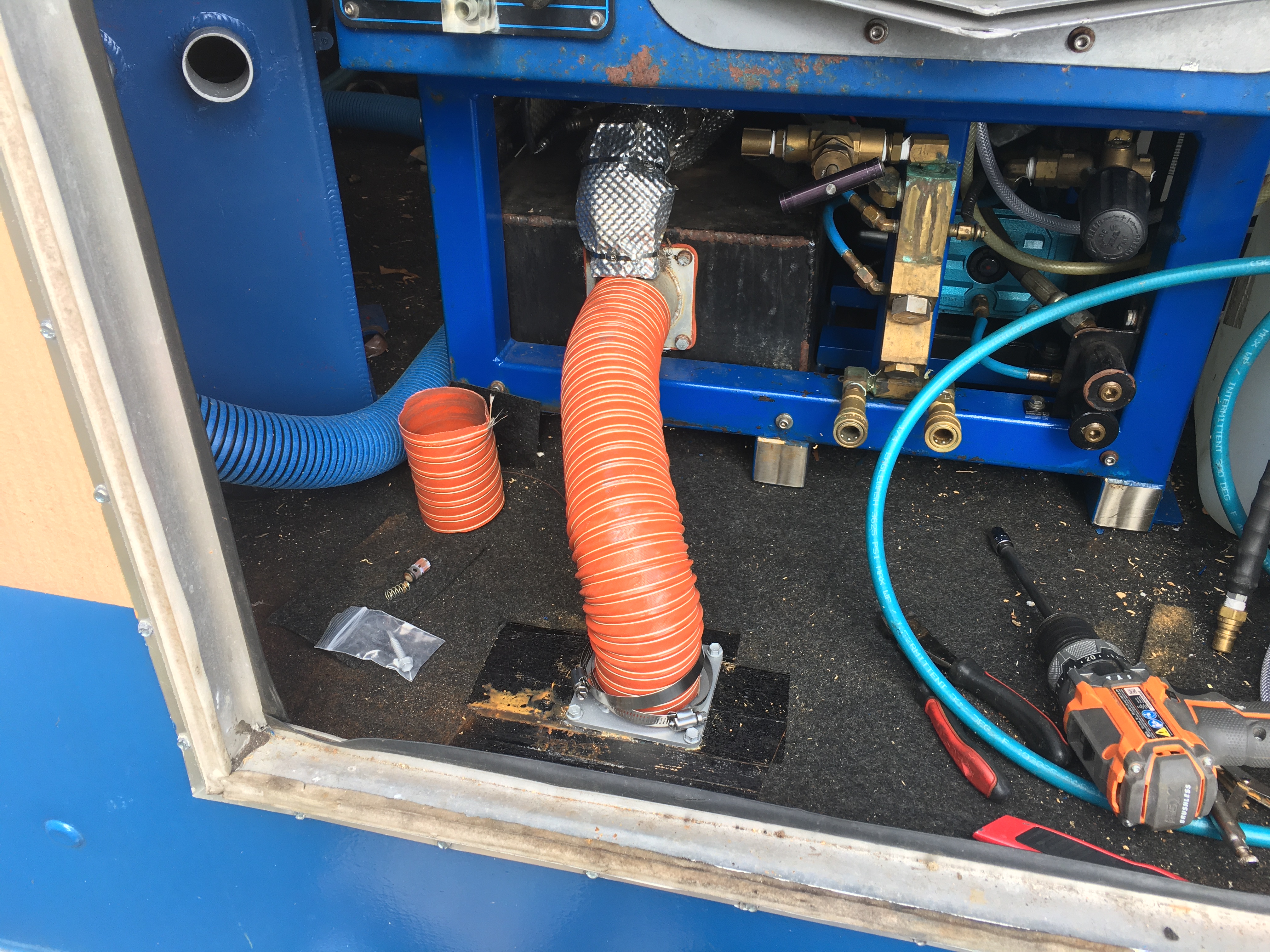

I’m taking it to the forklift later this week to move it. Rubber mats underneath are getting pulled up.
The waste tank was behind it but I think I’m gonna move it to the left side of the machine for better mounting space and ease of access to the rear and right side of the machine.
The van needs a power steering fluid reservoir, a tuneup, and a new rear door
As for the tm, the water pump needs tlc, and the 185f thermal relief valve needs replaced. 🤞. Once I get it completed, we’ll see what other issues it might have

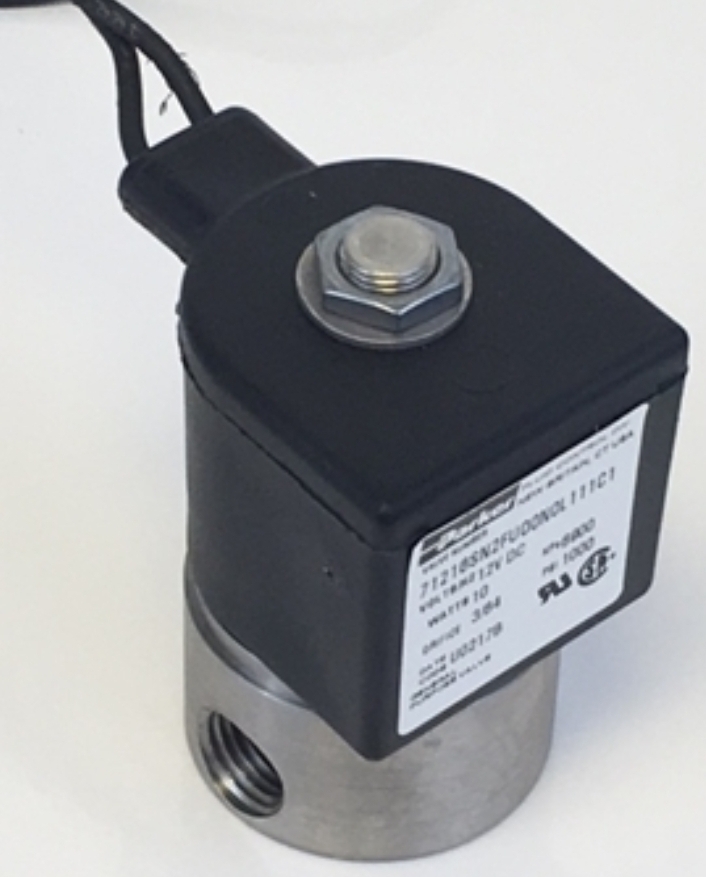

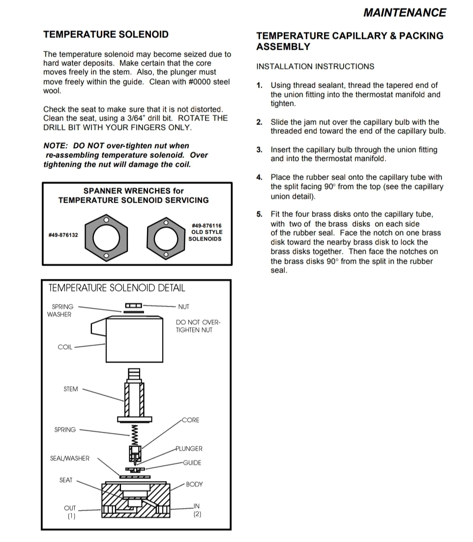

I don't know that machine but on older Prochem units a temperature solenoid controls bypassing water. It would bypass when too high a temp. It would also if scaled up and needed cleaned.
There is also a bi-metal thermal valve in the water box that if it got too hot would dump into the waste tank.
Are you referring to the temperature sending unit on the check valve?
As for the thermal relief valve…I’ve got it temporarily disconnected until I find a hose to connect it to the waste tank

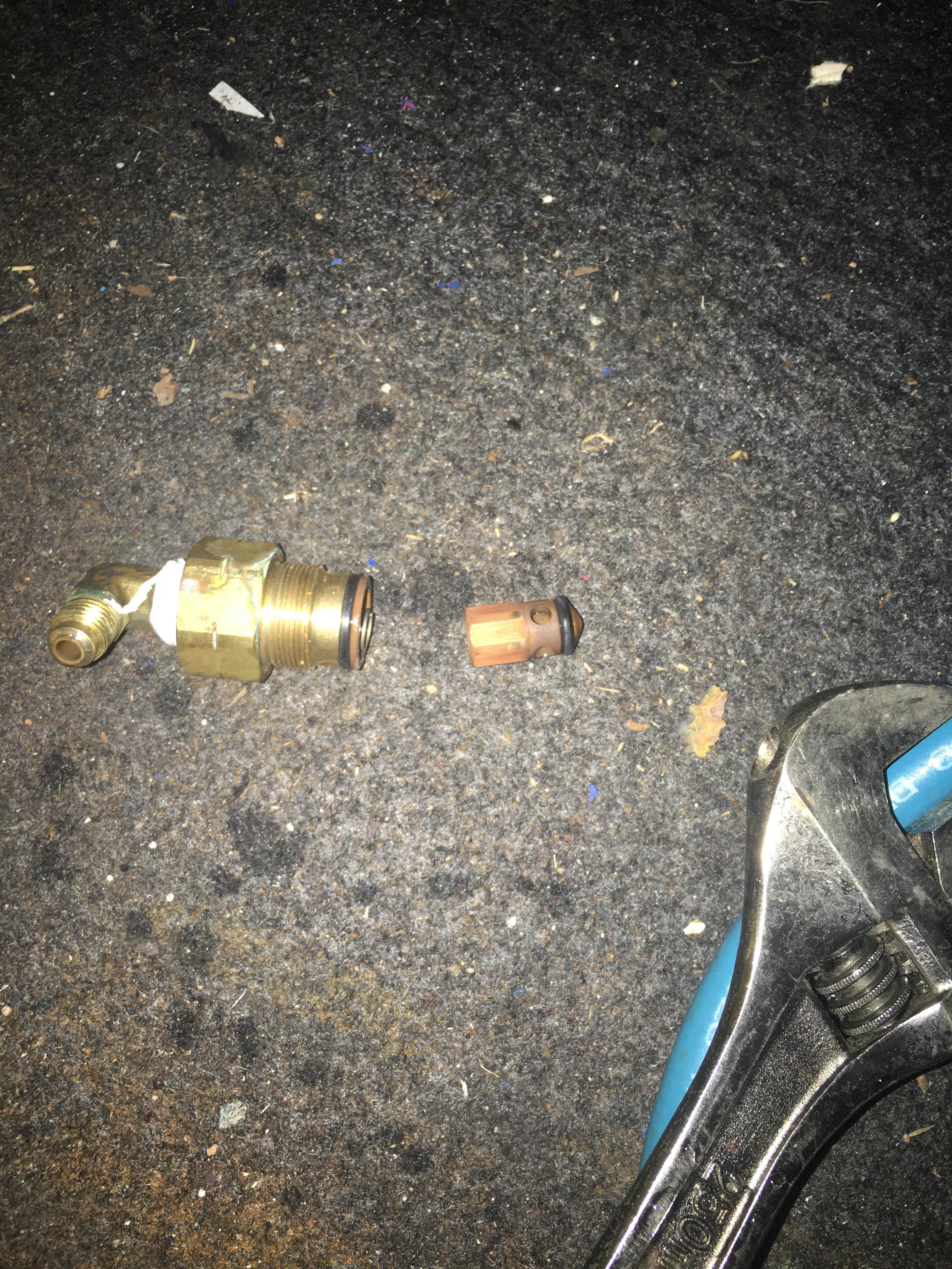

Another challenge completed today thanks to @Jim Martin
The temp kept dropping when I let off the trigger. Jim came to the conclusion that the check valve in the pressure regulator had to be in it. And it was. So I took it out and it’s holding heat just fine.
I forget why some truckmounts need them and why some don’t, but it’s a good thing to check first if your tm is doing the same heat loss.
