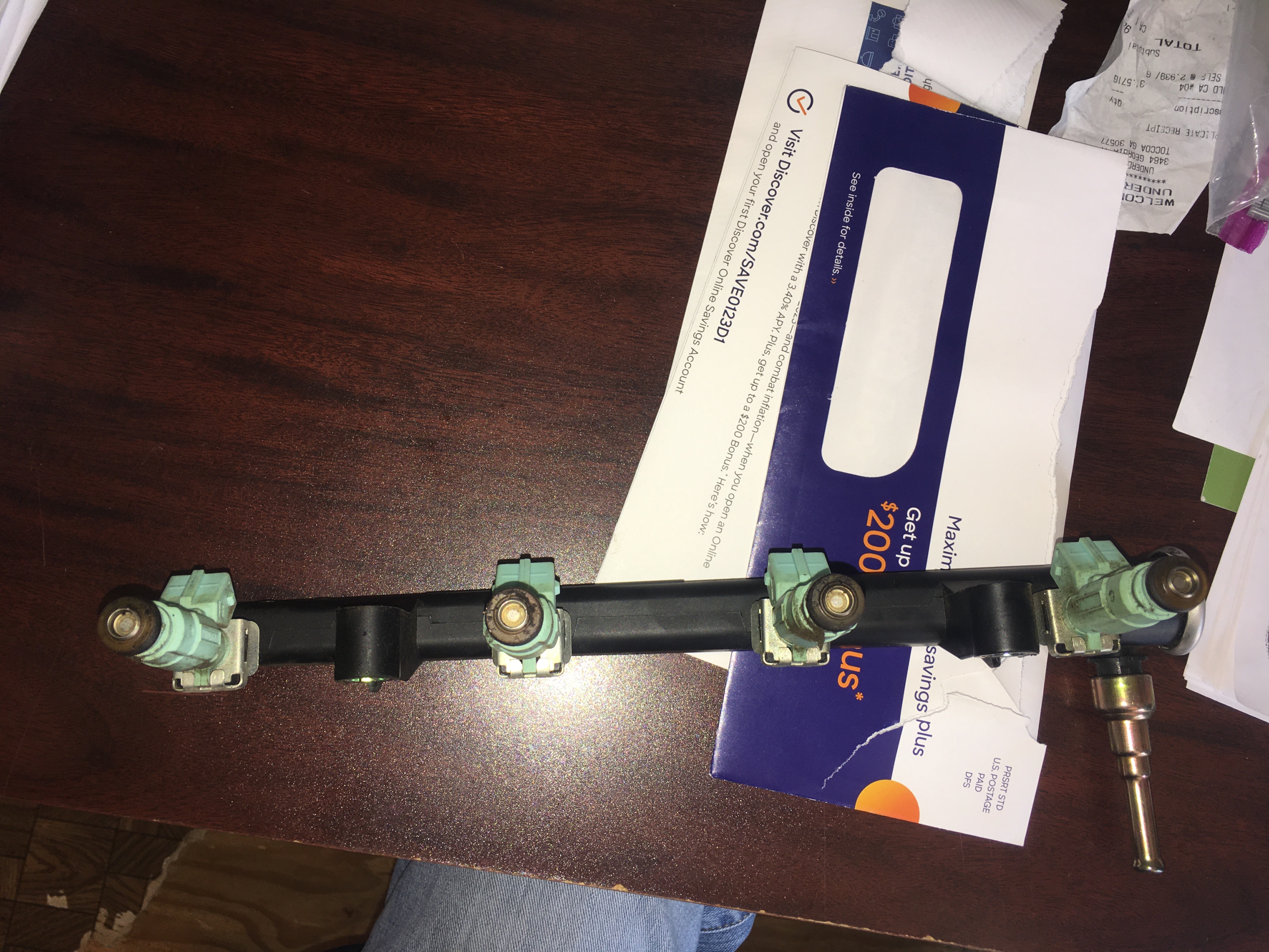

Does this look dirty to you guys? I wasn’t able to test it where it’s located at
Wtf do you have the fuel rail off now? Did you at least volt/ohm test them? Listen to see if one was acting up?

I'm just reading anything that might cause the glow if it's lean fuel burning. I picked up another set for $75. Amazon product
I pulled one out of the fuel rail and noticed some debris inside the rail where it plugs in.

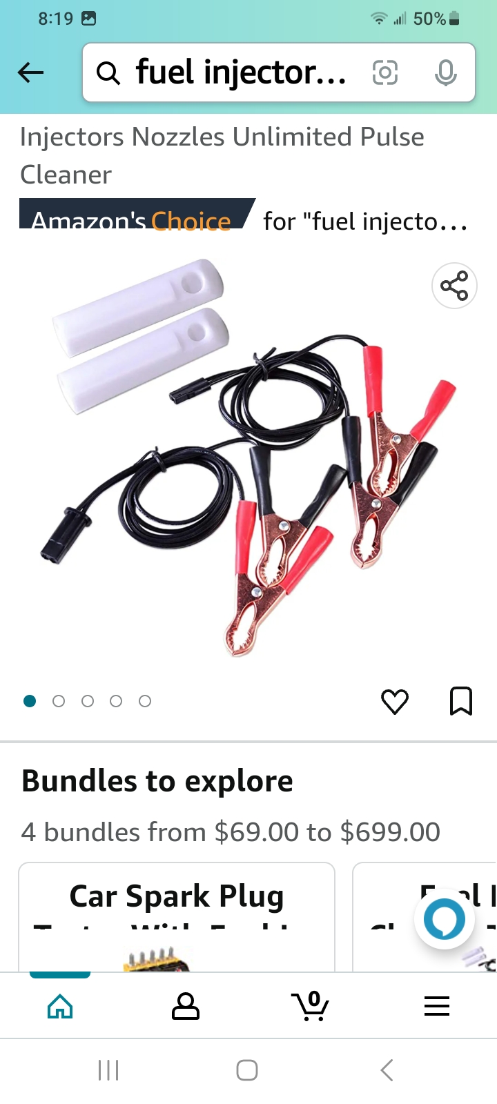

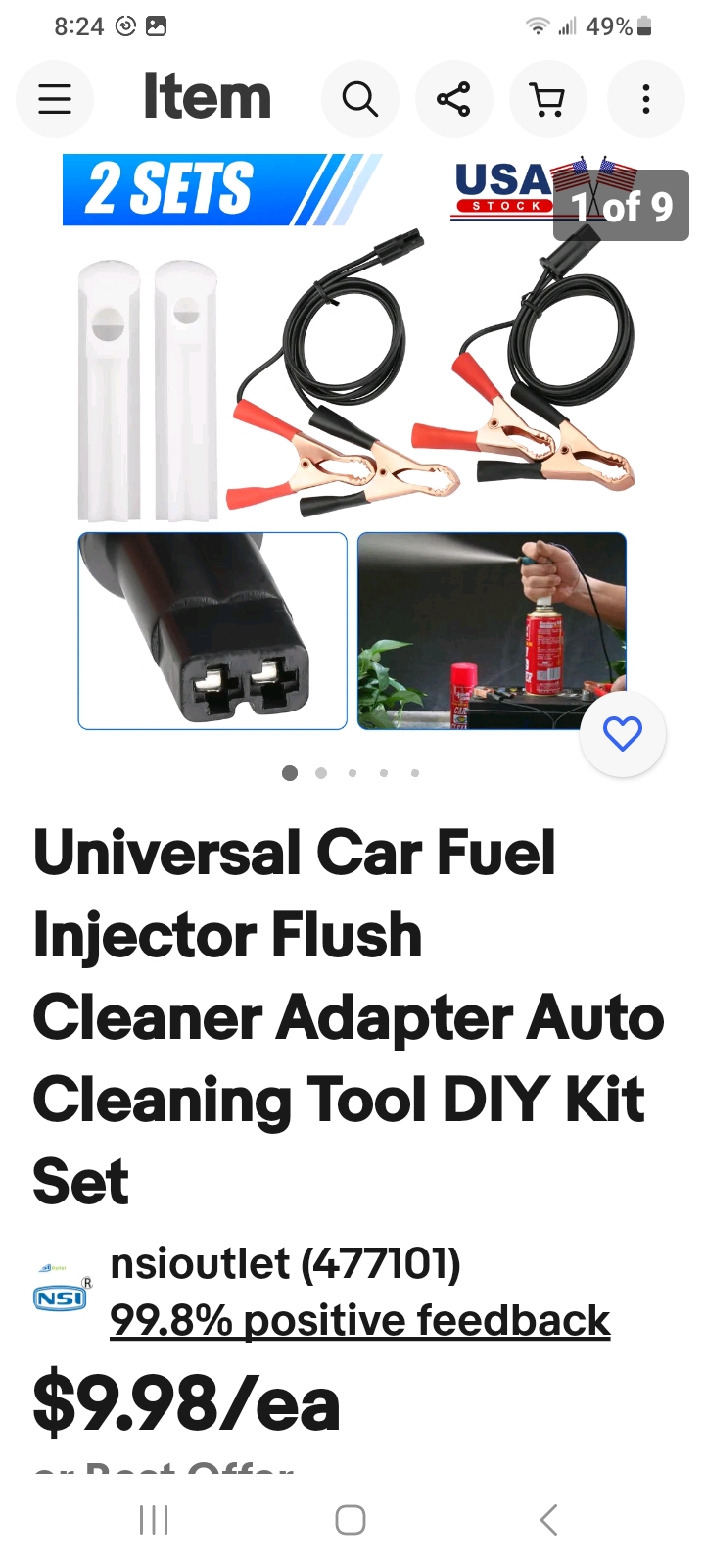

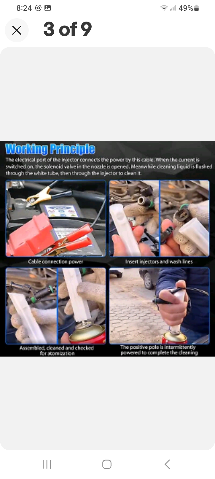

I use this to clean and check spray on injectors. I bought mine on ebay for 10.00 but you can find um on Amazon too
Screenshot_20230305_201938_Amazon Shopping.jpg Screenshot_20230305_202414_eBay.jpg Screenshot_20230305_202427_eBay.jpg
