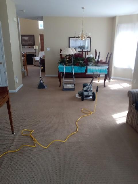

Vacuum
Prespray with Worx Sprayer and Carpet Details
Scrub with Brush Master Pro 35 14'' CRB
Extract with Trinity Odyssey
Groom

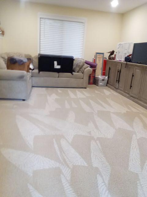

Vacuum
Prespray with Worx Sprayer and Silver Solution and Detonator (Peroxide)
Extract with Orbot Vibe TL and Cotton Bonnets
Groom with 10'' CRB
It's not the 1990's anymore
VLM WORKS !!!
