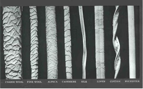

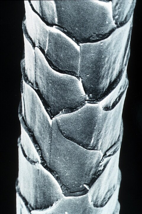

Actually, wool fibres have an overlapping scaly structure, kind of like roof shingles that prevents dry soil becoming attached and making vacuuming easier than synthetic fibres.
That goes against everything the ruggies were teaching back in the day... (Groseclose, Amirkhan, Ruth etc)
It was always an established fact that the "scaly" nature of the fiber holds more soil.
28,268
Look it up. The scaly nature of the wool cuticle prevents soil from attaching too deeply. Makes it easier to vacuum.
Think this through with the picture in mind.
How and why would it be easier to get soil off a strand of material that has scales as opposed to a plastic (synthetic) strand that is completely smooth.
I have dusted and pit washed thousands of rugs over 27 years....and I know it is not easier to get soil off protein fibers than synthetic fibers.
View attachment 133630 View attachment 133631
Through all the courses I have taken, I have always been told that wool released it's soil easier than synthetic. That's from certified iicrc instructors.
