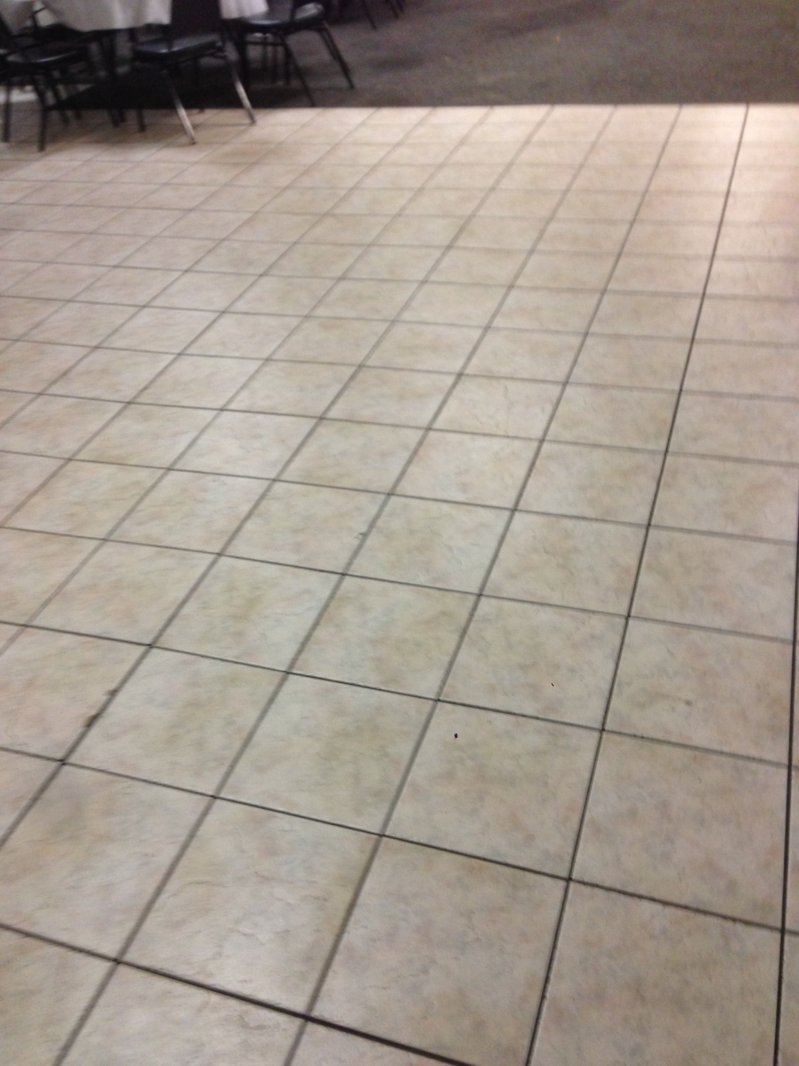

Hey Mikey would you use regular tile cleaner and a spinner on this marble tile?
50,008
Procyon, Power Max, Flex w/citrus, whatever is mixed up already.
Don't stress over it.

117,251
Cheap porcelain tile will look new.
Grout...who knows
Go alkaline and then acid..scrub both times
No miracles promised
