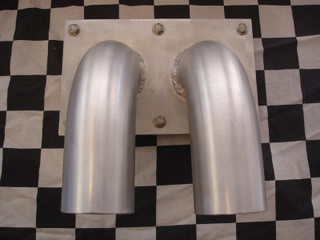

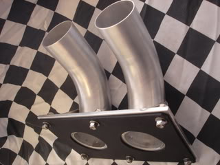

I been thinking of maybe.....a set of 4" drain pipes to the door. Pull 'em apart and stack 'em!
My son works at a machine shop. I'll have him make me an adaptor for the Genesis lid with a smooth bore elbow of SS welded to a plate that will mount over the existing openings.

Grennie,
You make one of those smooth bore elbow of SS welded to a plate that will mount over the existing openings for the El Diablo?
G
Greenie
Check it and see if the diablo is close to what we make....we currently make dual elbows that are 4" from center to center, and a set that is 4.5" center to center.
You gonna dual wand?

The green one says,
No dual wanding in my future. Was under the impression that having the curved vs 90 degree elbows makes for better vacuum efficiency. The 2" ports on top of the Diablo waste tank are 6.25" on centers. I use 2, 3' 2" leads Y'd to the 2.5".
