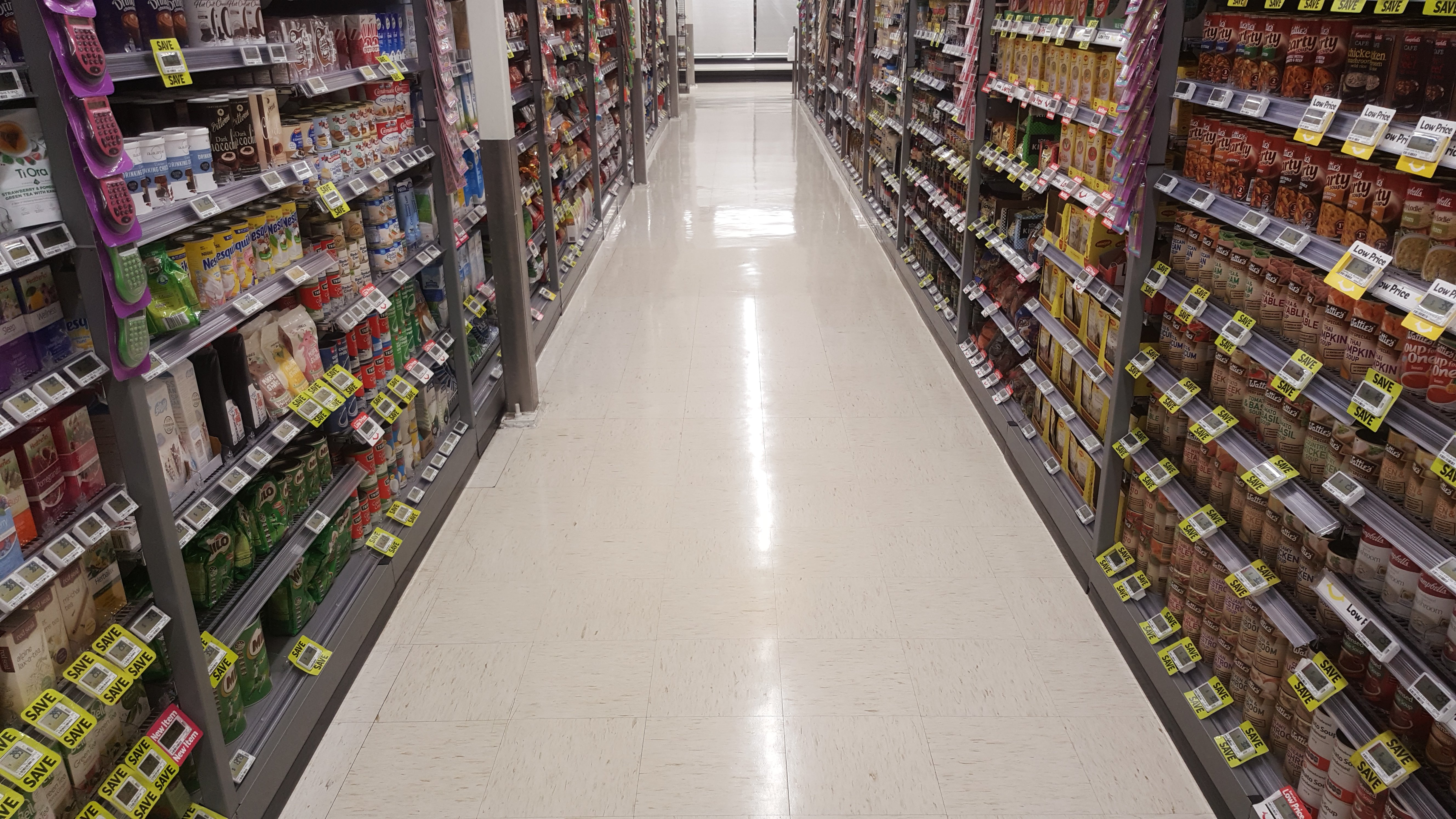

The dummies are using bleach.
Cheap bleach.
or they are using detergent constantly in the scrubber.
I run a cycle of detergent 1 night then 2 nights just water 20180519_204318.jpg

I dont see yellowing in the picture. If it's in specific places I'd say plasticized migration from rubber mats and such, but if its everywhere then I have no idea.
