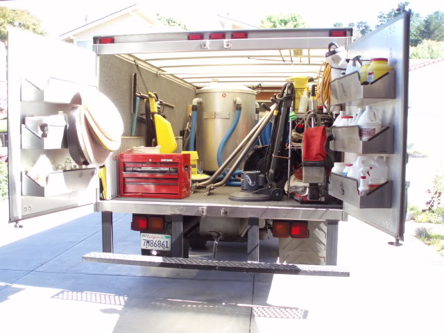

117,252
This is an old picture.
You can't see the Mop bucket, snail fan, AP, CX20, Defender, Tile tools, 60 bonnets, 4 tarps, steamer, 2 HF, Mytee Boss, GLS, Greenhorn, 2 PC hand tools, 5 floor brushes, emergency road kit, Multi, 400 of vac and 500 ft of pressure hose, 175 and much more.
You could not fit half of that in a Cargo without having to empty it all out to get to something in back.
