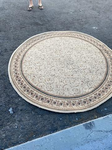

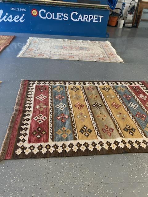

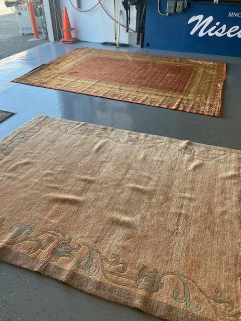

would you clean these in the home?
Cleaning Professional
117,380
red one in back is 100% Viscose
tan in front is wool...
all wool..
Olefin
demo rugs for the Vegas MF IICRC class...
OP and CRB/compound on all of them...

I think this is a hypothetical statement, so I'll break down the answer this way:
If the rugs aren't urine damaged, and you set the expectations, I've been impressed with the results from dry compound. Its messy, but safe. Not needed for the olefin one, but perhaps for the naturals.
And what if the customer said "you either do them in the home or I'll find someone else to do them?"
If they said that, and were showing an attitude of disrespect, I'd find another customer. People who dictate how a cleaner should do his/her job are rarely good ones to work with.

Taking a stupid chance cleaning all but the plastic one on site. Using dirt swirling to clean rugs will catch up to you. It's the ultimate hack move - you can't justify it by laughing all the way to the bank. It
The round one can be cleaned in the driveway. CRB and dirt swirling will actually take longer than extracting, so why not do a better job of cleaning?
If the customer says, "do it here or I'll call someone else" fine. I'll let someone else go out of business taking chances to save their customer a few dollars.
I'll respectfully disagree on the effectiveness of dry compound Jim. Host dry compound is only very marginally effective, and typically works best on grass rugs where a lot of CRB abrasion can be used. Capture will temporarily make a rug look better and then will actually create a sticky nightmare. You want a happy customer and get paid for your work, so if your choices are dry compound or don't do it, my feeling is don't do it.

As long as there's no urine I would HWE all day long. Procyon on the wool after testing for bleeding on the reds of course, using low pressure.

Hit them all but the olefin with Picrin. Dry right away with no bleeding or other issues.

No dry compound. Never. Unless Sisal. Minus urine or dank dog, in home definitely. Hands and knees with SS Upholstery tool.

The viscose would be taken and brought back from a rug washing facility by yours truly
as for the wool...grow some balls guys.Just do a cold water topical in house with a neutral to mildly acidic cleaner and quick dry
