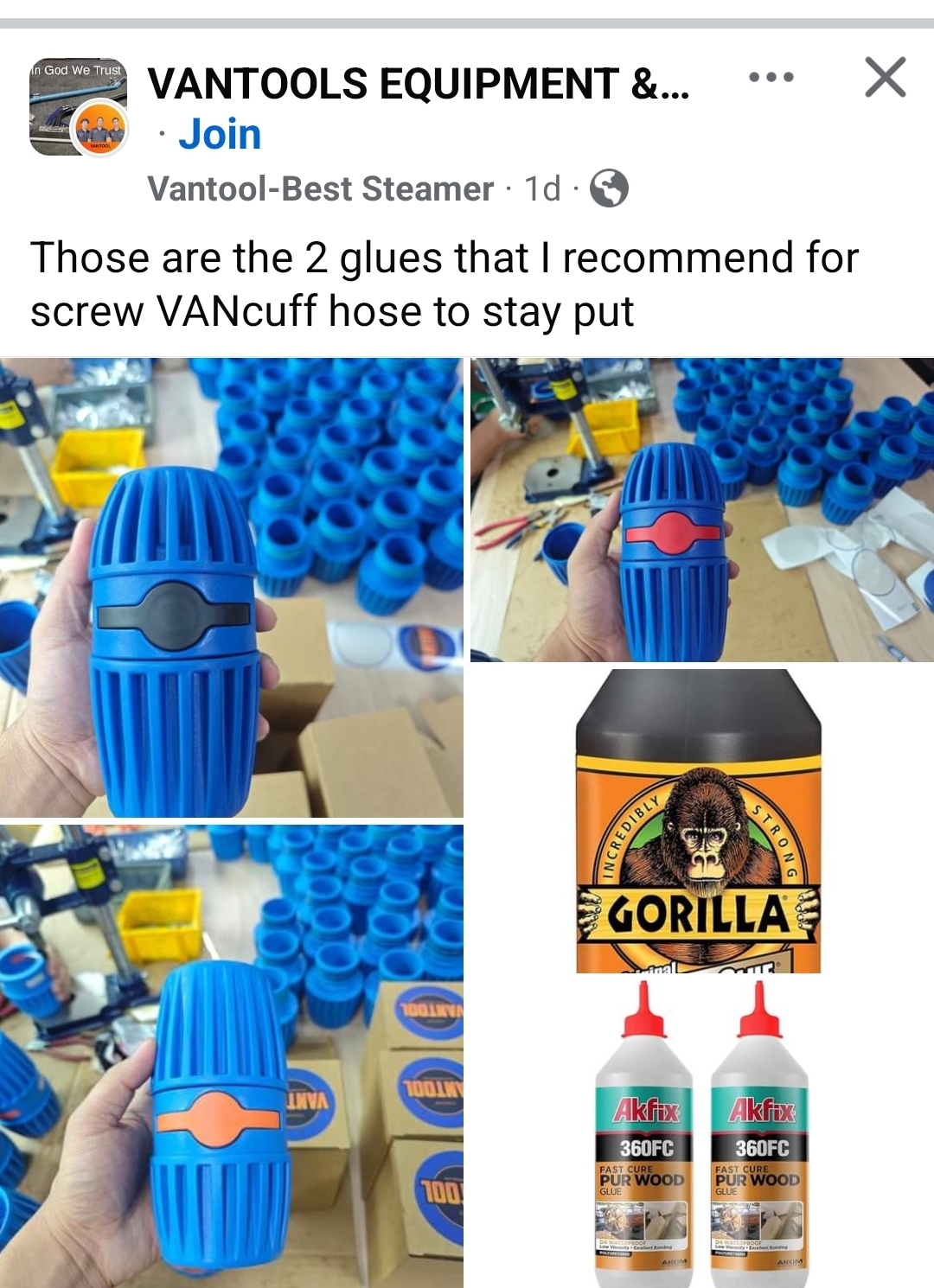

Am I missing something here? Why are they recommending wood glue?

Don’t glue them….
Use teflon pipe tape, the wide stuff, and go around numerous times around the hose end. BEFORE you thread your cuff on. It creates an excellent air tight seal.
That way, it you do ever have to remove or replace a cuff, you haven’t ruined it….

Let's not skip over a copy of Flashcuffs.. Is there a patent for this?
