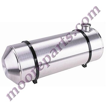

Judson are you Crazy? 18-20'! Mike do NOT get that big of Trailer you will freak right the f*CK OUT.(Remember where he lives) Yes you want an Dual Axle with Breaks but a 7x12 or 8x14 is more trailer then you will ever need. Heck a 6x10 will even work. Ramp doors can be nice but you have to ask yourself if the extra expense is worth it
Mounting the tanks on the tongue is the way we do it here. We use Spun Aluminum tanks. A little welding and they mount up easy.

Shawn Forsythe said:
Putting the kero tank inside is something I wouldn't see a problem with, but I don't know I would want to put the Gasoline tank inside. First, the logistics in filling a gas tank on the inside is dubious at best. But the bigger problem is gas fume venting. Most every fuel tank is vented to prevent pressure build-up due to temp variances.
I would use a marine tank securely mounted to the tongue.
Marine Tank? These are what we use

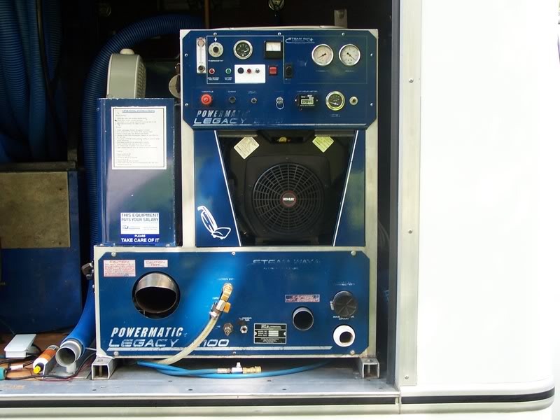

My box truck is a 6 x 10. I have my Powermatic, reels, shelves, really all kinds of things in there.
For many years I used the marine tanks that come with the Powermatic for both gas and kerosene. My son in law still uses this system inside his truck.

Mike buy the machine! They are very heavy 900 lbs. Instead of a trailer go with an extended van.
Mine is mounted at the side for more room in the back.
