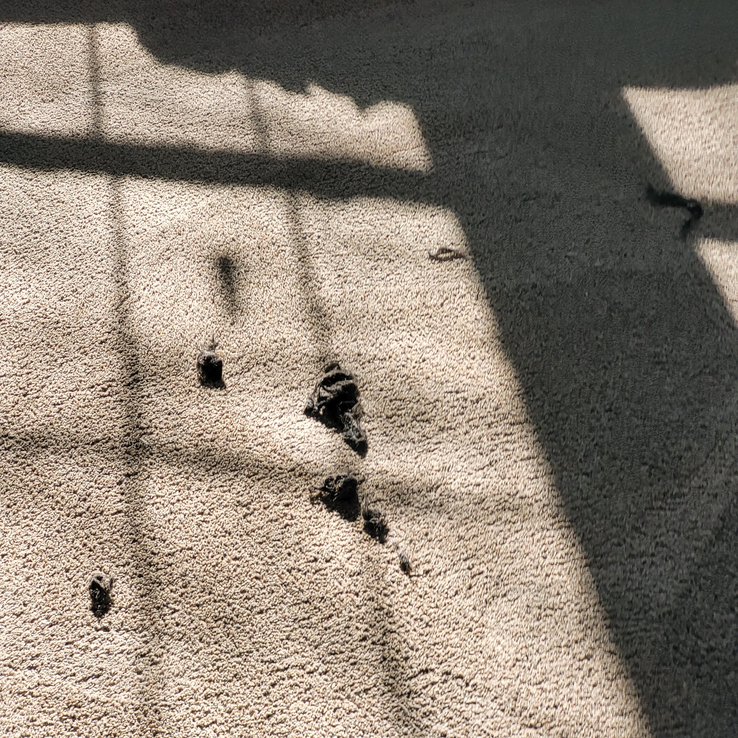

This is old, hahaha but customer tend to work on diarrhea themselves.
They usually start my wetting and using a do it yourself machine spotter.
They end up sinking it I to the padding and the stain comes back up wicking.
Then they call you the next day and it's still wet.
Best to wait a few days so the wicking stops before attempting to remove.
I tell people scrap excess and sprinkle baking powder.
The baking powder will absorb and stop the sinking stinking.
Then work on it after it's dry.
