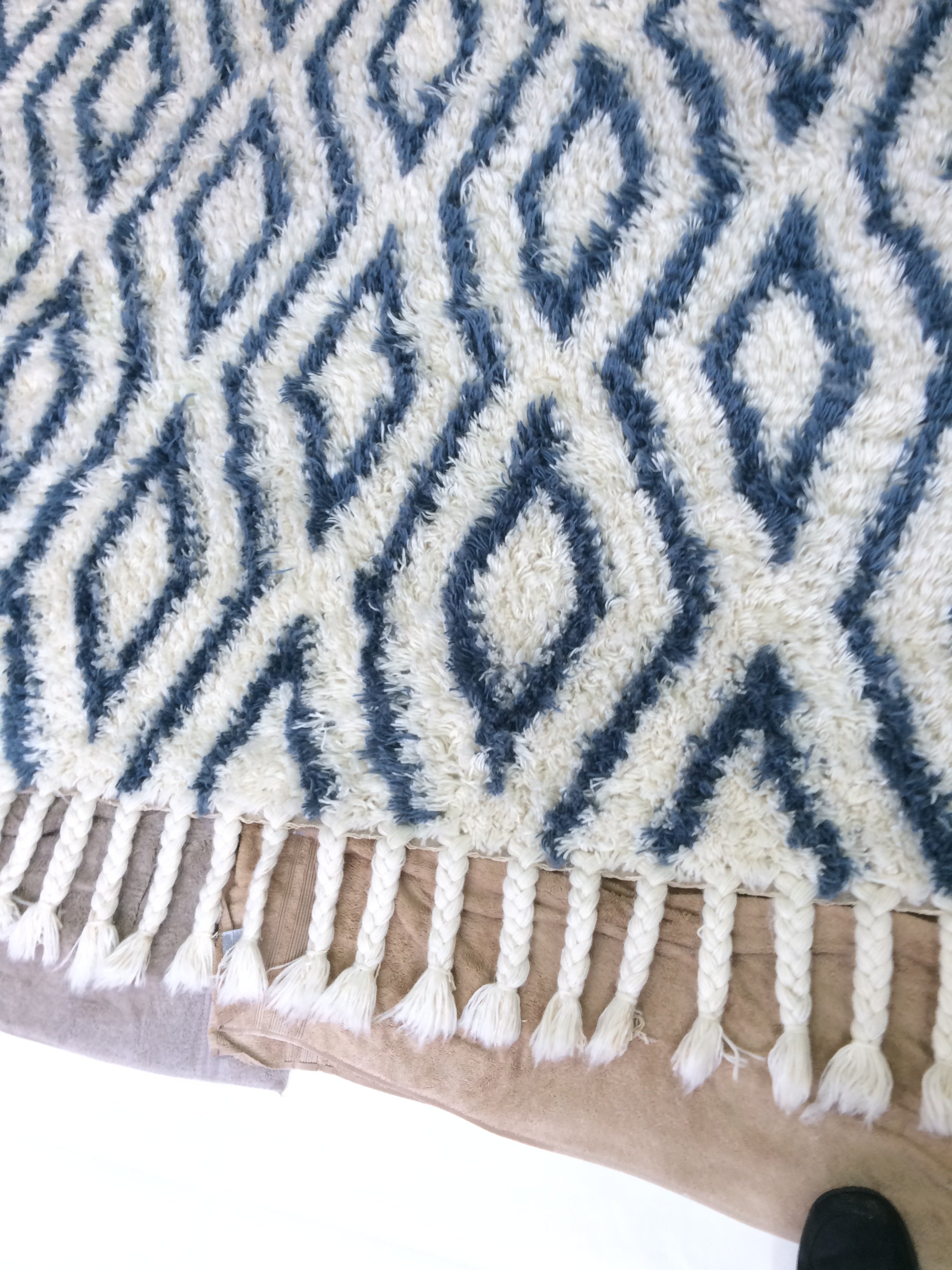

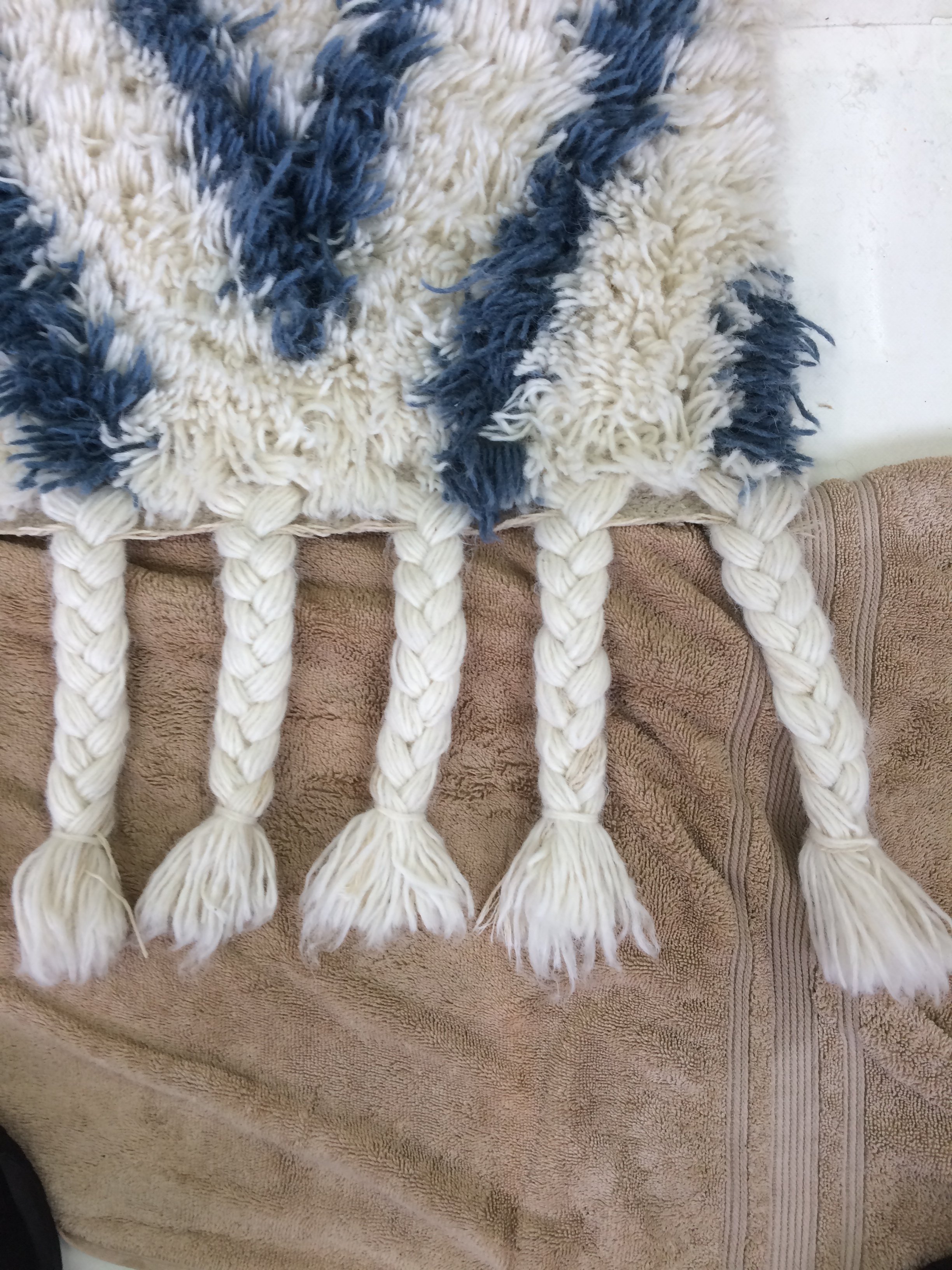

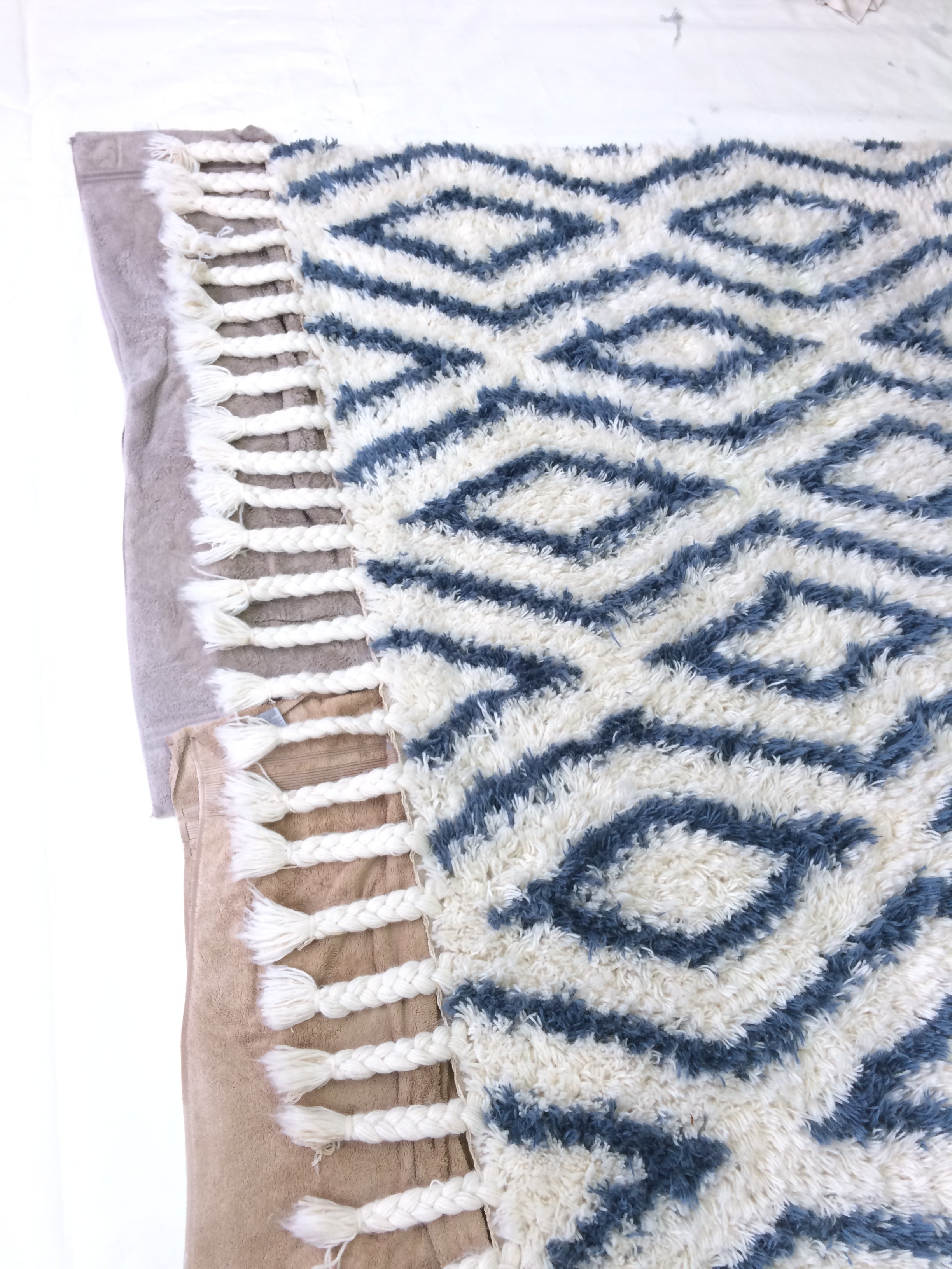

I was at the shop today prepping for my big overnight job tonight . I decided to process a couple of rugs as well. This rug was a bit of a pain in the butt. The braids are 10” long, and had to be cleaned(carefully) by hand.
Why do people buy crap like this? It was 100% wool, and very dirty, both on the top, and back.....
