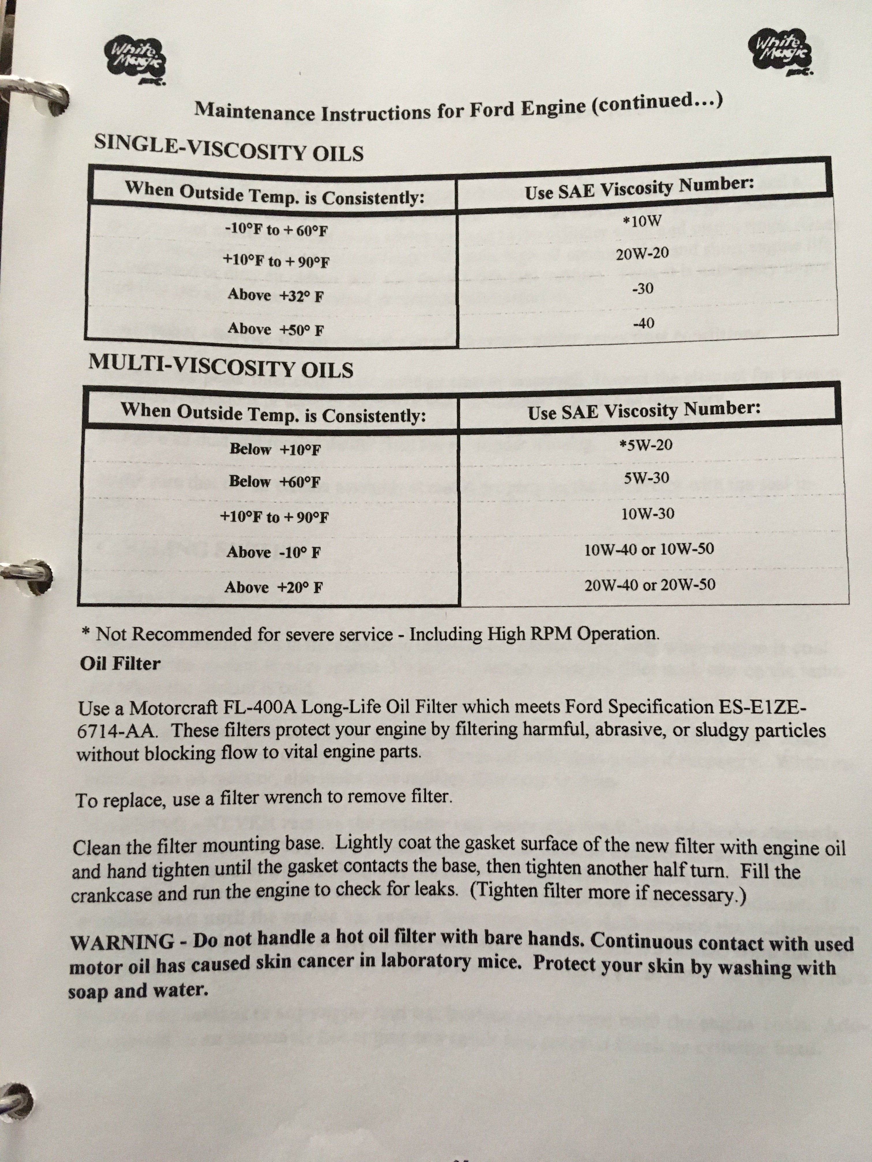

I couldnt find anything on the manual about the spark plugs but heres what it says about oil and filter... IMG_0383.JPG

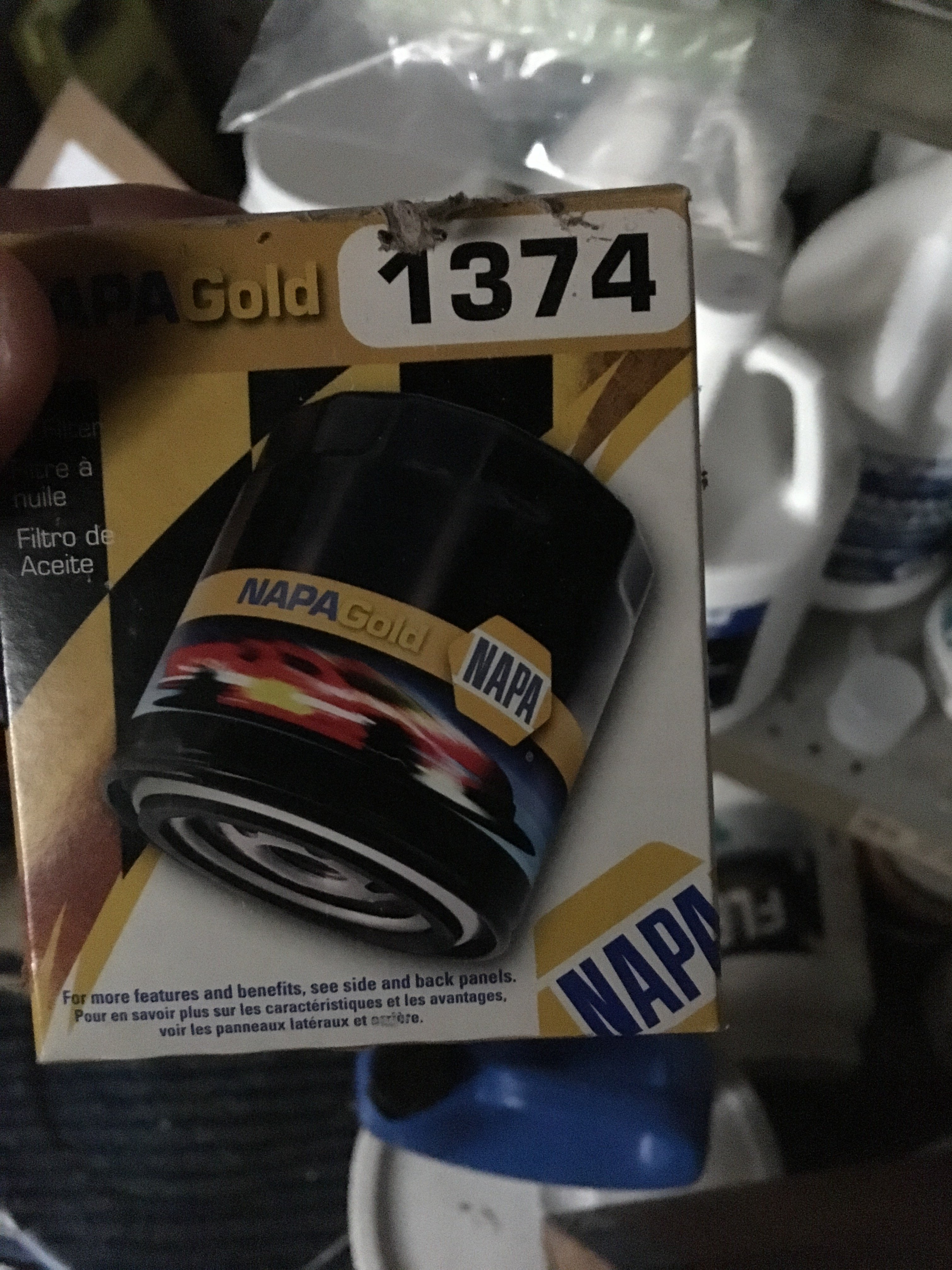

Ive been running this filter...
