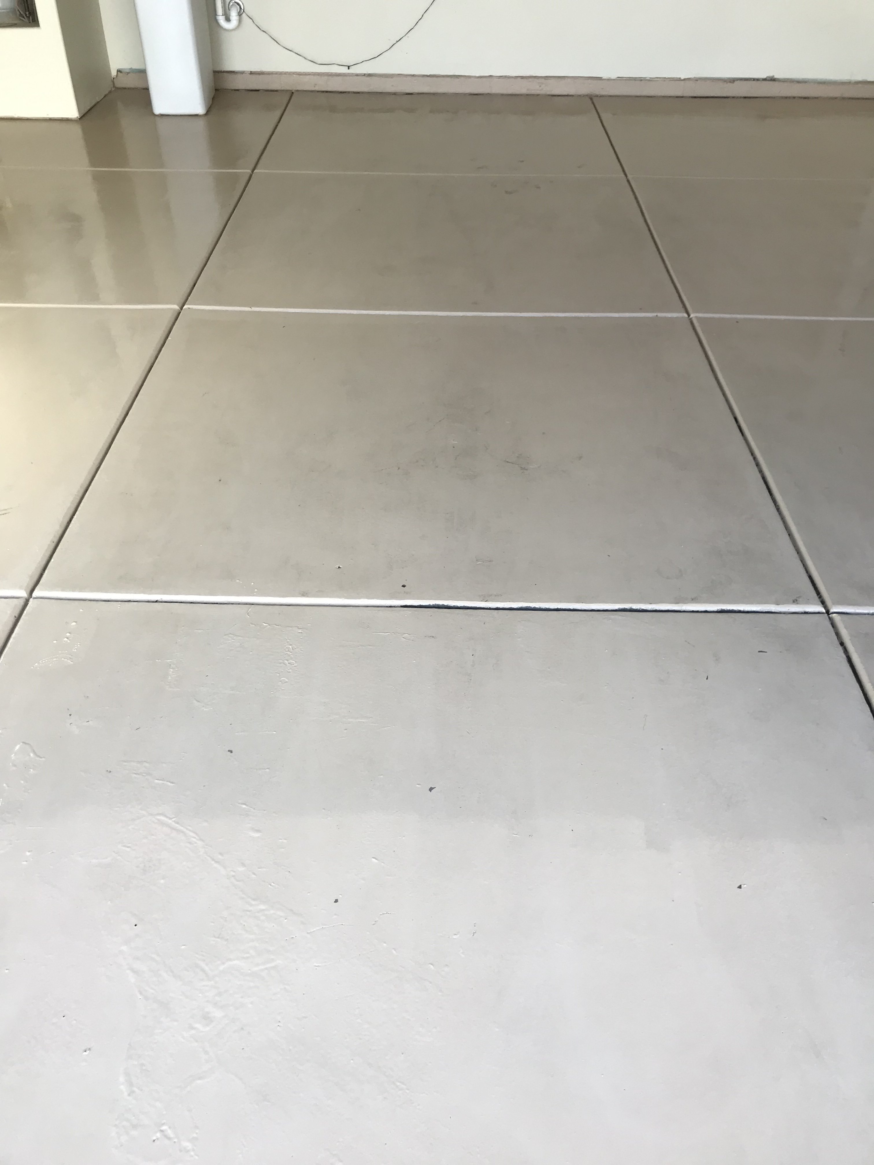

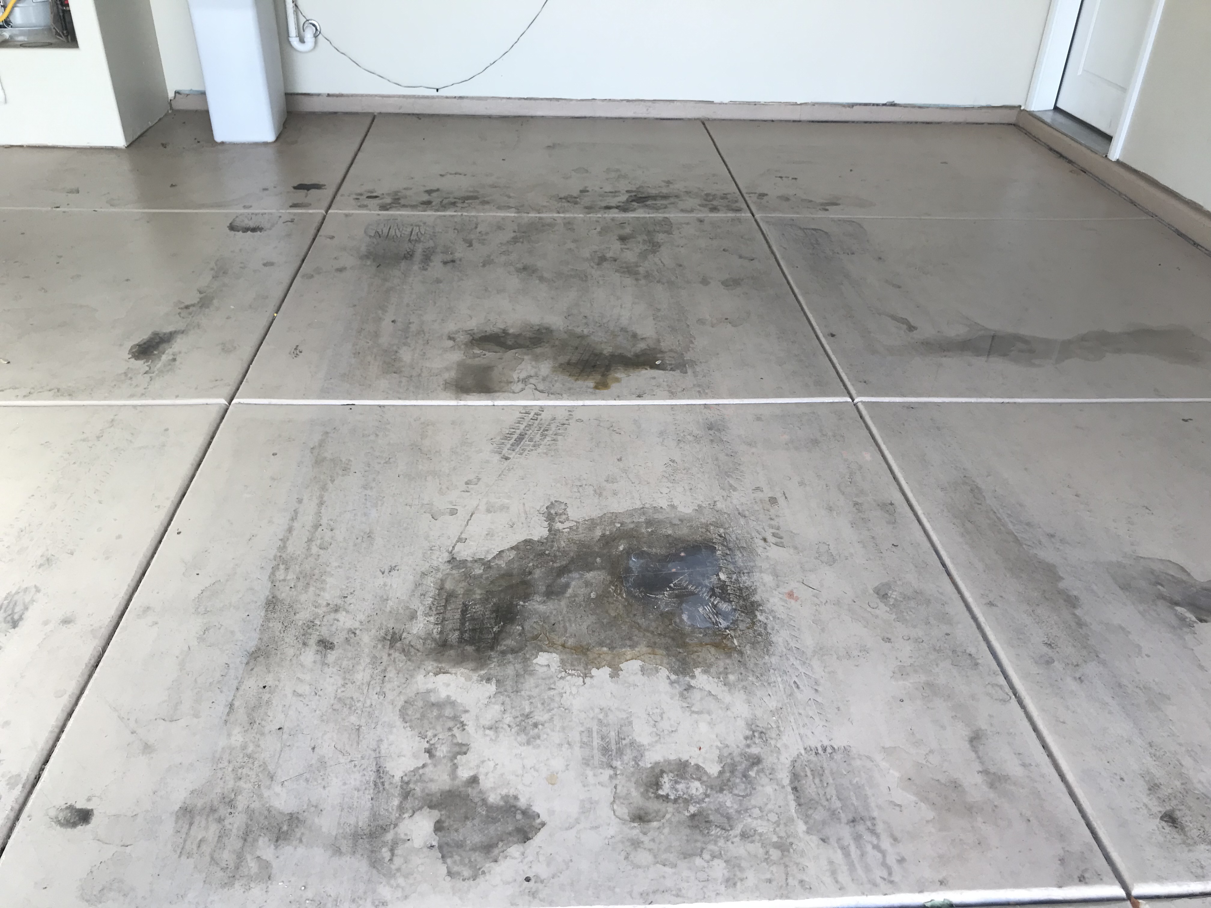

I add it every once in awhile on nasty polys. I boosted my prespray with citrus yesterday for this garage too.
