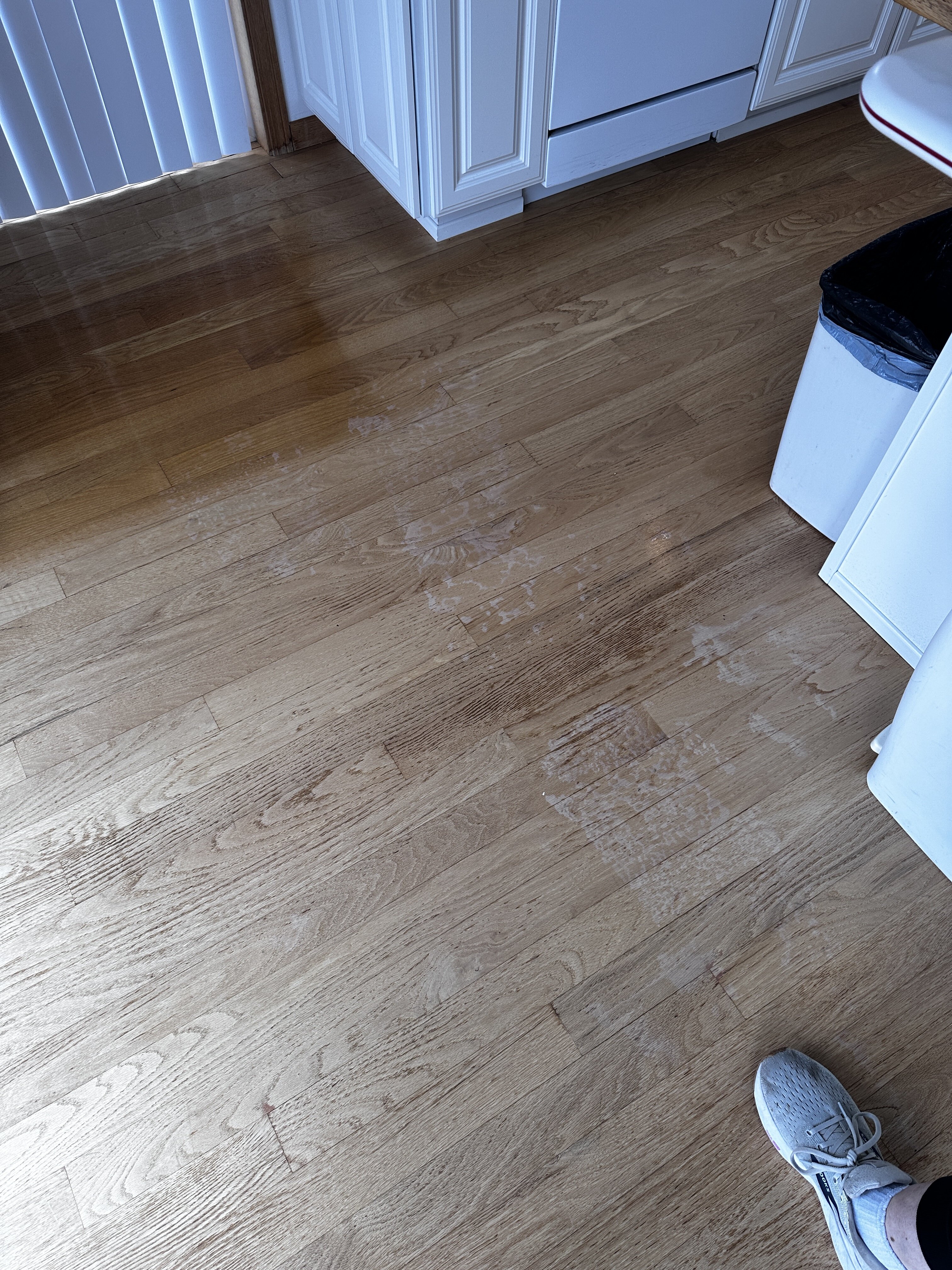

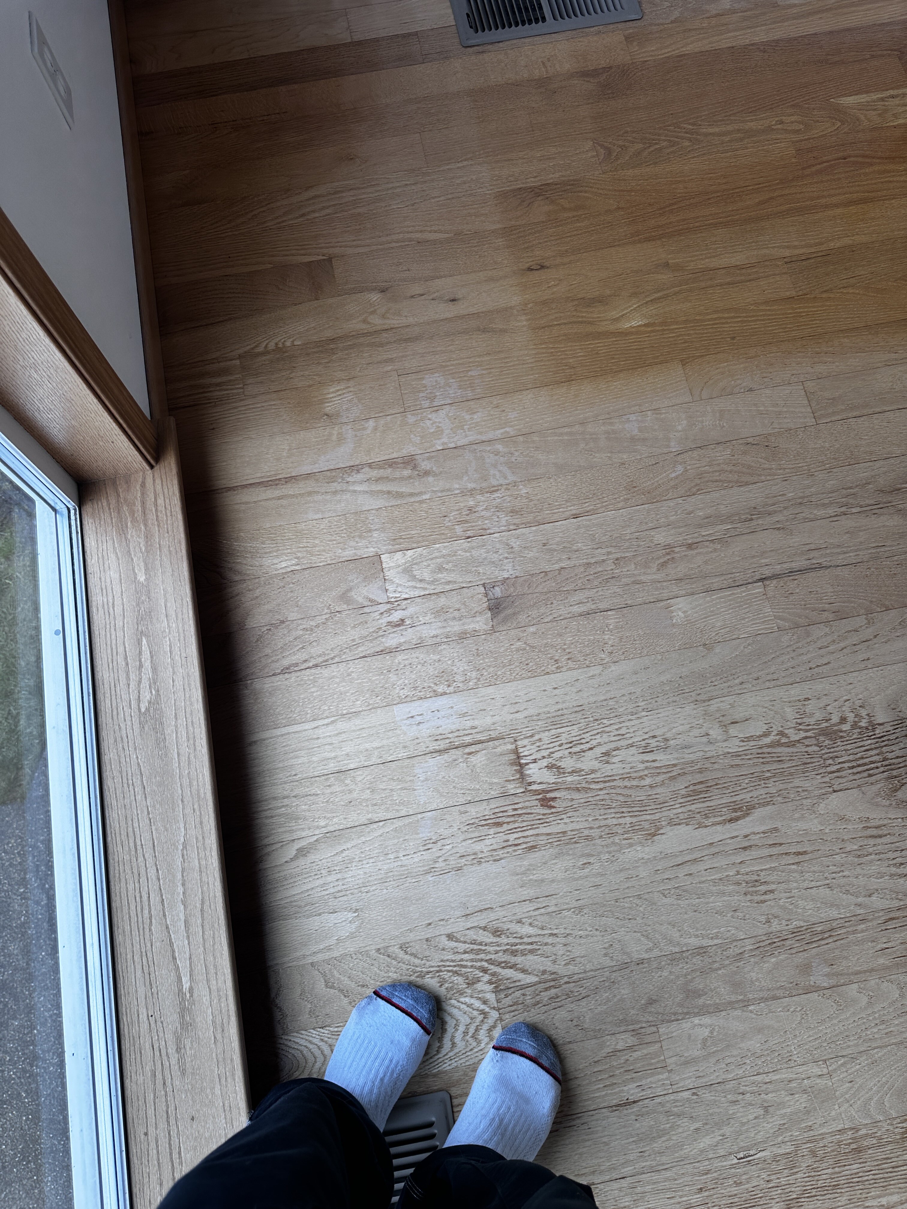

Got a call today from a cleaner who just bought one of my multi-surface wands..
He cleaned a wood floor…
and ended up with white blotchy spots all over it.
After a few questions, here’s what we had:
No prespray
No agitation
Straight wanding with high heat (Everest 870)
Hooked to customer’s hard water
No softener
No idea what had been used on the floor before
And the key detail…
The spots felt sticky as they dried.
What Happened
This floor had a topical coating buildup (Mop & Glo, Rejuvenate, etc.).
He hit it with:
high heat
plain water
no chemistry
no agitation
So instead of cleaning it…
He partially melted and redistributed the coating,
and it dried back as white haze and blotching.
