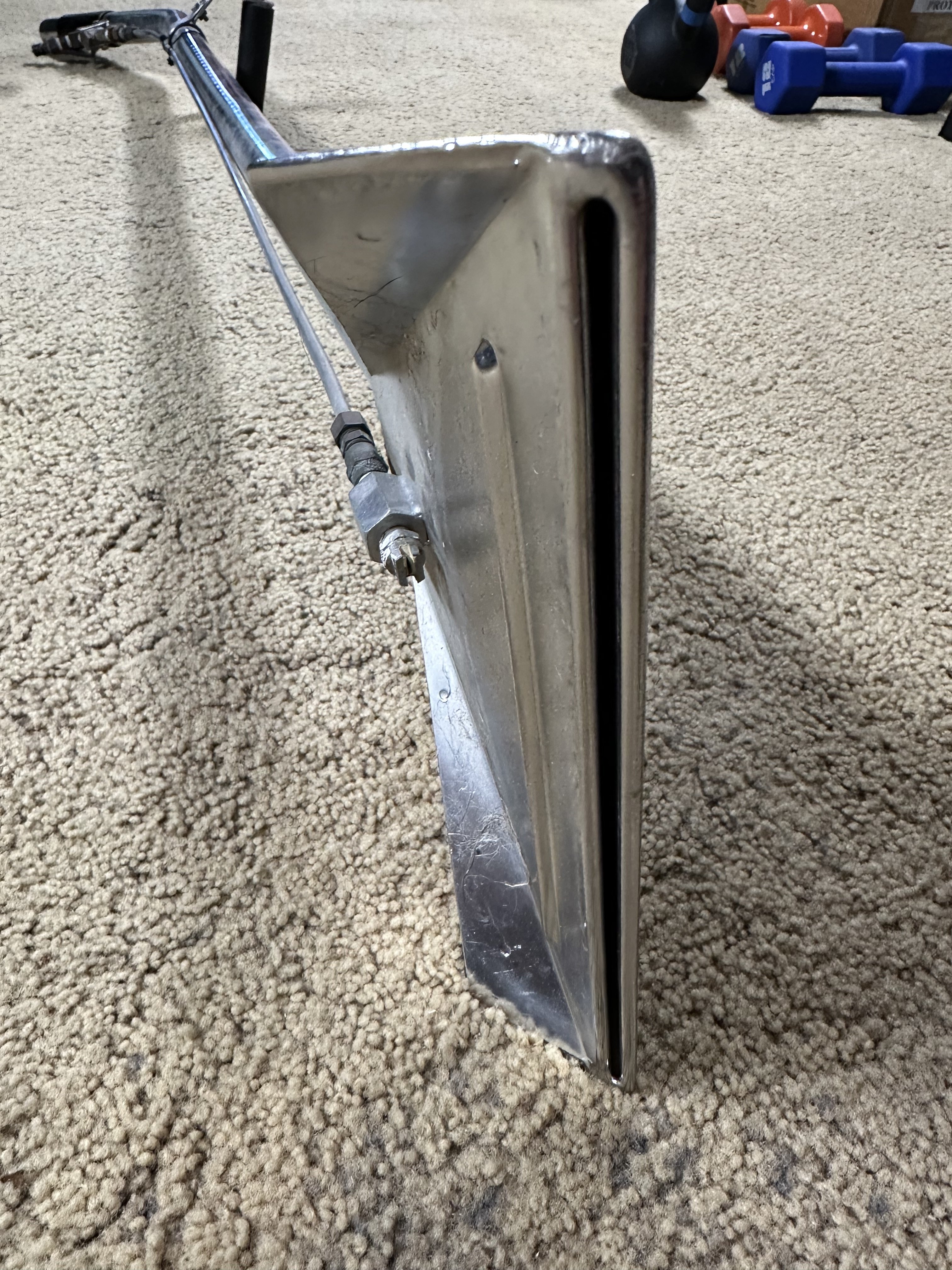

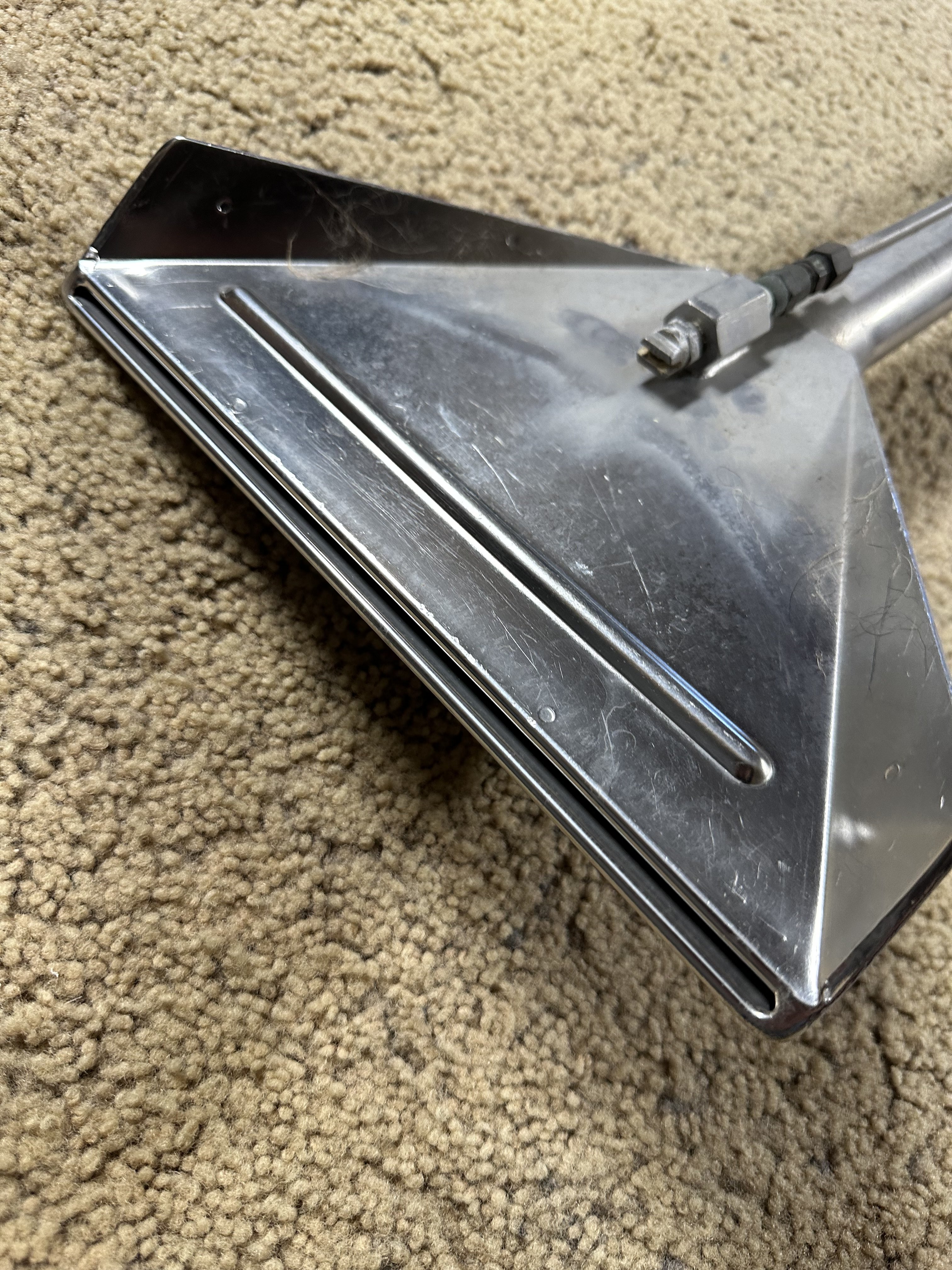

I have a 10 inch wand I bought from Brevick like 25 years ago. He claimed it was a Prochem wand. It has no lips on it like a Hydra Hoe but the single tip is very close to the carpet and is very easy to move on all types of carpet. I used it to clean wool rugs. If you mean new wands, disregard my response.

A Conway/Dang, FMT or Joe wand will have flat 1/4' aluminum exposed=unusable
A PMF wand that has the REMOVABLE lips taken off will have rough 1.44mm sheet metal exposed+unusable unless you want to pull only in an effort to fluff up matted poly
A Glideless Westpack will all have rounded/folded fully usable steel or titanium exposed
A EVO will have a 1.5" flat aluminum block=unusable
A SharpShooter will have a mess plastic blob block= unusable

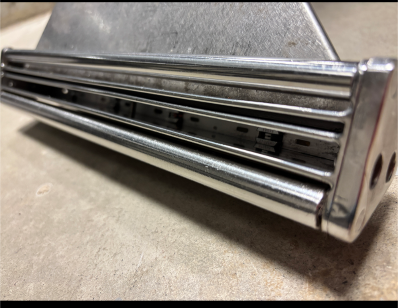

An (retired) Prochem Quad or Ti will have cast (huge) lips that are usable
I could go on but the only choice in a new wand with the option you're looking for are Westpaks, which is what I told you when you brought this (stupid) idea up with me on the phone
