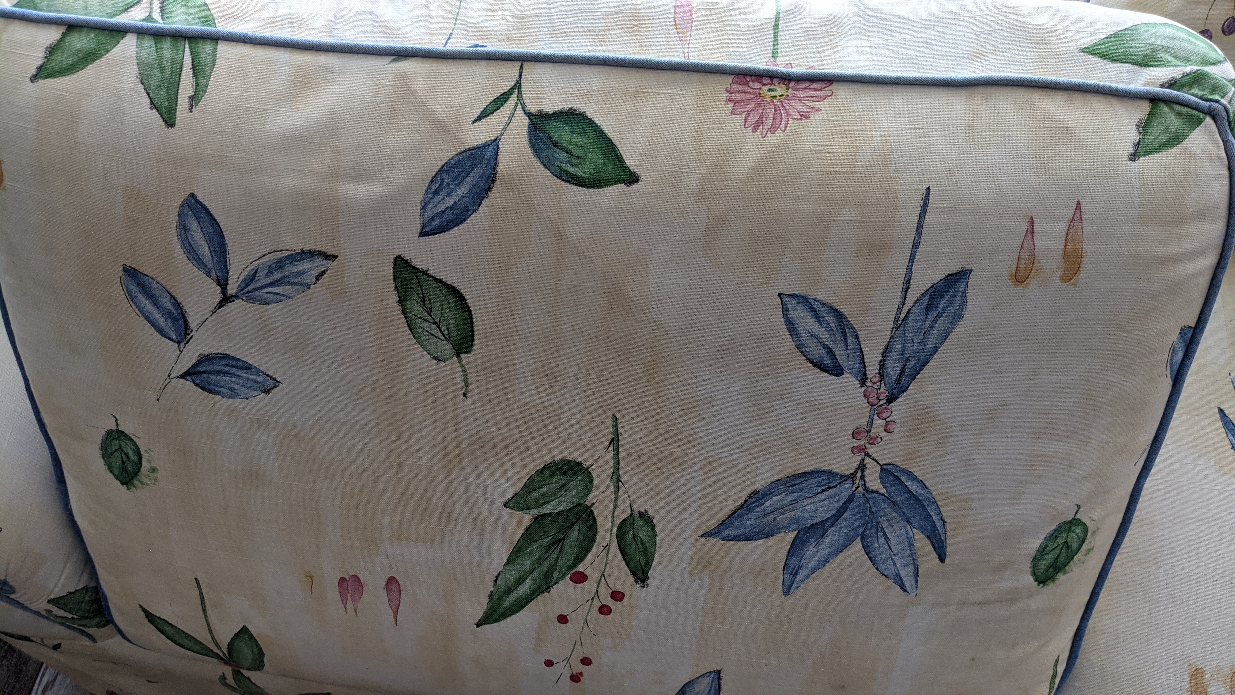

What the hell is going on here Jim?
116,391
15 years old
Cotton
Polyfill no feathers
Never been cleaned
Does not live in front of a TV set...
12,673

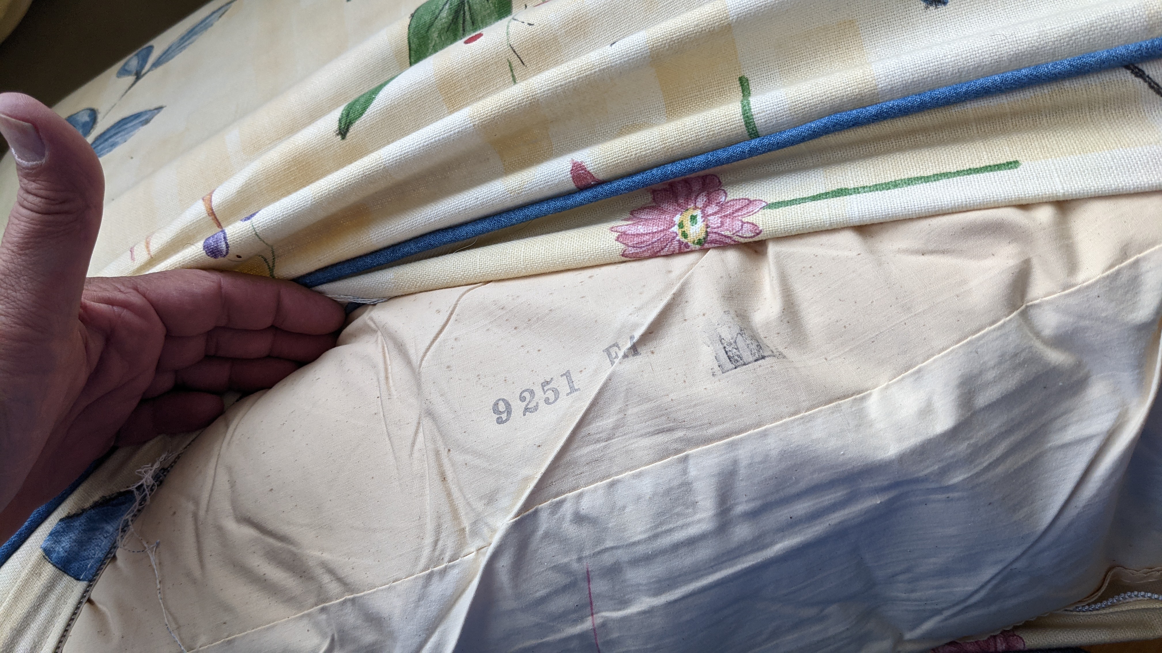

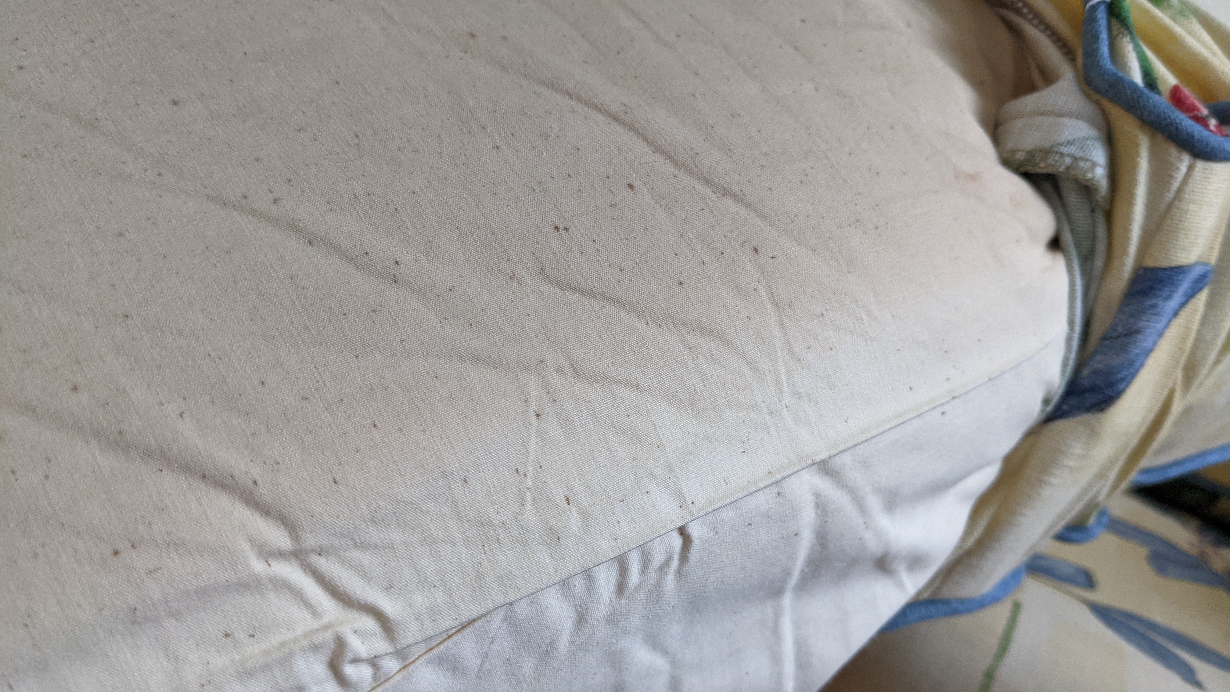

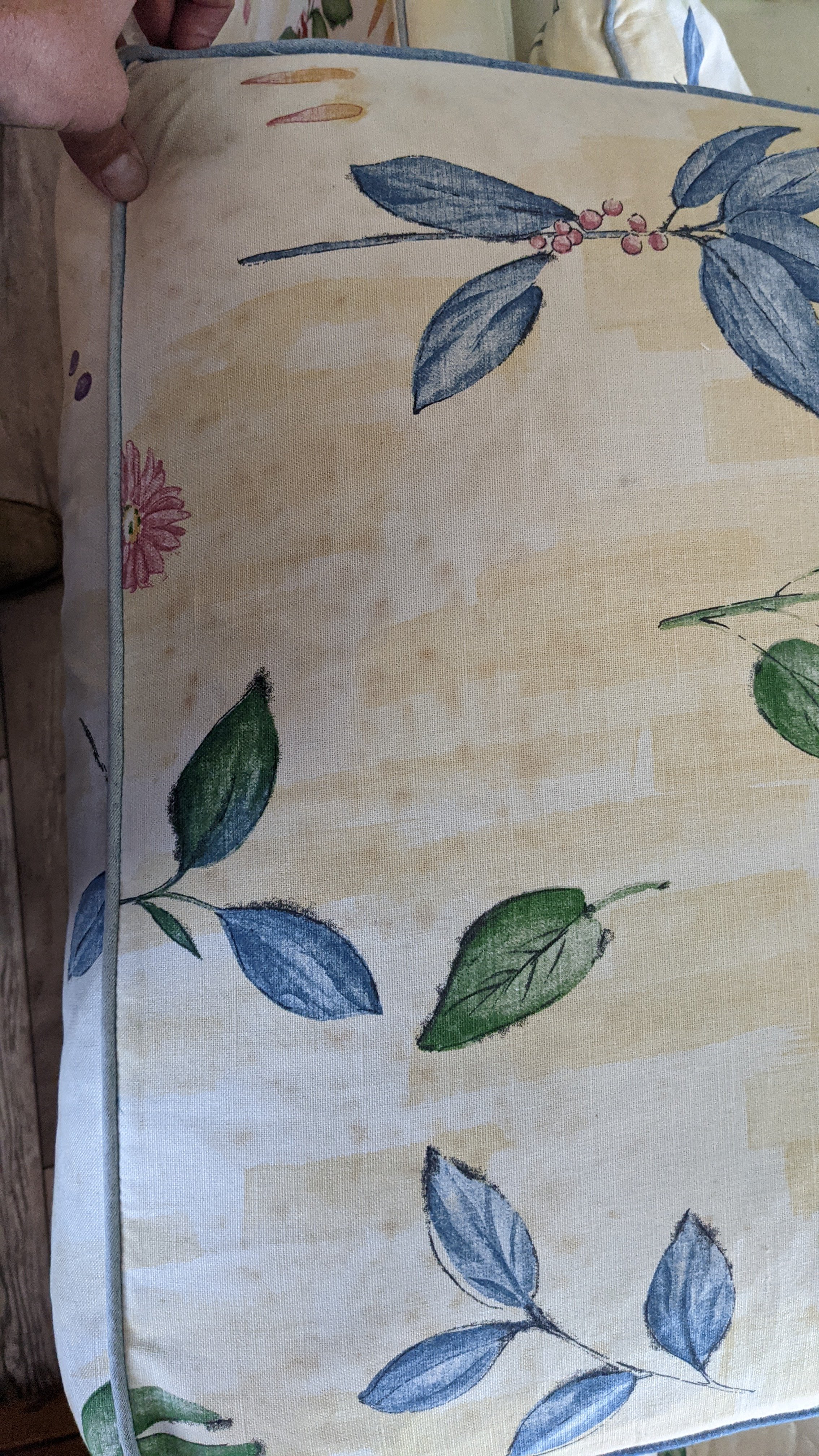

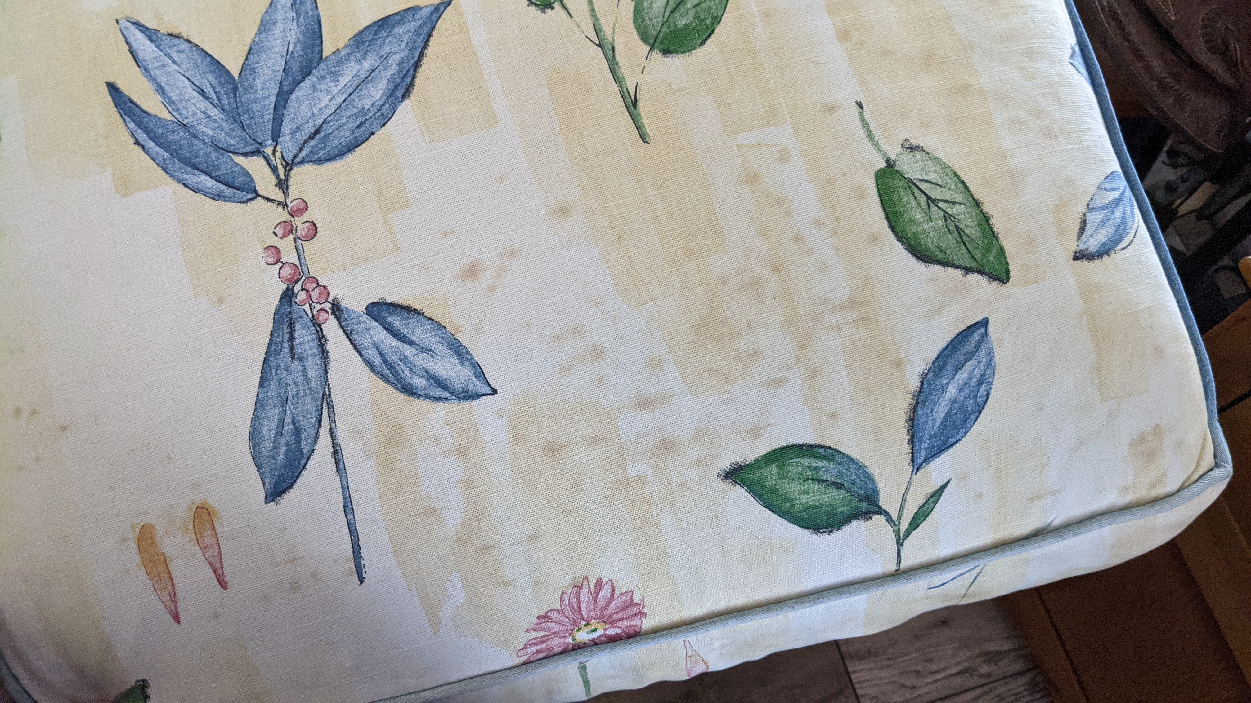

The spots have the appearance of flame resistant treatments, and both upholsterers and manufacturers have been known to use flame retardent ticking even if not required.
But those long parallel brown streaks scream "somebody tried to clean it".
So one or the other or both.
You were, of course, wise to not do it.
24,126
Redding
fire retardant treatment is my guess. Like Fred said, I first thought it was Haitian cotton seeds but if it's poly, then I would go with the retardant, especially if its from the 80's or 90's

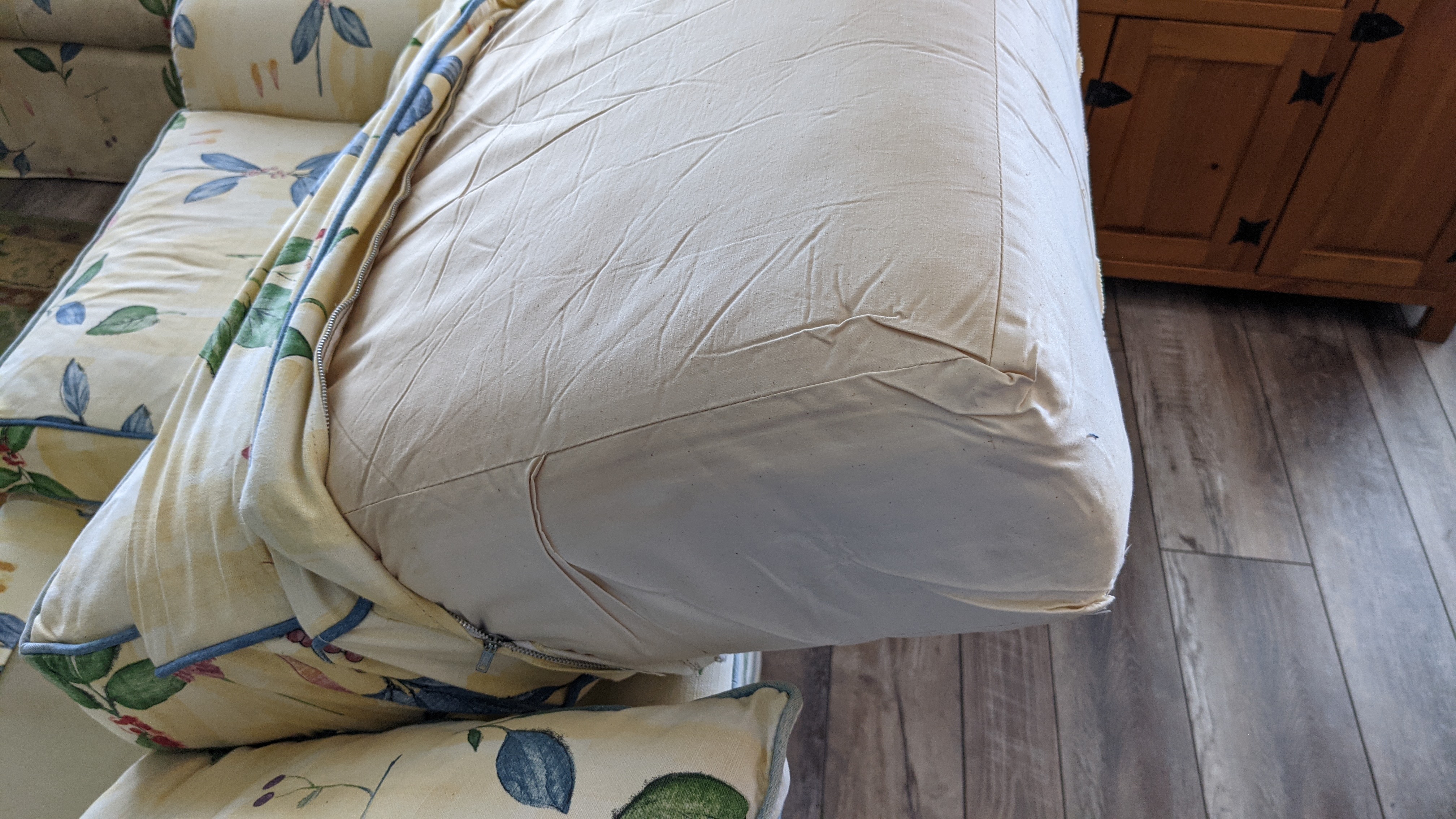

I having the same issues. It didnt happen on the cushions, which i test cleaned 1st. But the frame is having those same spots what wick up.
Im thinking its unfinished cotton in the padding and its the seeds- or the cotton was fire retarded-- but the fabric is poly.
14,253
Was it just in the cushions of the couch or did the body have the same damage as well?
