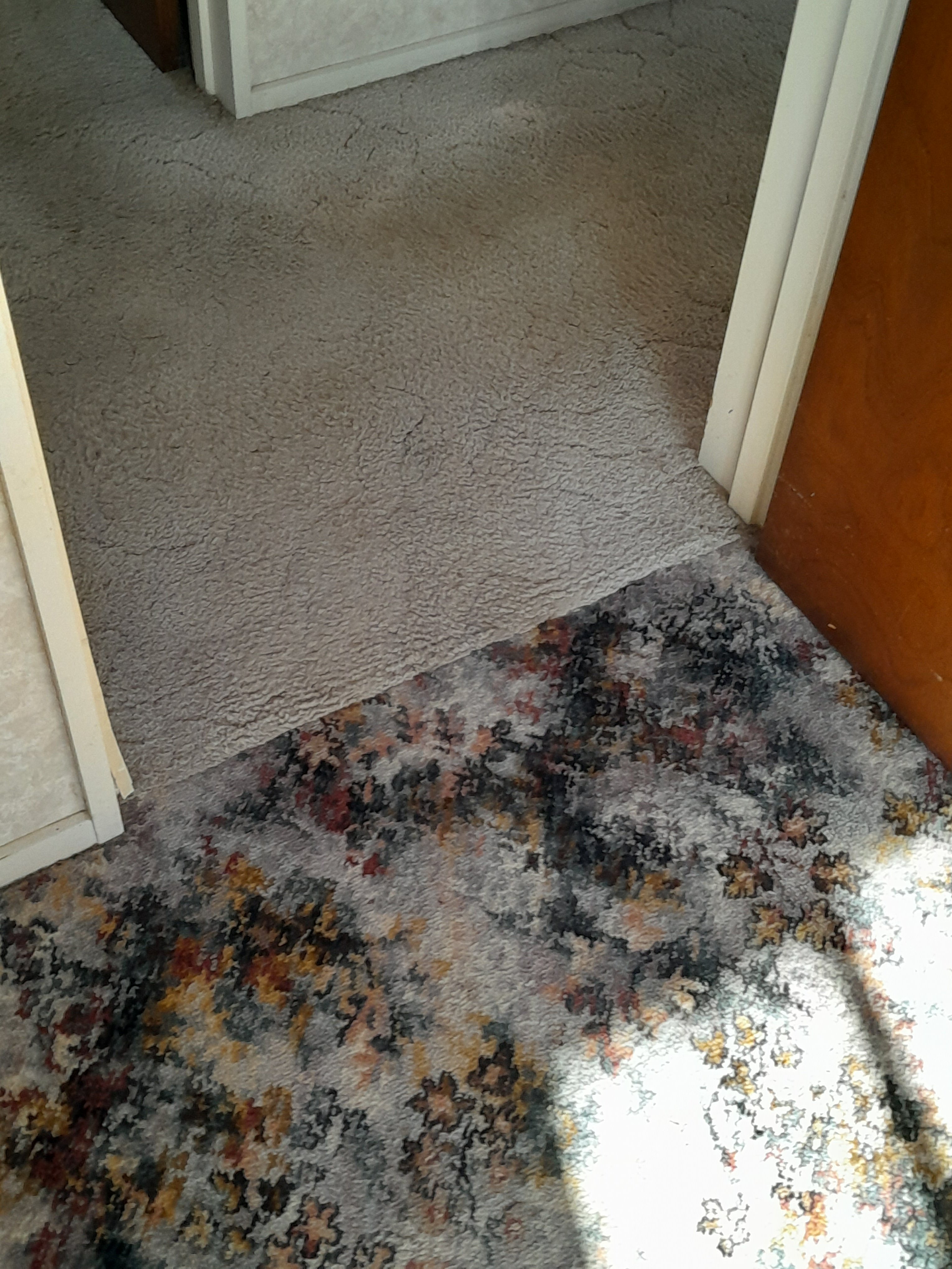

14,627
Poly gives its image almost immediately after the first year by showing the matted down look (crushed fibers)
And nylon is good at showing pile distortion (wavy look of pile laying another direction)
And wool is so expensive, the customer will tell you before you step on it. Lol

Nylon doesn't have reverse Nap or pooling like polys, and is crush resistant
14,627
I agree with nylon being crush resistant. But I've seen the pile reversal several times on older nylon heavy carpets
It happens, but polys are notoriously bad
