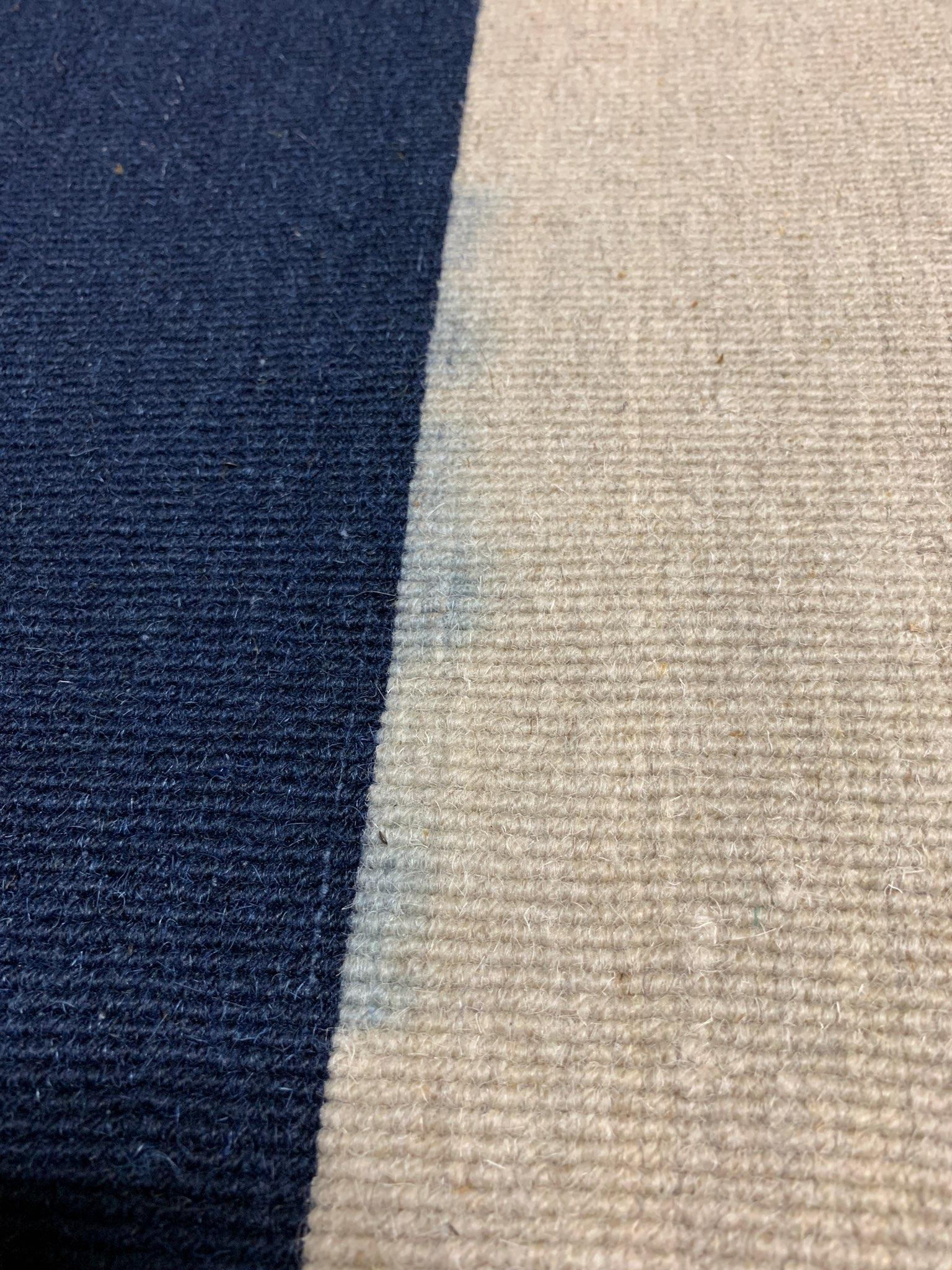

well, my adventurous rug hacks finally got bit...
116,392
Top cleaned with Chemsepc One Earth, dried flat...
Suggestions besides sending to Lisa Wagner?
27,967

I believe it's in an isolated area and only showing on one side..
Are there a few things my guys can try before moving on that won't cause more damage?
