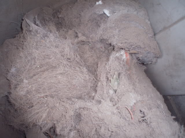

We let the customer pre vac.
116,391
yeah that's a great idea. :roll:
I absolutely hate that excuse for low priced induced laziness.
This ladies carpet "looked" fine. Stanley or Snow would have jumped right into it with both jets a soaking.
Us?
We new better and filled our Bissell and Sanitaire 6 TIMES!!
lr dr mbr and 2 set or steps.
and 4 dogs.

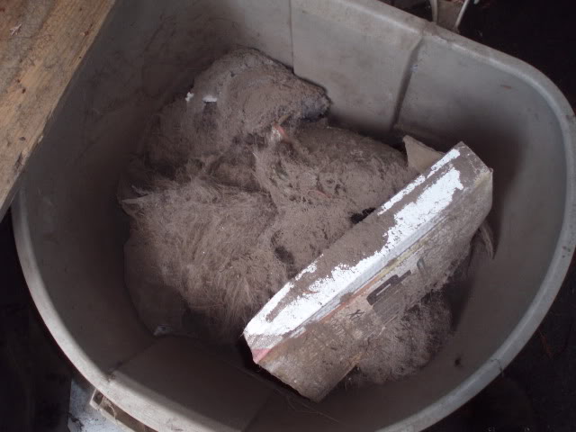

We did a 12x15 area and filled the dirt cup up twice honestly it didn’t look that bad …I think we may have “Ron’d it”……… spent more time vacuuming it than extracting. It sure impressed the hell out of the client seeing the dirt cup fill up.
