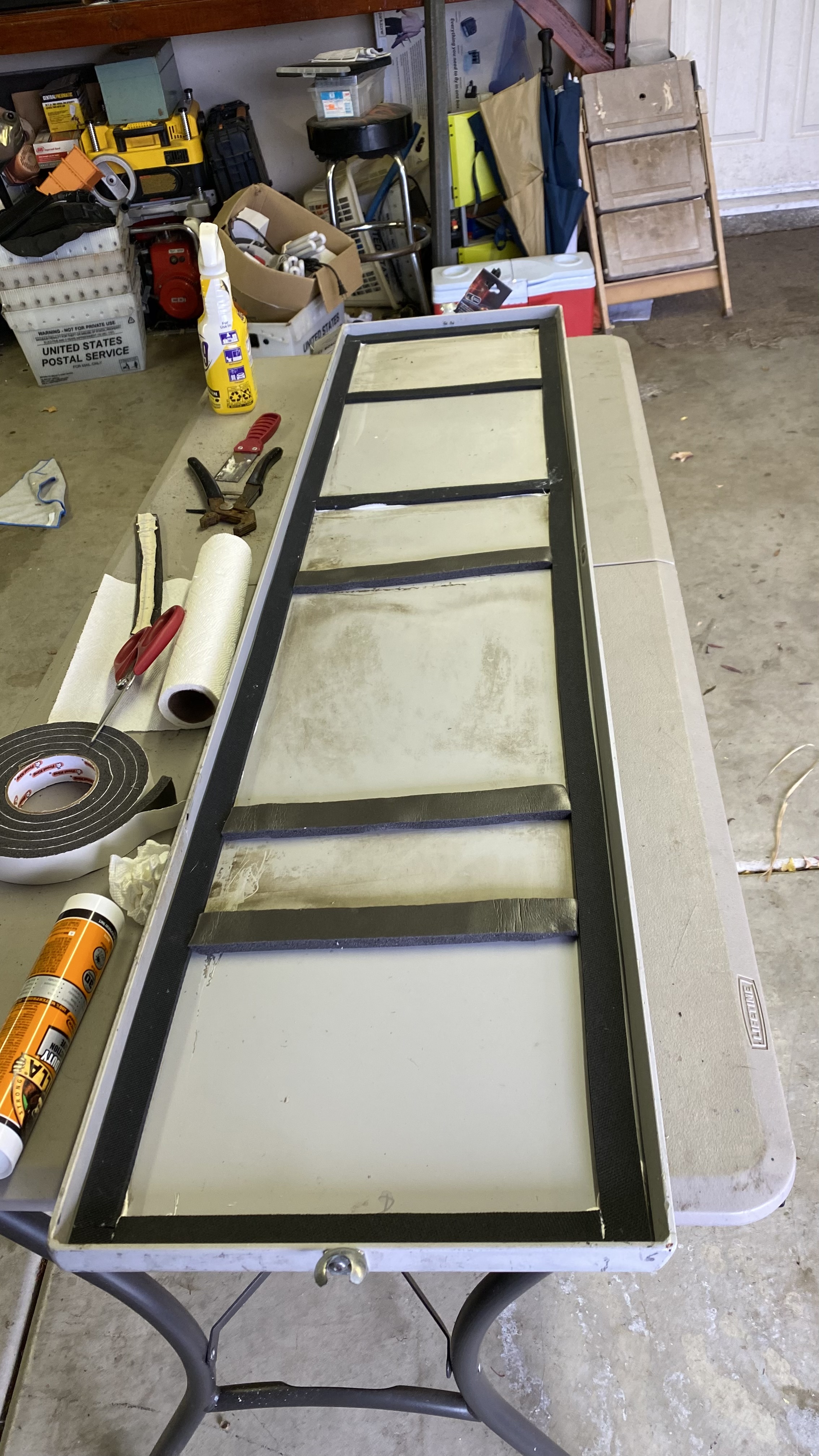

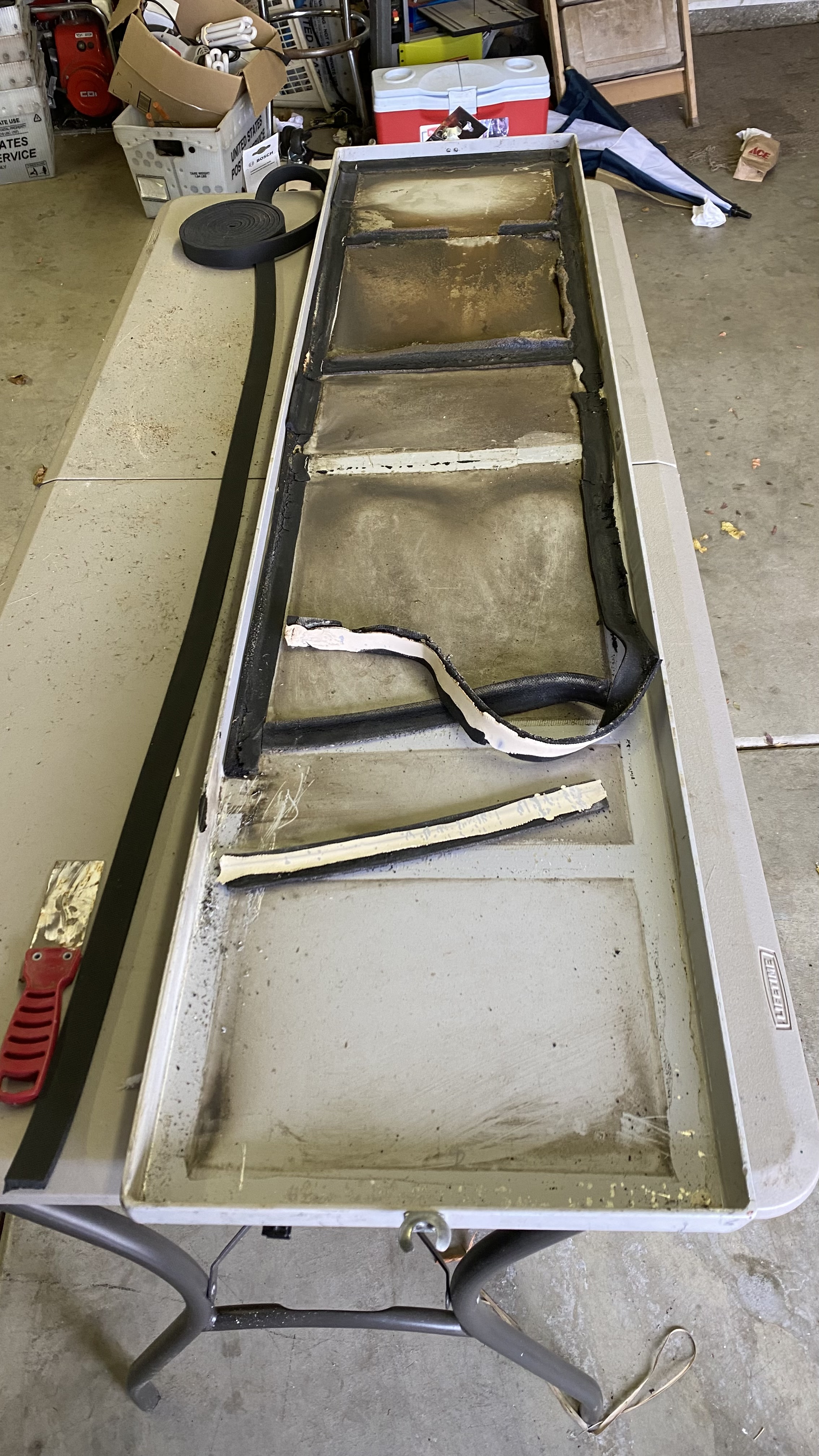

Replaced the seals on my tank lid. I noticed that suction was getting pretty nimble. It's time for a new seal. I was able to replace it with the real deal type seal that Prochem uses. I was three feet short so I temporarily used Ace Hardware weather stripping until my remaining three feet get delivered. The last time I replaced the seal I used the hardware store stripping. when I went to remove it this time it was a slurpy mess. It worked okay, but did not last as long as the real stuff.
If you guys need the real deal, here is where I found mine.
View attachment 120116View attachment 120115
