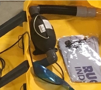

Does anyone know what the brand and model of the 80 gpm pump used in "the marinator" is? I'm building my own rug wash tub system. Built my own rug rack. That was fun!

never seen one in person
but
it looks like a calpumps (or similar) torpedo pump....maybe a T4000 (based on looks, inlet/outlet size, and flow rate)....but again this is just a guess
edit: looking at the vids it might be the T7500/T10000 which have the larger 3" ports
