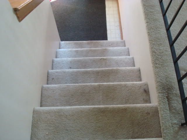

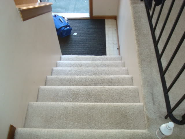

breathe72
A rental job.

Chris, Stairs look good.
If you take a bottle with 40% (your fav encap) and 60% water a quick spray and brush on the edges will clean those filtration lines right up.
117,240
Did you pre vac those things?
Maybe its the lighting but to my eyes it looks like they'll wick.
S
Scott Rogers
Hey Mikey, there is some pretty substantial fiber damage there. I was thinking it was probably that and lighting giving it that look.
Pictures can be pretty deceiving compared to the actual finished job.

Greenie said:
Is that vinyl on top of that carpet at the bottom of the stairs?
Its one of those cheap runners Greenie.
I pre-vacced AND pre-scrubbed these, lol.
This place was so disgusting, I had to.
If you think the stairs cleaned up like shit, then you would have really groaned when you saw the rest of the house.
Its a rental that belongs to a lady who teaches with my wife.
