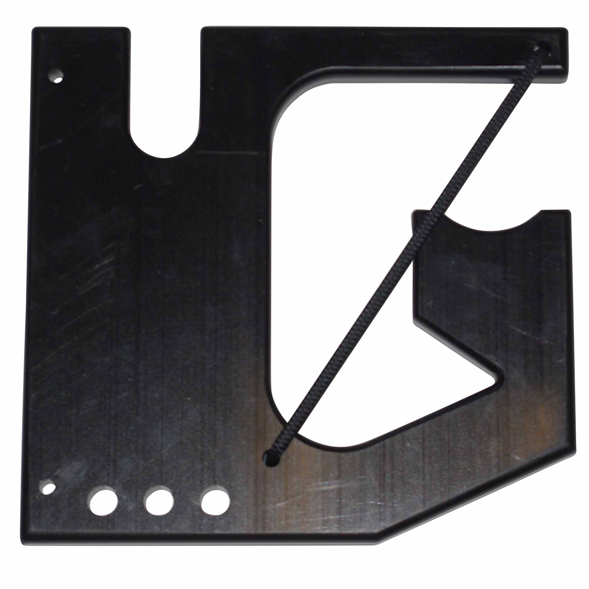

These from HydraMaster look like they would hold a wand well but how would you mount it to the ceiling?

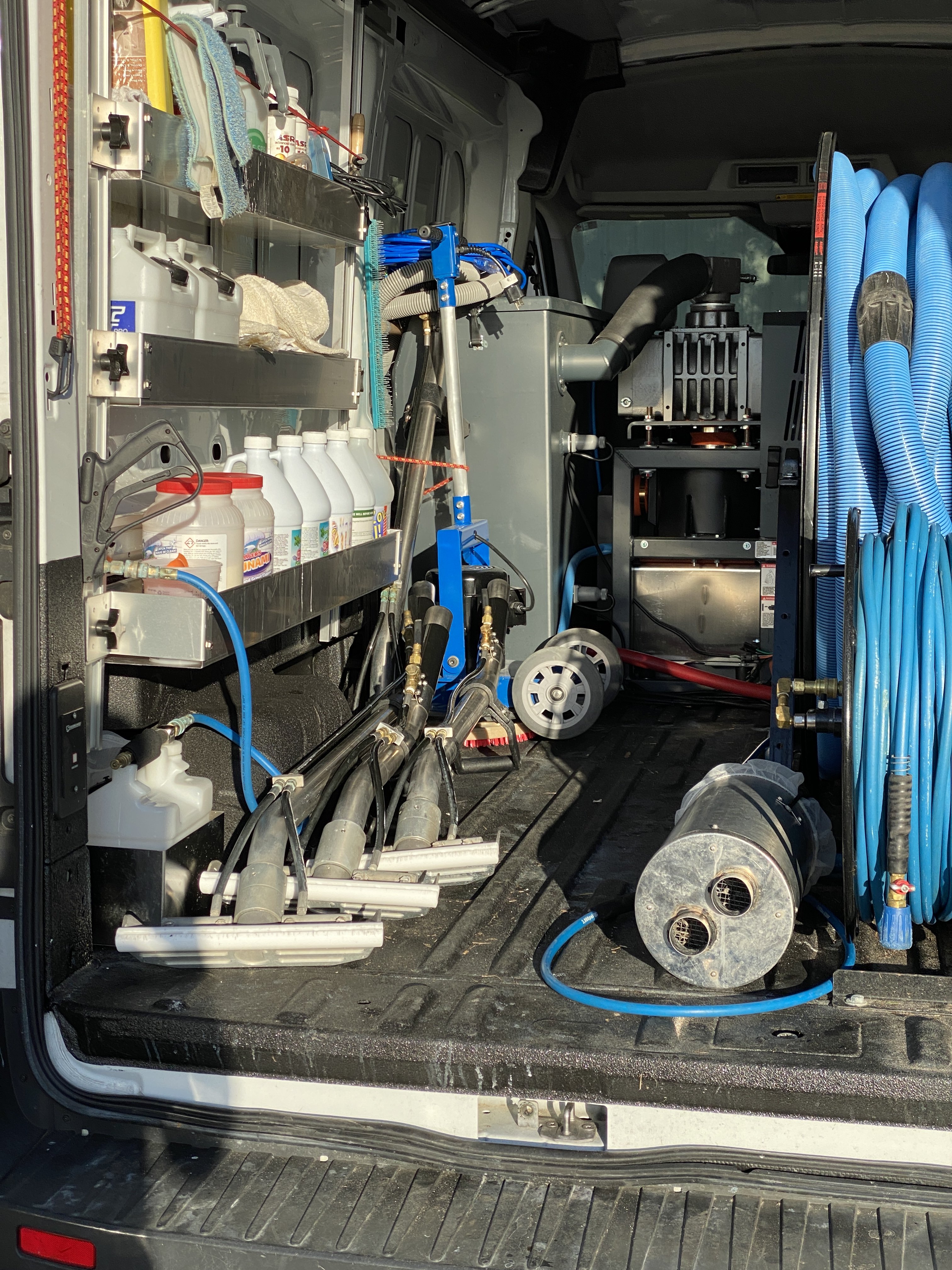

I got the Shelves on both sides with some basic hanging, actually custom welded aluminum in my old Thermalwave. But I use a bungee cords bigtime to make it all stay where it should. I hang Upholstery tools with bungee straight to the van frame like a match made in heaven.

Just line the wands up against the front of your chem shelves. Head on the floor, tube clipped into these bolted to the top shelf.
