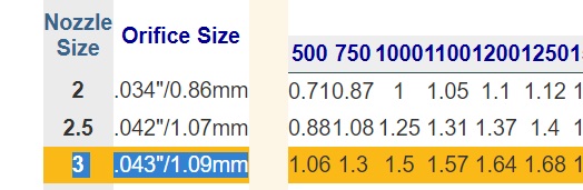

Don’t listen to those meatheads above. Just follow the chart to the specs on your water pump on how much gpm it can put out

(corrected for friction loss by Dan G)
