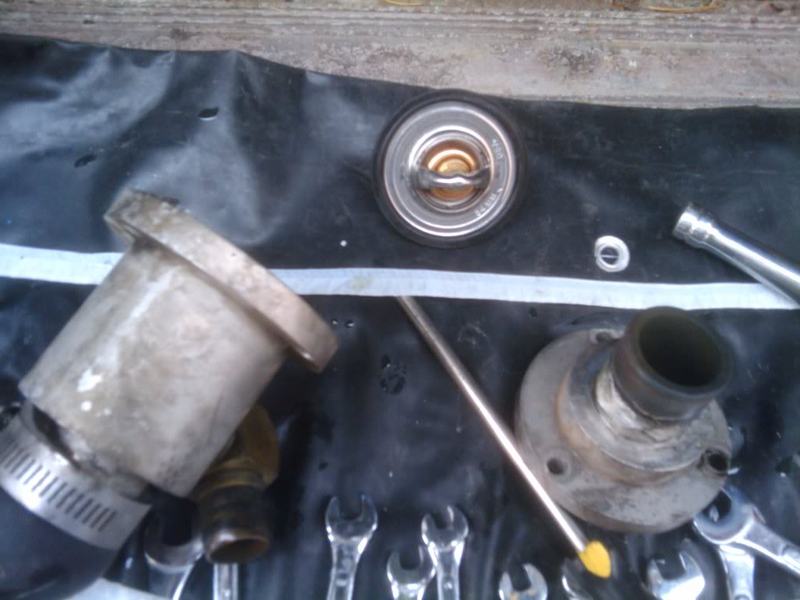

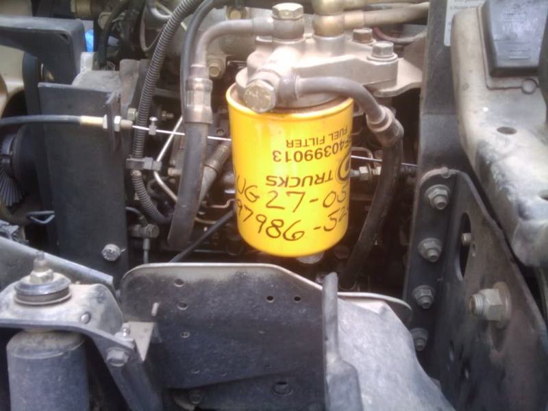

Thanks for the help everyone! Yesterday I spent all morning scrubbing rugs and all afternoon servicing the UD. Then last night went out and scrubbed rugs again. This is the first chance I've had to log-in and I'm overhelmed with the level of support. Thank you very much!
Decided to start with the easy stuff first.
I replaced the fuel filter. After spinning it loose I noticed a date of August 2005

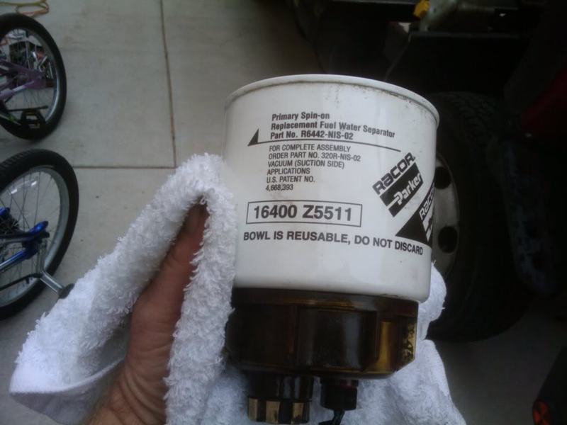

Then, removed and cleaned the sedimenter
Also, replaced the thermostat
Then, dumped in a pint of deisel fuel additive (didn't see the Lucas so had to settle for Prestone).
Now, this truck runs better than ever!
It's smother, quiter, and the cab and fresh water tank heats up faster. Well worth the few dollars it cost for parts.
I haven't determined yet if it resolved the original problem will keep ya' posted.

something else you may want to consider while you are doing all your truck maintenance.....(If you haven't already)..you might want to service the rear axle.....because of her age and miles and taking into consideration that the fuel filter was just over 4 years old... :shock: .....this has probably never been done....This has nothing to do with any of the above problems ..just a heads up so you won't have more issues down the road...........you would be amazed how many people over look this.....

Question on the sedimentor,did you replace or clean? If cleaned how?

Brad, I cleaned the sedimentor in a coffee can half full of deisel, put the lid on, and slosh around. Rinse and repeat.
When replacing the fuel filter its a great idea to fill it with diesel fuel first. Then, loosen the bleeder screw, pump the primer knob until air stops coming out, tighten the bleeder screw and your done.
