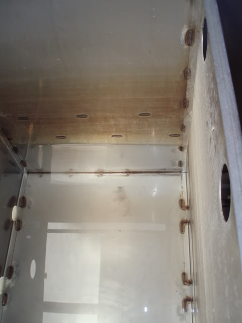

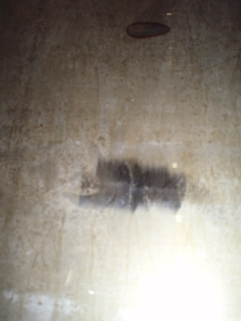

After 4 years It developed a fresh tank drip.
See the crack?
I can't either, but its there

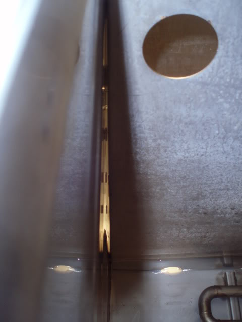

Both my baffle walls fell over in the first year on my Aero Tech built tank. I had a local welder re tack them in. the sides worked loose but the top and bottom welds are holding. AT had nothing on the bottom holding the walls down. :shock:

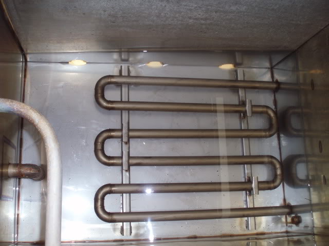

HX pipe from the radiator
Redoing the lid gasket while I'm in there.
117,255
I had Nordik1 install that HX pipe Vince.

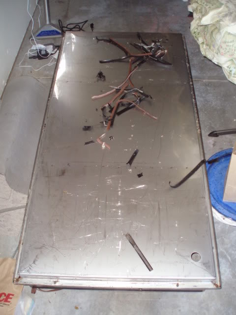

How many times have your replaced the float? I had to do mine 3 times. The first 3 (including the original) melted and sagged over time. Replaced it with a copper one- much better.
http://www.grainger.com/Grainger/wwg/pr ... =Floats%2C
might be le$$ to contact Olson and see what he gets for the brass(?) float ball used in your PM water box.
I know they're not cheap, It's been so long since I bought one, but think they were close to $70
Those cheap seamed copper ones don't hold up well from my experience
the valve in the V tank is a Roberts float valve?????

they snap off at the brass...where the plunger is..I have just learned to fill it with out one...One of these days I will fix it and not have to worry any more about it..probably use a pressure switch....or a magnetic float switch...

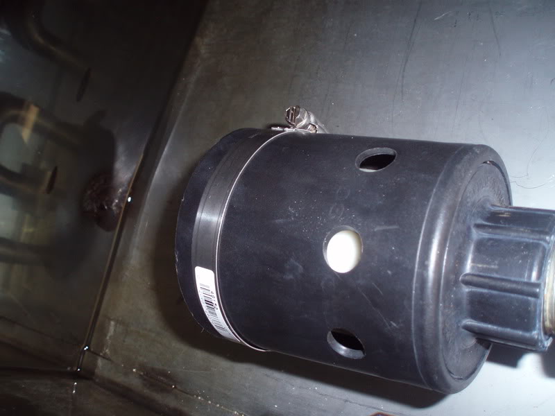

Do yo self a flave of flave and wrap a hose clamp around yo float to keep it from oblonging.

I have no float. That particular float was found in pieces in the bottom of my tank. I now have a brass one, just like the one Jim showed, but I have not put it in yet.

The plastic Hudson looks like a winner from a stability point. Mike, what causes them to "oblong"? Just the hot water in general?
117,255
Yep, the outer black shell cant take it for more than a few months.
Even the stock pvc pipe that attached to it oblonged like mad.
