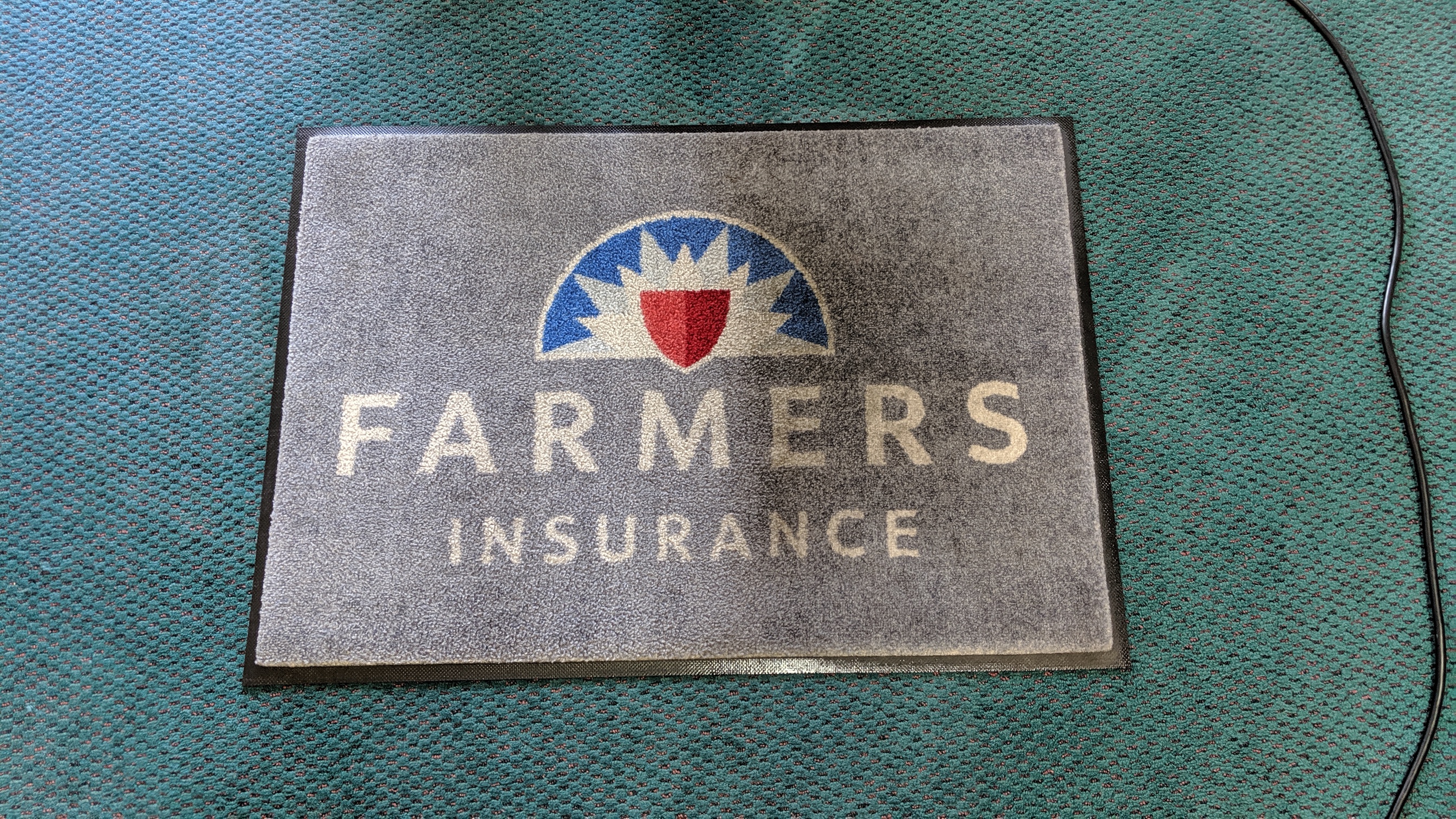

wouldn't you know it ..I shot all kinds of video of my little commercial job tonight, which came out great, and I got to play with the different travel choices and the video is sitting there on my phone and 9.49 minutes and sons a bitch it won't play ..I don't know what's up anyhow I will do a better tutorial video in my garage hopefully over this weekend I needed to ask Victoria question or two anyways I was a little uncertain after I got the head off of exactly what I was seeing but it was very interesting none the less

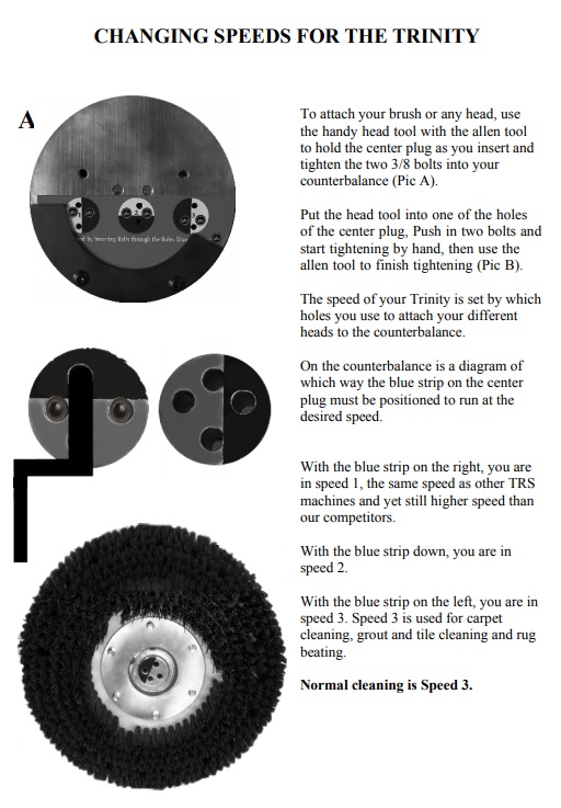

Confused, Speed? D;oes the machine change the speed of the motor revolutions when changing the travel? Or does the reference to "speed" reference the speed of the cleaning process due to the larger travel of the block/bonnet?
Never realized what is involved in switching levels of "speed?"
