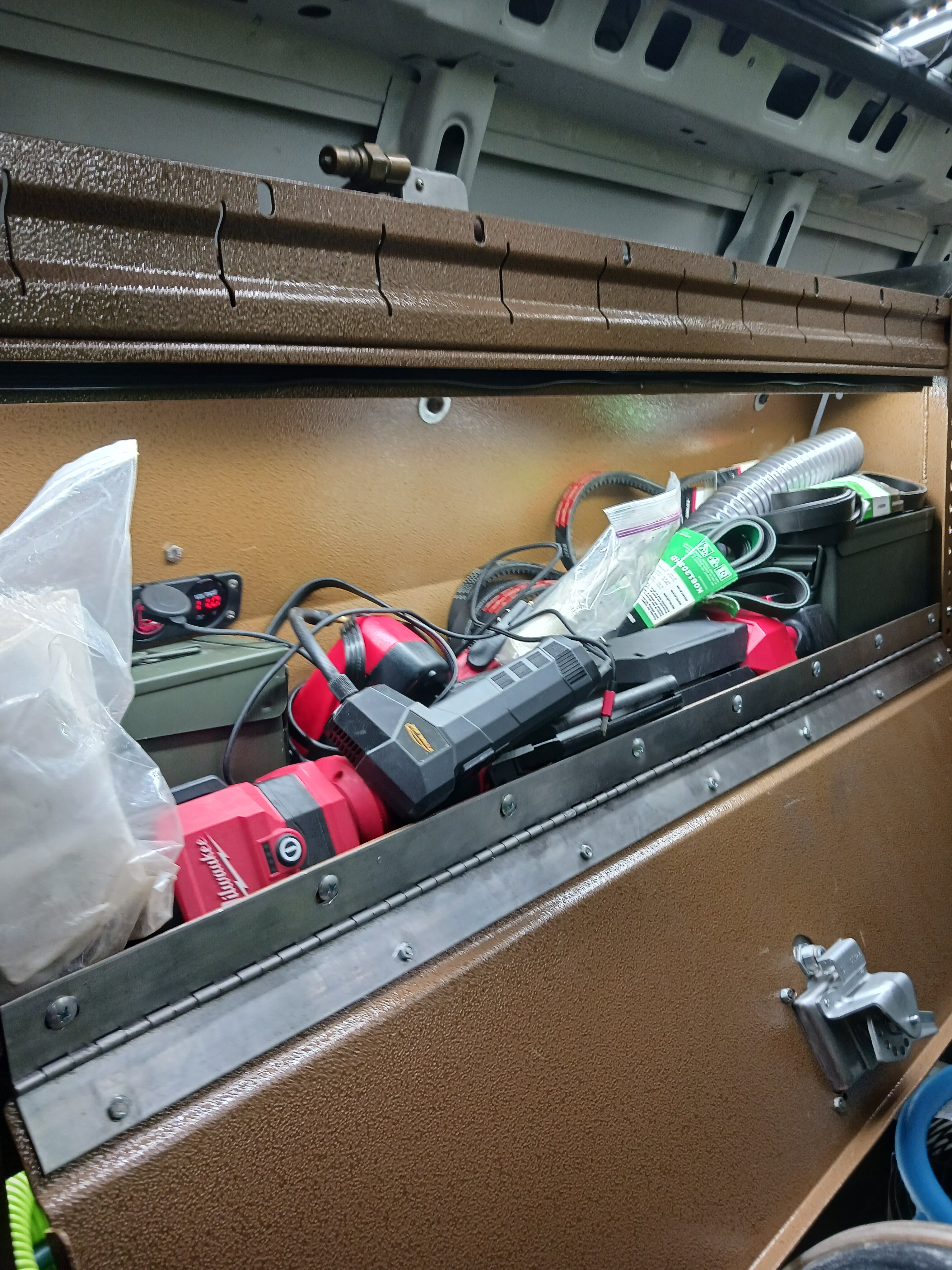

3. The Cockpit: Operational Layout
Your van is a workspace — not a storage locker.
Disorganization increases:
  • Setup time
  • Fatigue
  • Equipment damage
Avoid Dead Space
Do not create inaccessible voids behind reels or slide-ins.
If you cannot reach it easily, you will not use it efficiently.
Hose Management
Massive hose reels often consume unnecessary square footage.
Consider:
  • Side-mount systems
  • Ceiling hang systems
  • Modular deployment setups
Space equals flexibility.
Modular Storage
Use dedicated totes for task categories:
  • Grout Kit
  • VLM Kit
  • Stone Kit
  • Spotting Kit
  • Repair Kit
Compartmentalization reduces downtime.

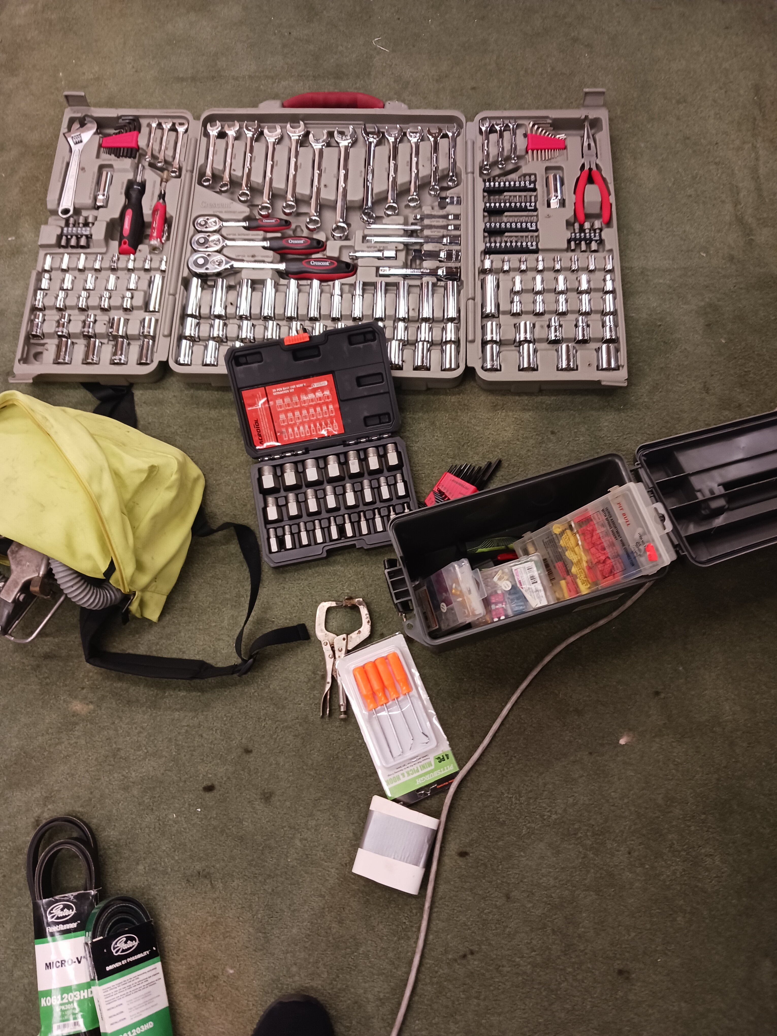

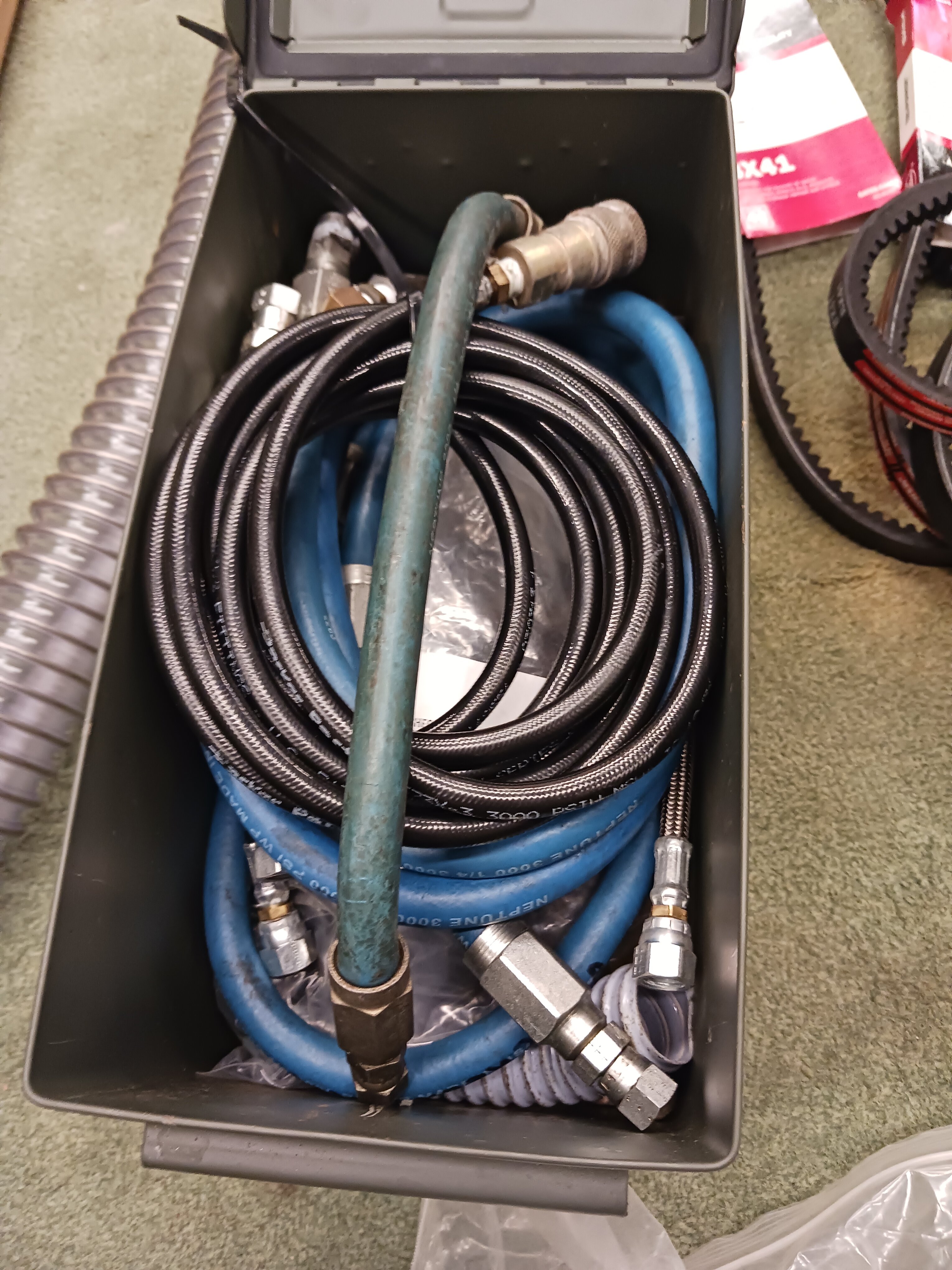

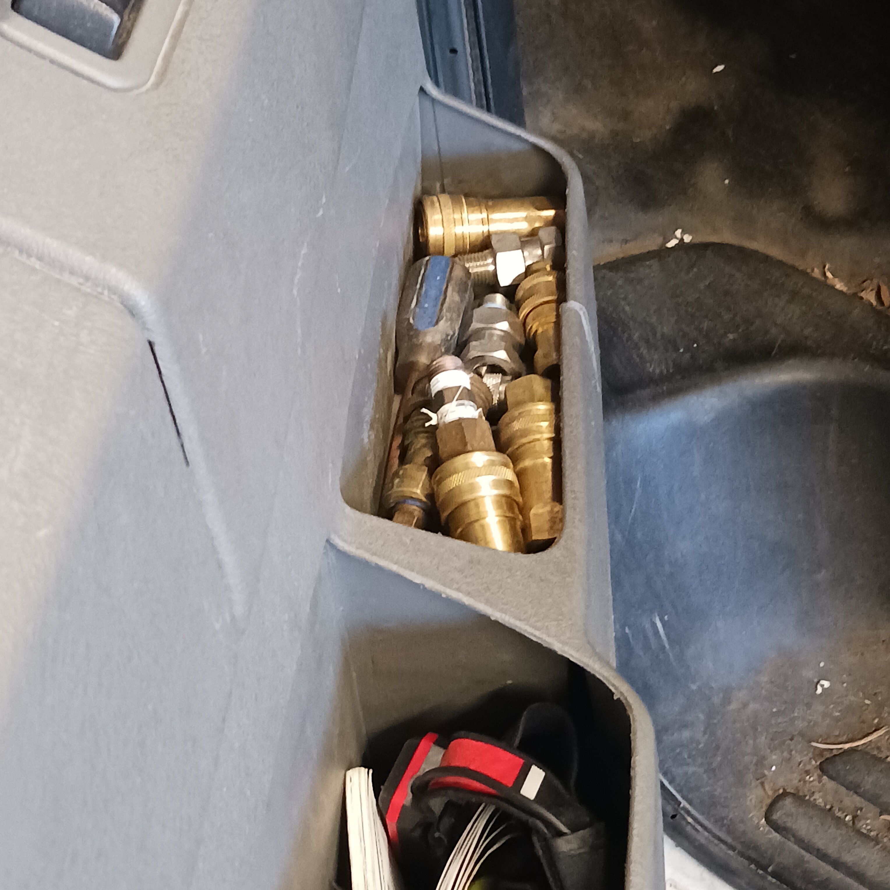

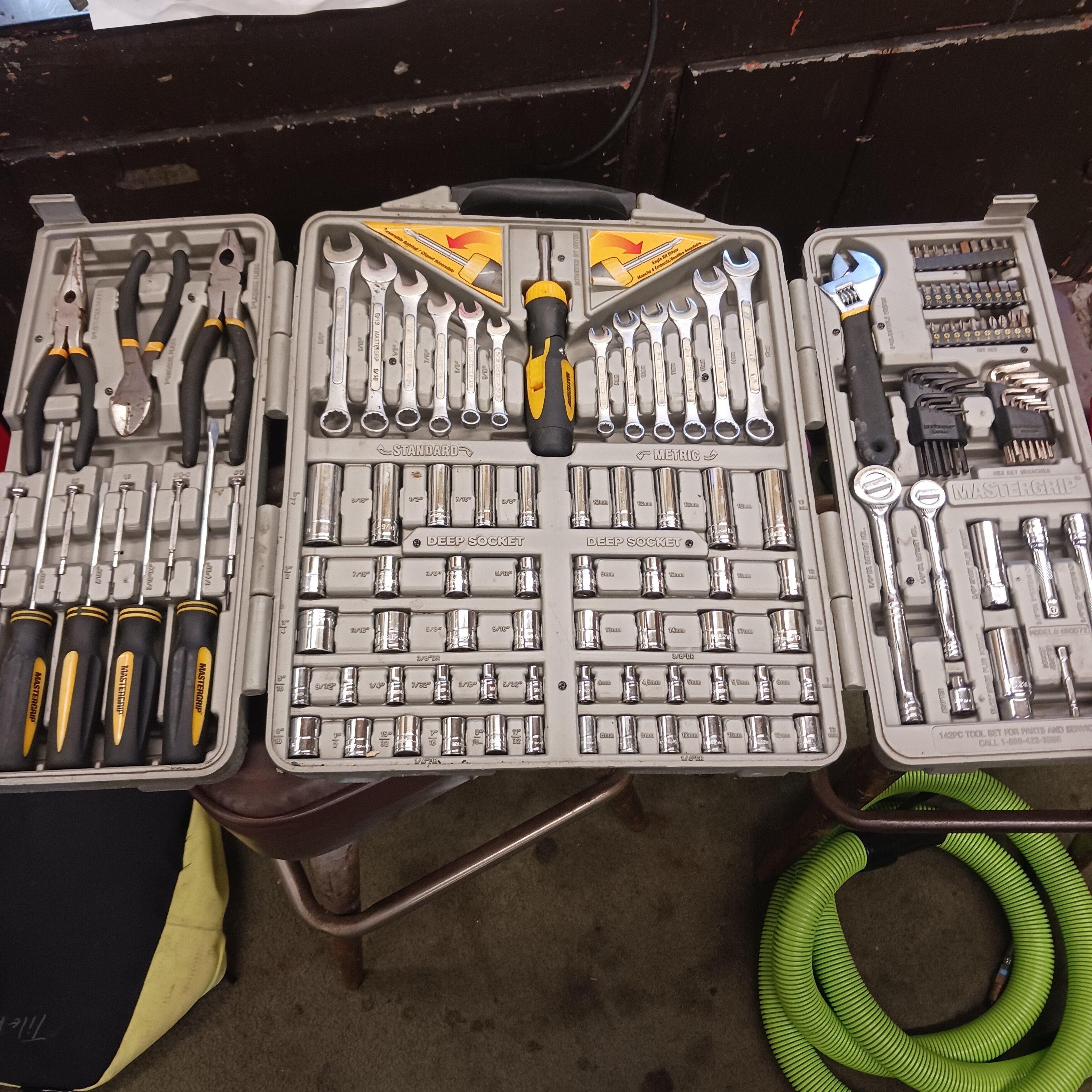

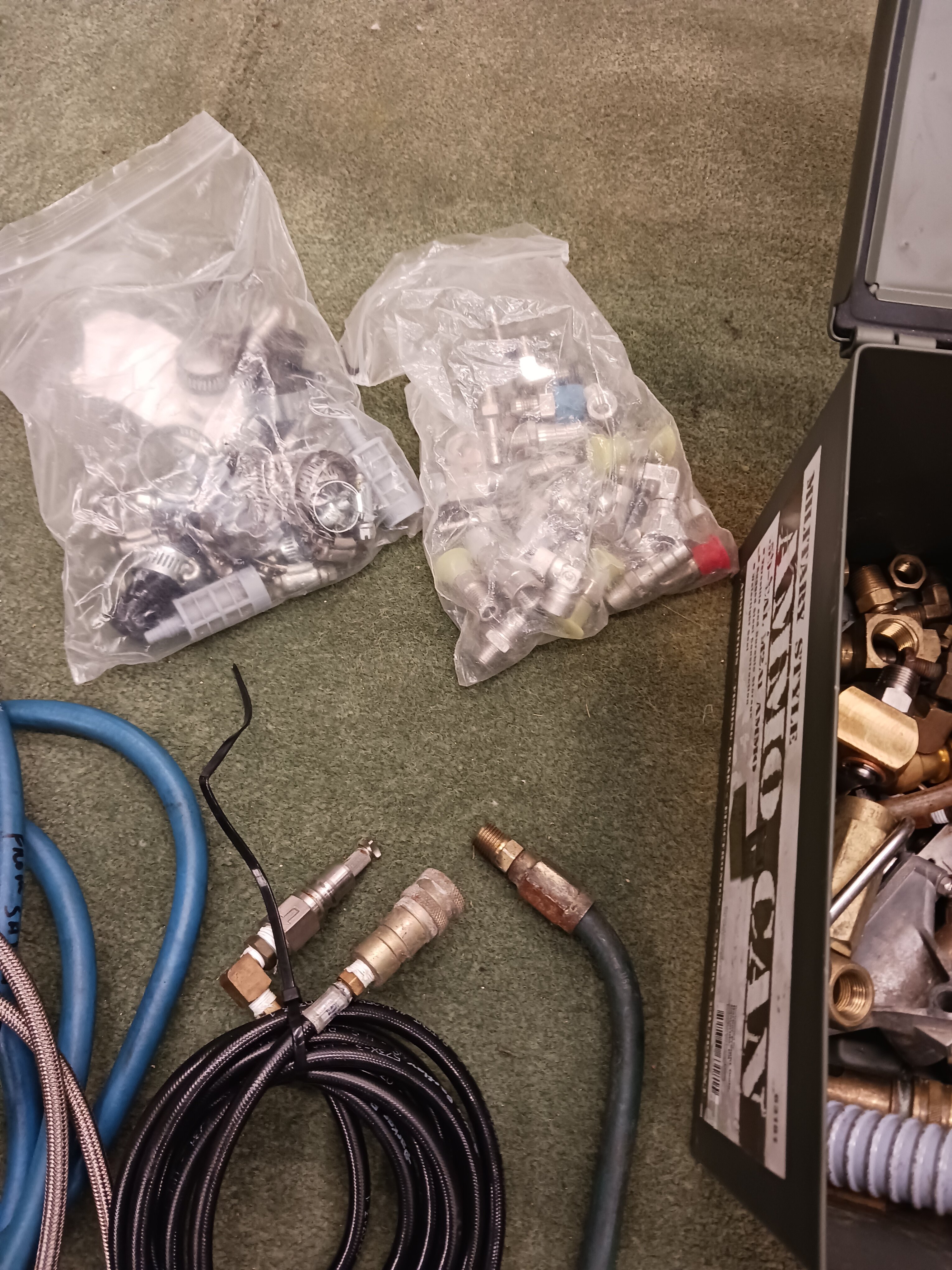

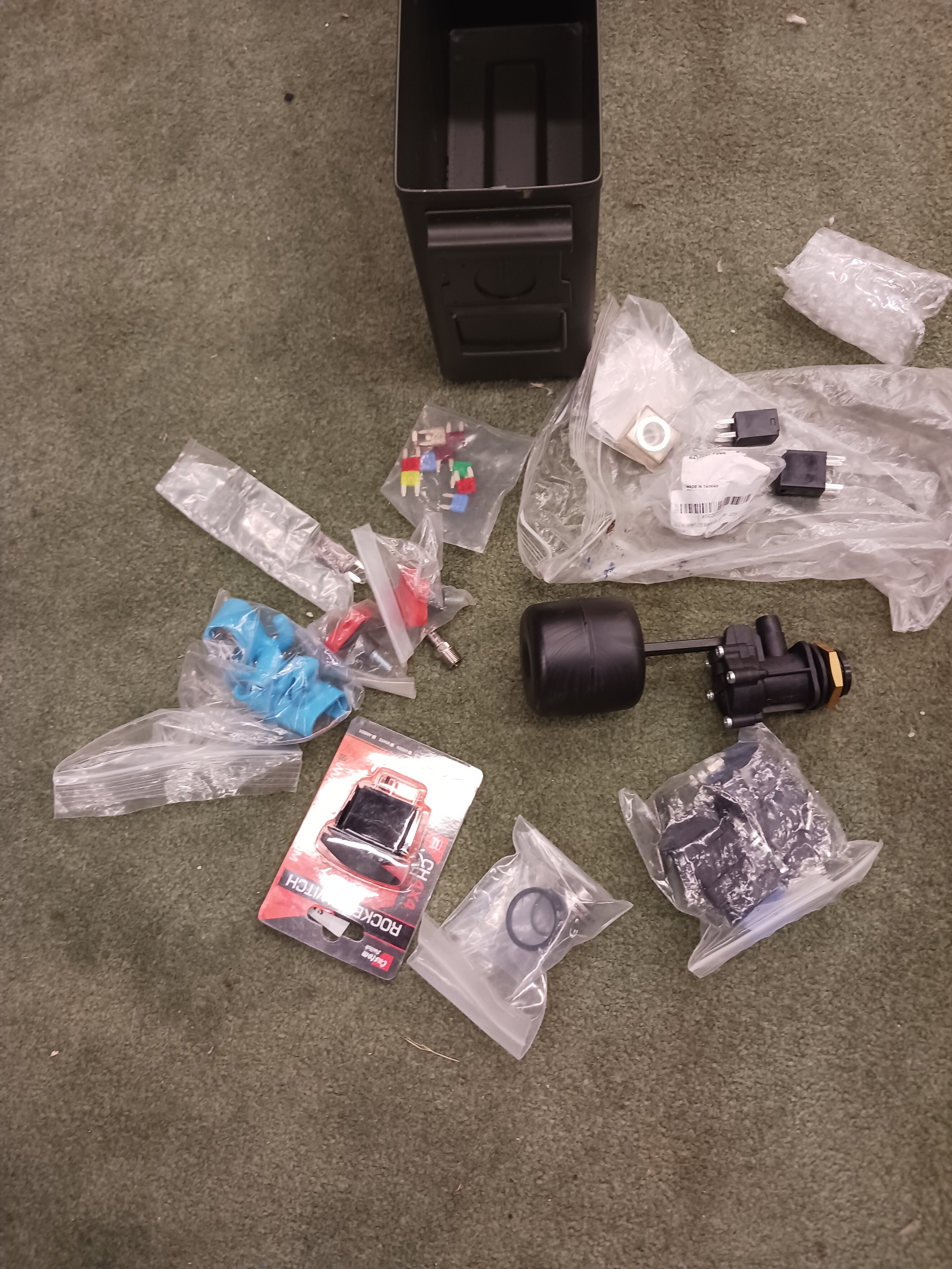

5. The Field Repair System
If you own equipment, you must be capable of maintaining it.
Downtime destroys momentum.
Carry a dedicated repair tote containing:
Spare Components
  • Brass fittings
  • Quick-connects
  • Jets
  • Valve rebuild kits
  • Belts and oil
  • Tool hoses
Adhesives & Consumables
  • Teflon tape
  • Silicone
  • Glue gun
  • Assorted fasteners
Core Tools
  • Wrenches
  • Screwdrivers
  • Allen keys
  • Pry bars
  • Headlamp
  • Vice grips
  • Impact driver
  • Hammer
You do not need to be a master mechanic.
But you must not be helpless.

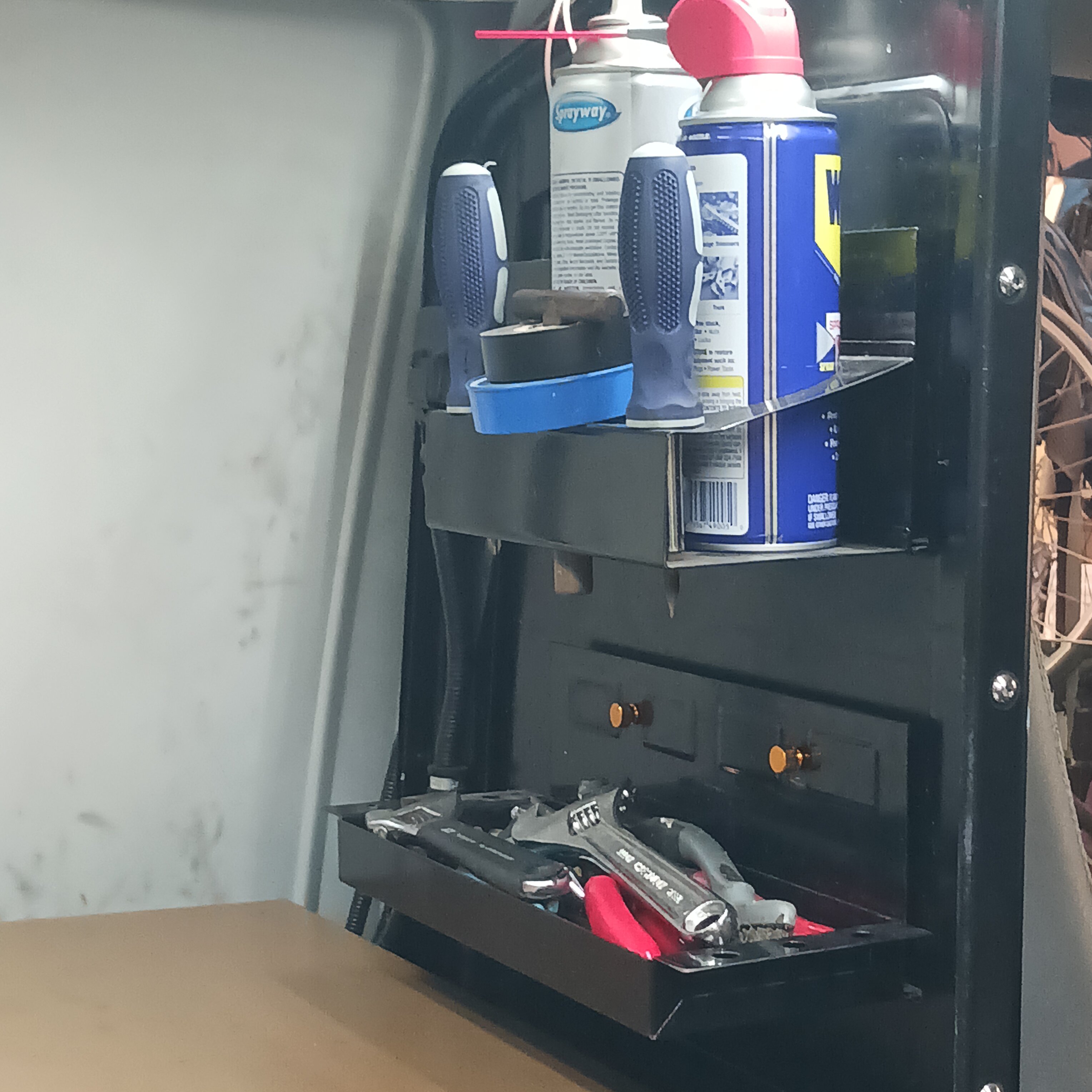

  • Setup time
  • Fatigue
  • Equipment damage
Avoid Dead Space
Hose Management
Consider:
Modular Storage
  • Grout Kit
  • VLM Kit
  • Stone Kit
  • Spotting Kit
  • Repair Kit

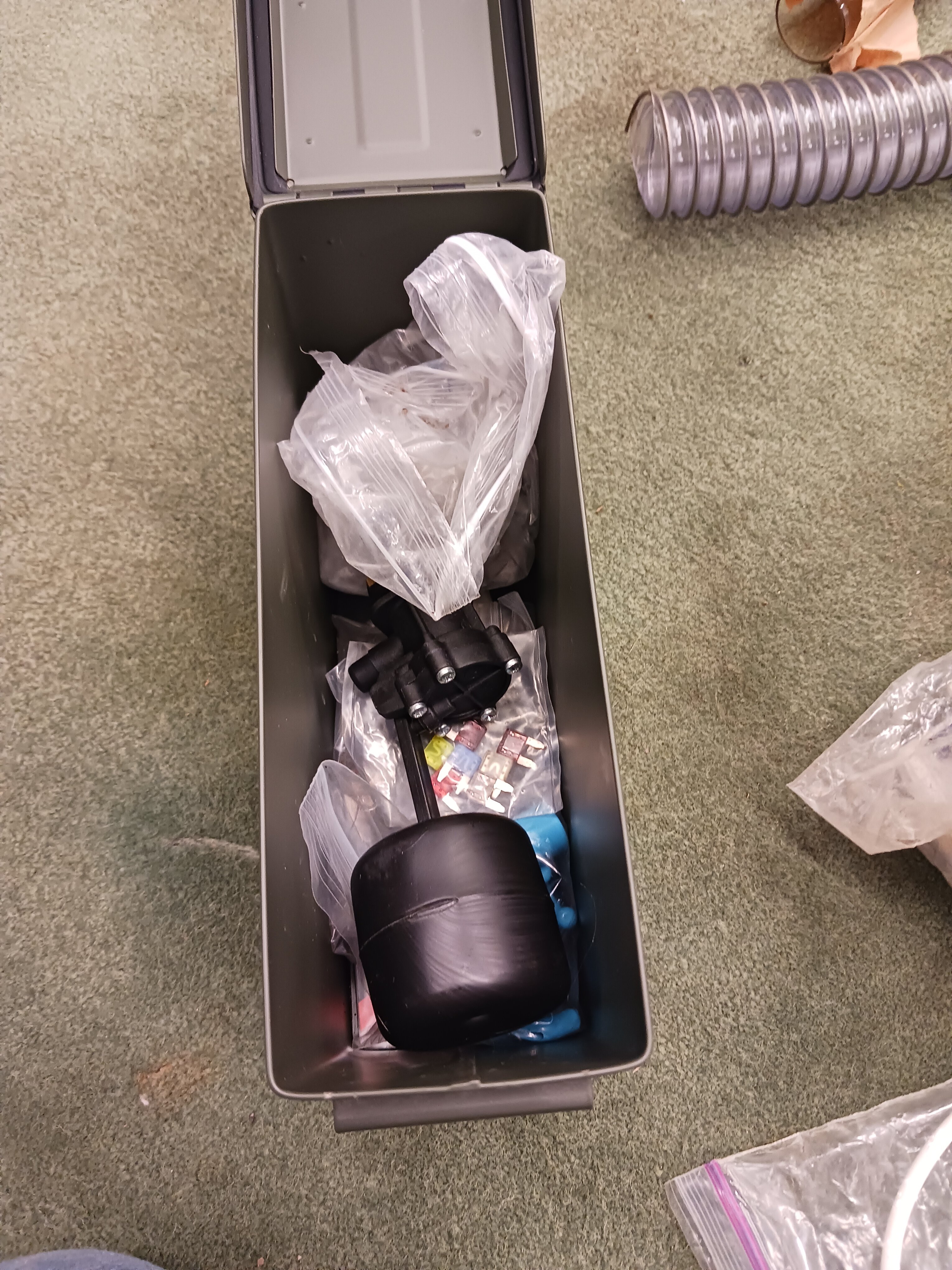

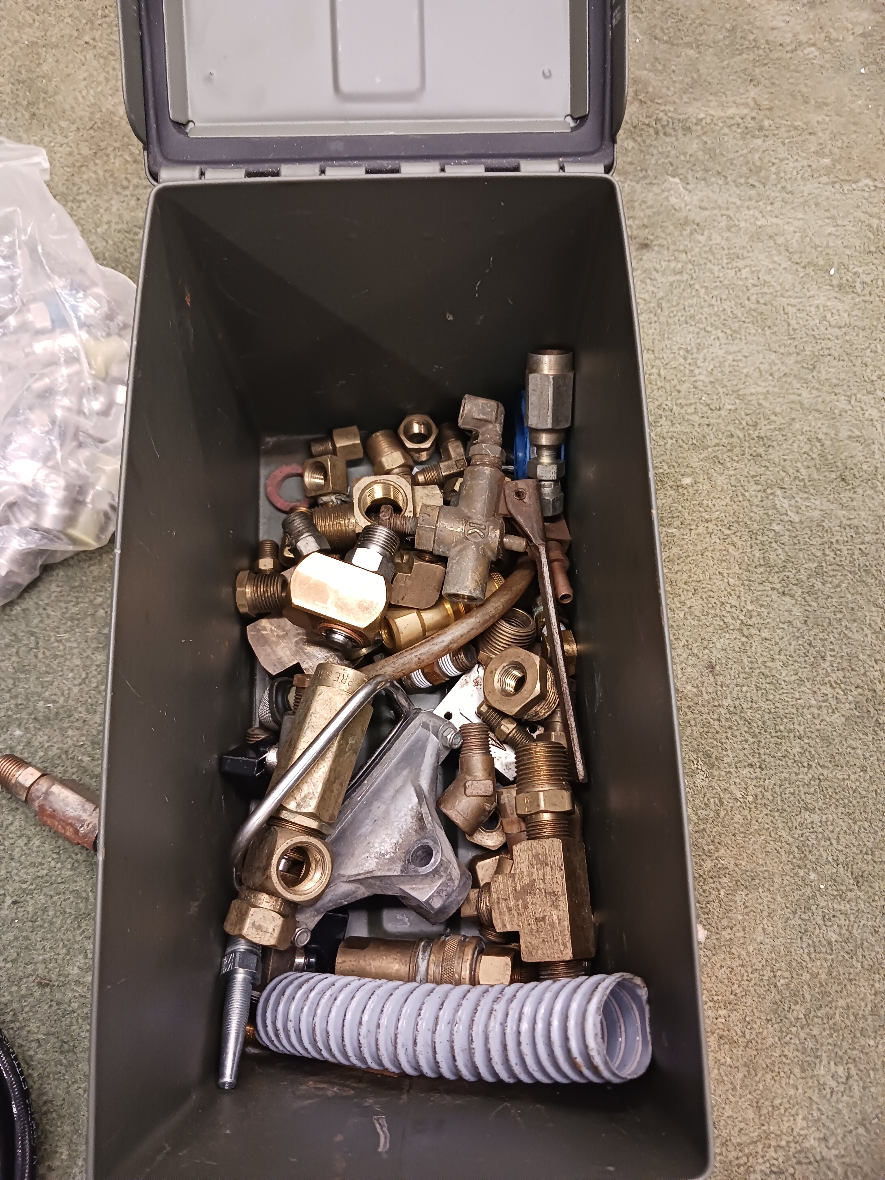

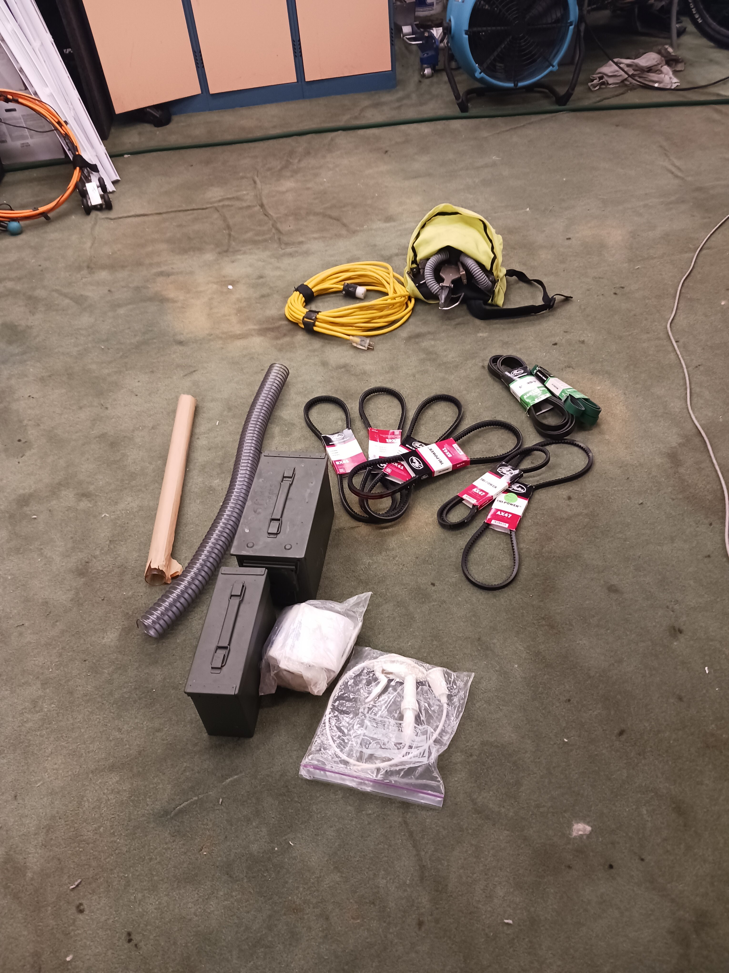

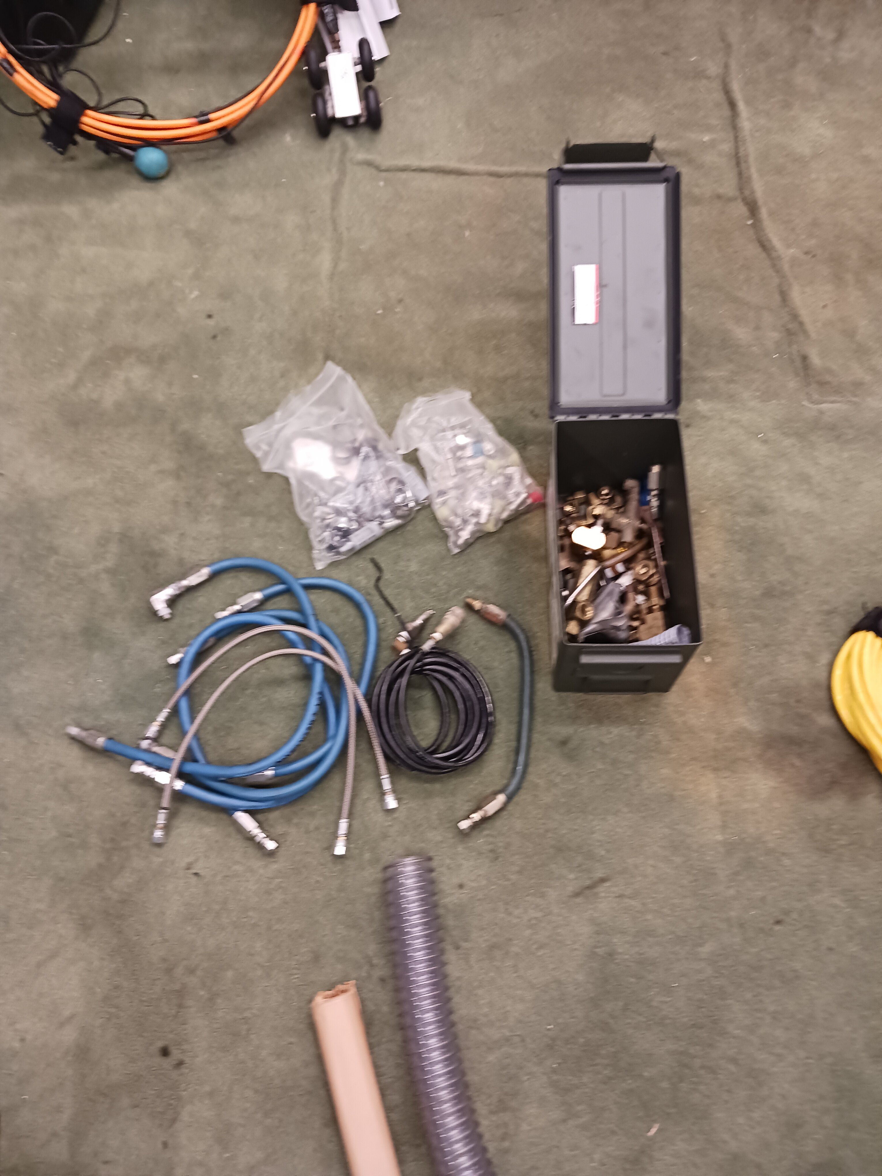

Spare Components
  • Brass fittings
  • Quick-connects
  • Jets
  • Belts and oil
  • Tool hoses
  • Teflon tape
  • Silicone
  • Glue gun

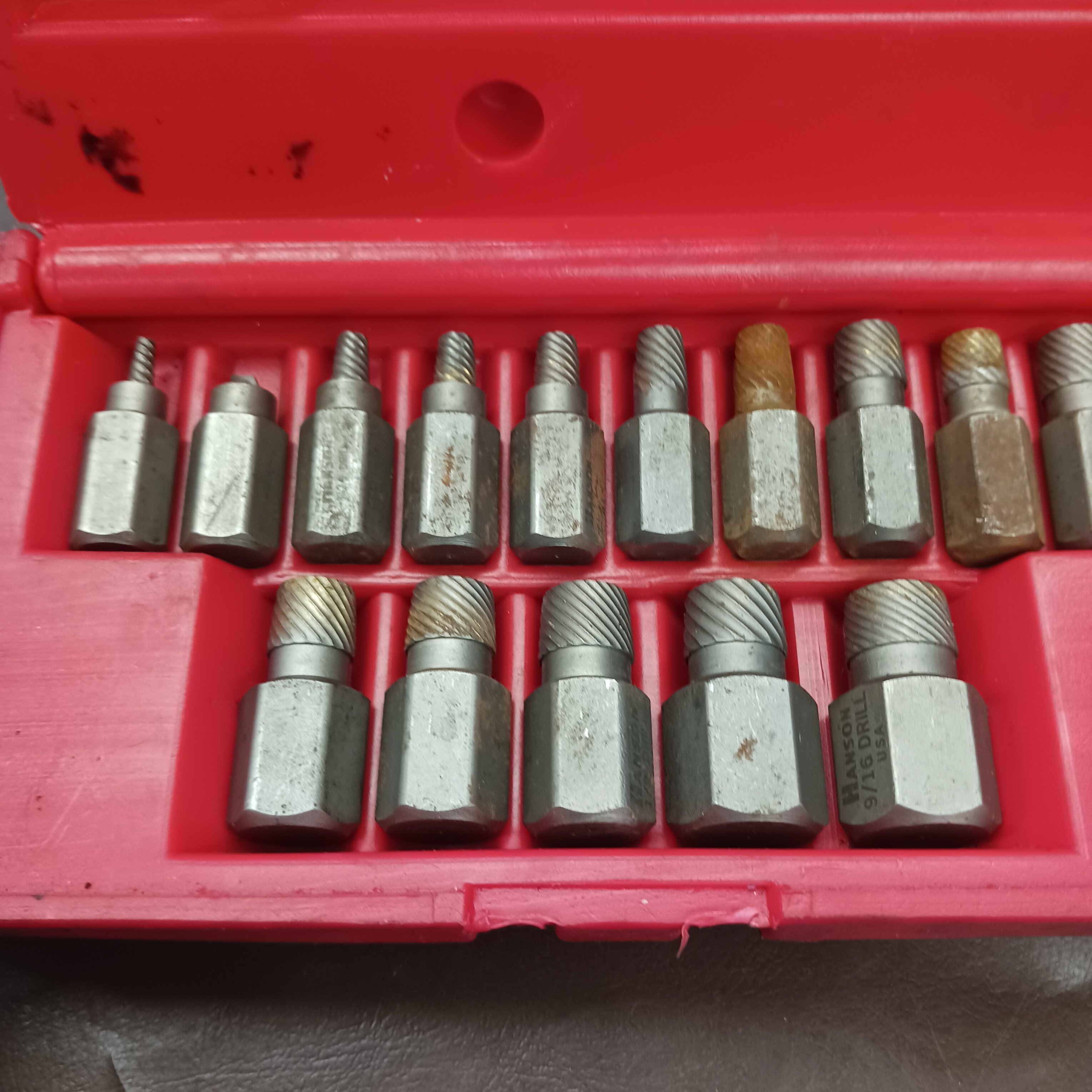

Core Tools
  • Wrenches
  • Screwdrivers
  • Allen keys
  • Pry bars
  • Headlamp
  • Vice grips
  • Impact driver
  • Hammer

When it comes to spare parts and tools to facilitate repairs remotely, i tend to take things to extreme. Only because i can be 3 hours round trip from my shop. But there are a few things everyone should have on their van. First i have "handy tools" used for quick repairs. Mine are handy, next to the machine. I use magnetic tool box accessory holders from harbor freight to keep.um handy and accessible. Next i highly recommend a comprehensive tool kit in a blow molded case for anything where a larger assortment of tools are necessary. It'll fold up nicely and can be stored behind the seat ready when needed. I suggest that you get a good brand and blow molded allows a place for everything and keep everything in its place. An add on set i highly recommend it extractor set for broken brass fittings. I have a competitor that comes to my shop a couple of times a year to remove a broken brsss fitting. I charge him 20.00 each time. I never told him that he could get a whole set of extractors for less than 1 visit and fix the problem on the job with a crescent wrench. As far as spare parts go get a metal ammunition box and fill it with what you need. It'll fit under or behind the seat but keep parts like quick connects handy i use a pocket in the driver's door for that. Most repairs can be done on site with little to no down time driving to home base and back to finish the job. Another tip is you don't need every hose your machine has backed up. Heres a trick so you don't have to stock alot of different size hoses. One or two long hoses with adapters can replace any hose in a pinch and get the job done. Once you get back to home base you can exchange it for the proper one. If only ome person reads this and takes it to heart, it will been worth the time it took me to peck this out on my phone
20260324_143137.jpg 20260324_142959.jpg 20260324_143009.jpg 20260324_143429.jpg 20230126_142656.jpg 20230126_142716.jpg 20230126_142727.jpg 20230126_143021.jpg 20230126_143159.jpg 20230126_143202.jpg 20230126_143207.jpg 20230126_143215.jpg 20230126_142157.jpg
