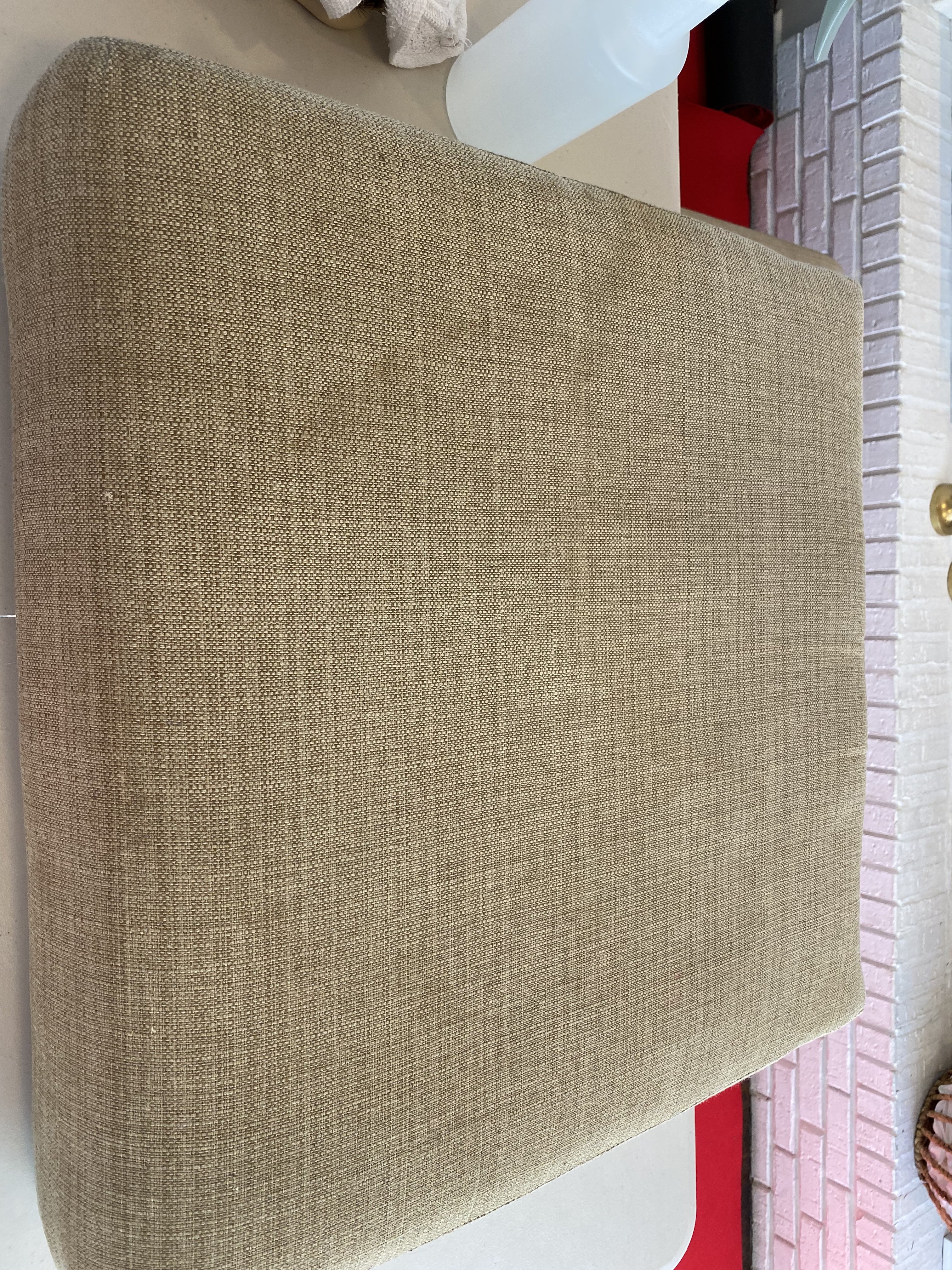

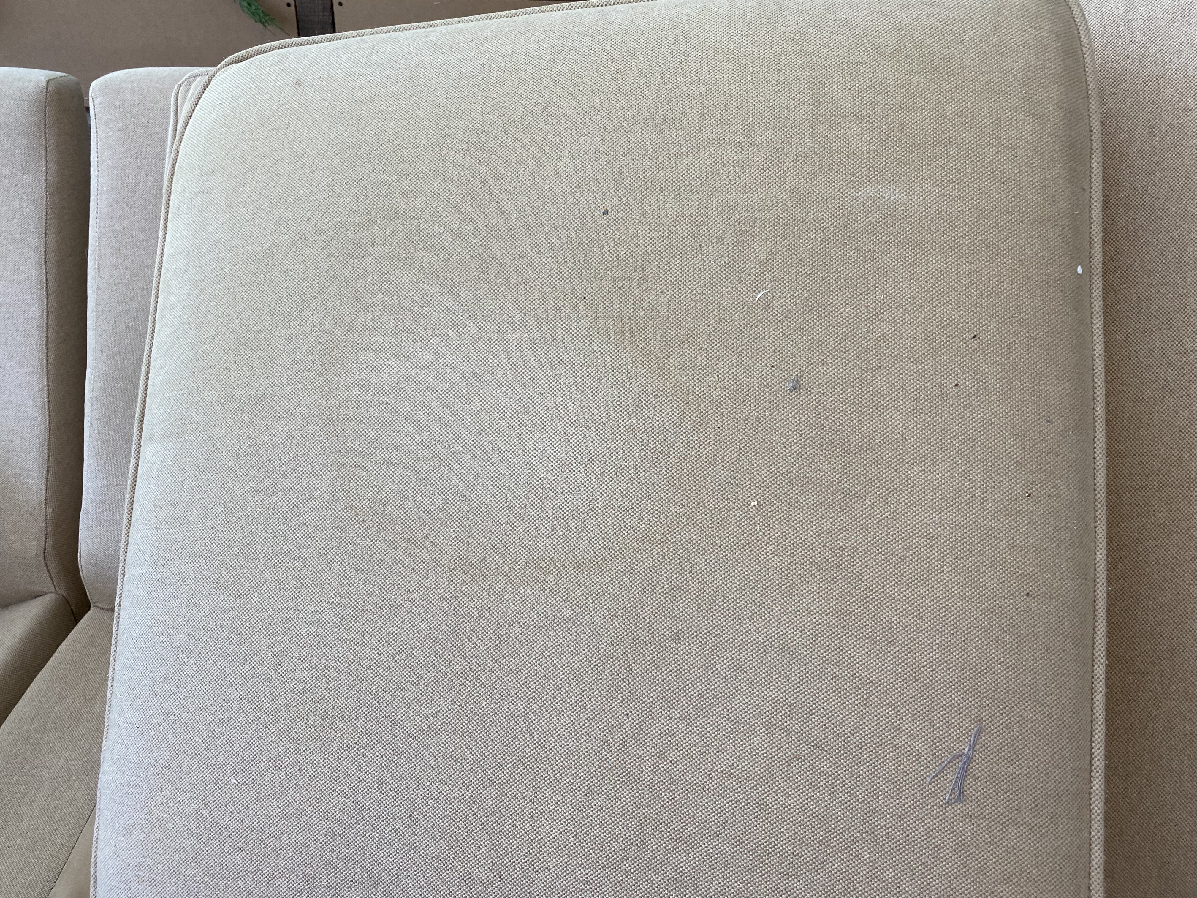

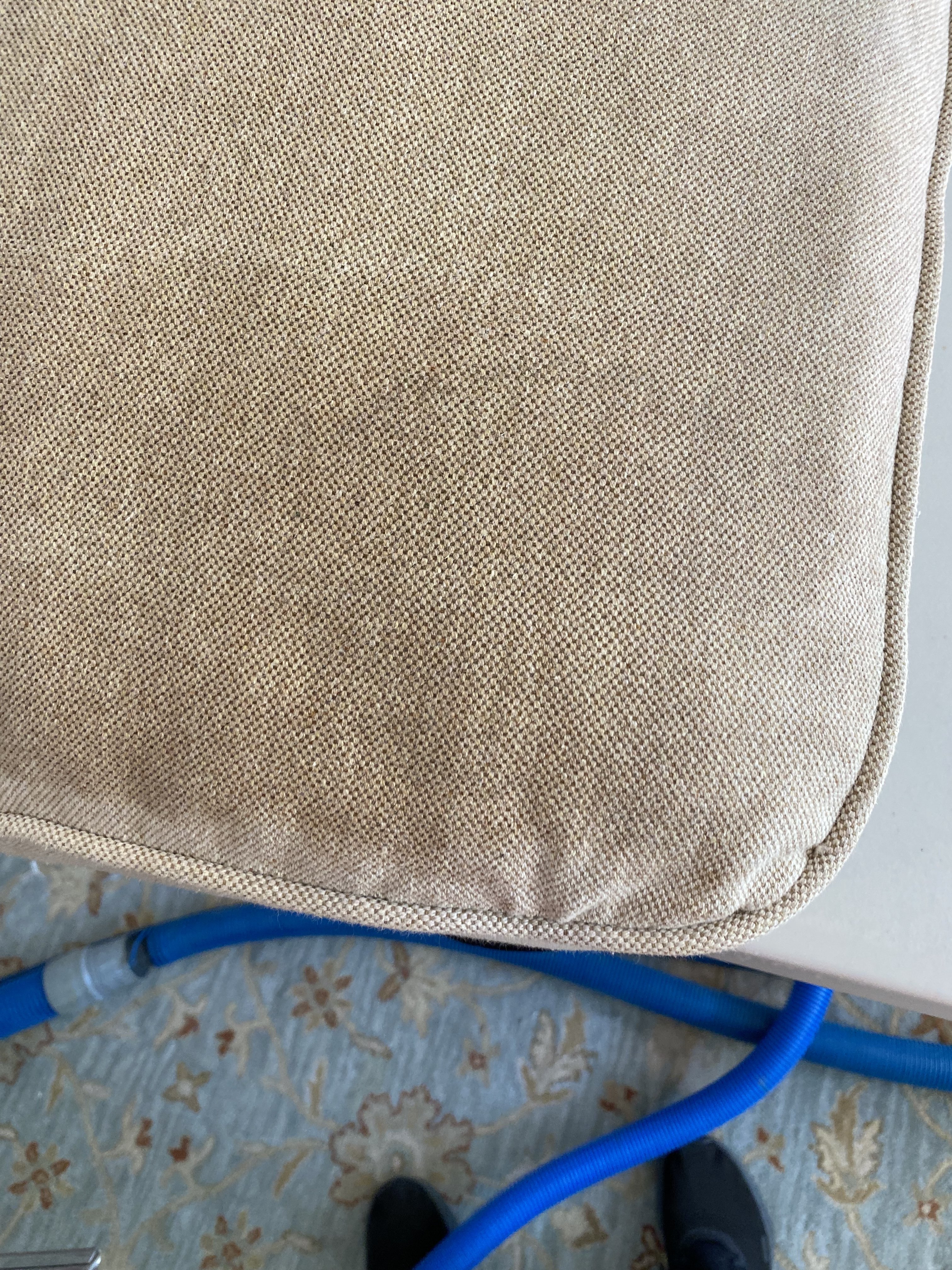

I clean plenty. But I hate coming across these water marks. I come across this problem more than ever. I am always fiber testing, mixing my solution correctly. I pre-vacuum, treat, light agitation, and boom, this happens.
Luckily I can contain it to a certain extent. The sun helps a lot. I could not imagine sending a technician on his own and dealing with this without proper techniques and education.
All of these spots were pre-existing.

Get a Sapphire Upholstery tool, its shearing action will clean without over wetting.
The Tool itself will prevent most of those types of issues, making it easier and more desirable to clean upholstery.
