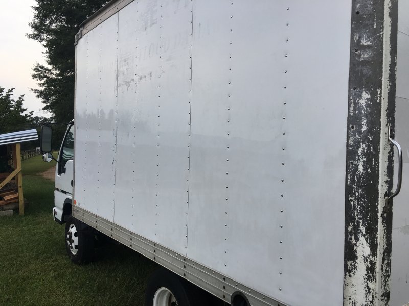

Before scraping adhesive off. I know you guys have seen this already. I'm adding more.

After 8hrs of scraping

Use a heat or steam gun to get the adhesive off. You're coming up in the world Matt. Good job.

Brake cleaner will be the only thing to get the adhesive off.

Adhesive remover applied with ample dwell time will yield best results with least anount of effort and overall time.

I started using goof off and it was taking the paint off with the adhesive as well. I used a few other things and didn't like the outcome and found that wd40 did the best. I sprayed it on, loved that it stayed on and didn't evaporate immediately, let it dwell, and started scraping. There's just a tad left on it, and I'm gonna see if my wrapping company will let me get by with it. If not, I'm just gonna pay them extra to remove it themselves. I'm burned out on scraping

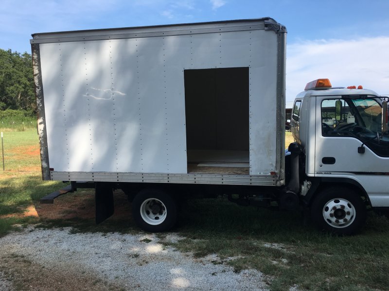

As for the door, I have a local welder machine dude that did all the cutting and remaking of the frame. There's a trailer company that builds enclosed trailers in a county next to mine that's gonna install the door this thursday.
