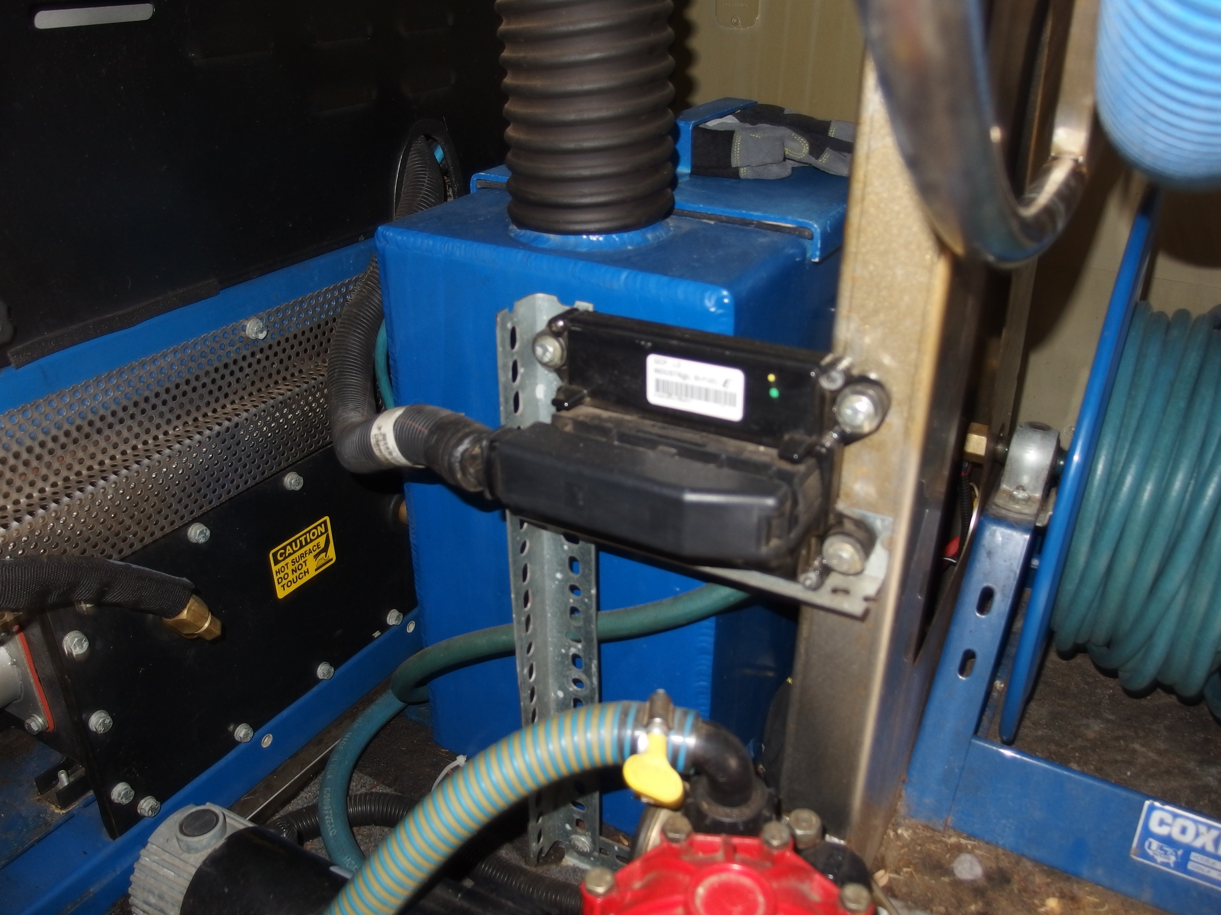

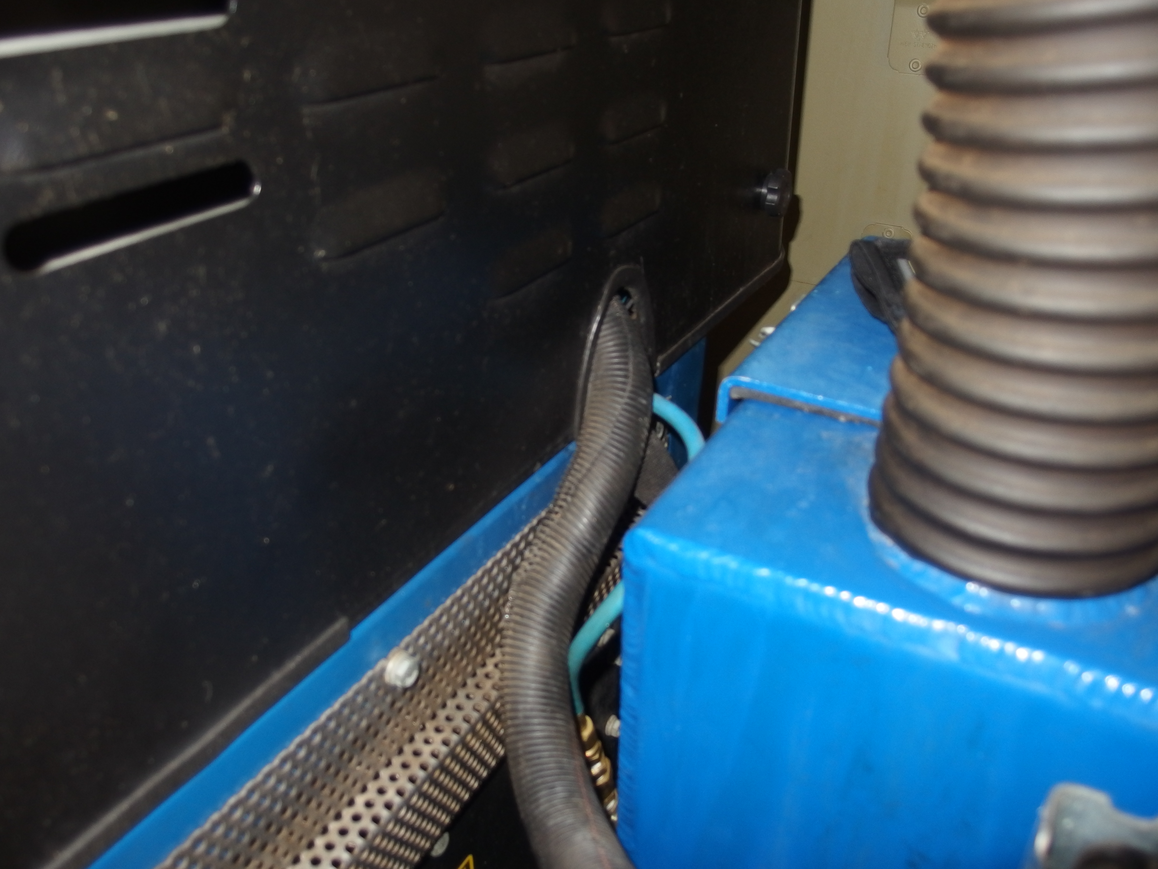

Its the GM 1.6 Vortec.
that's the one I have and there should be enough cable already attached to it....it is mounted under the engine in the front...and on mine the cable should be wire tied in a bundle in front of it...take it out the side left side of the machine where it can stay cooler.....

But where do you get the cable ?
you should not have to get any cable for the vortex model...there should be more than enough already attached to it to get it outside the engine compartment..........
