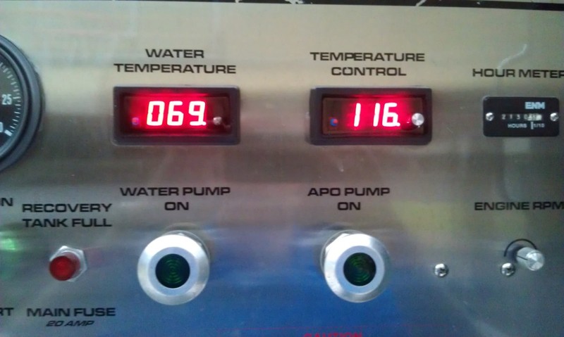

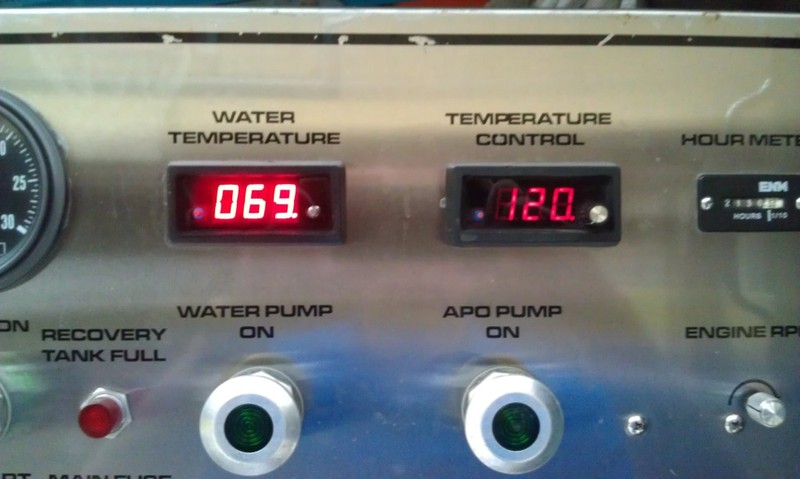

My left temp gauge has been out for a while and I was concerned with the age of the right one (which controls heat) so I decided to replace both with brighter gauges.
Much brighter, can see now in the light of the day but from far away as well.

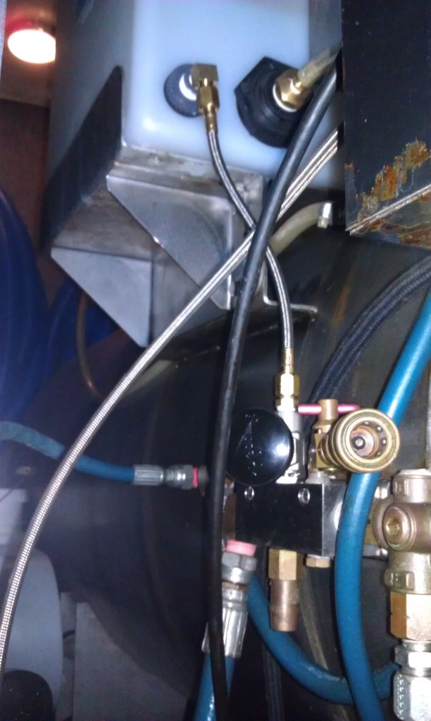

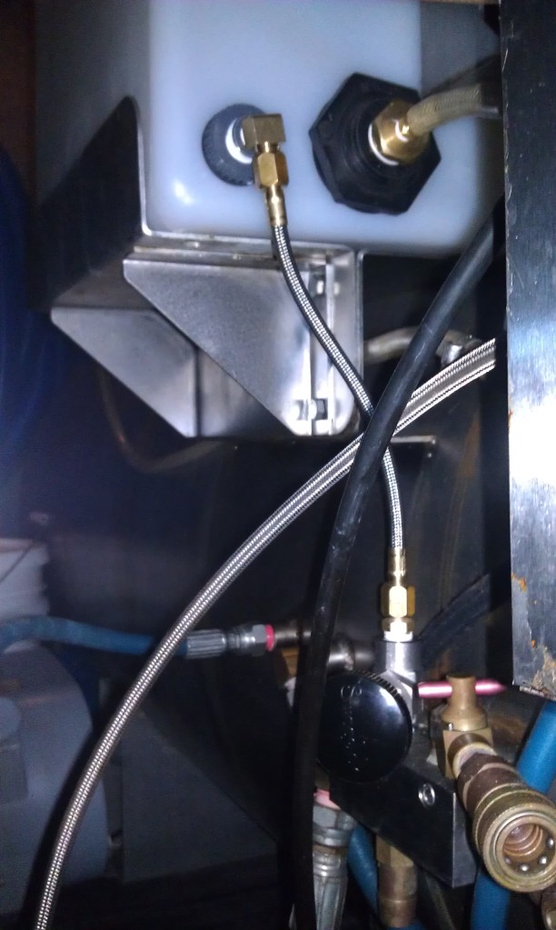

My solution tank cracked at one of the corners about 2 years ago. I hardly used any rinse anyway. Replaced with a 5 gal square pal that fit pretty good, but was a quick fix. Replace the tank and also installed a fresh hot water fill system to mix new rinse instead of having to put the water hose or solution hose in it. I have to say - very nice idea.

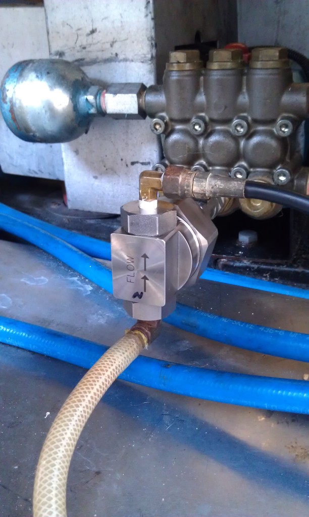

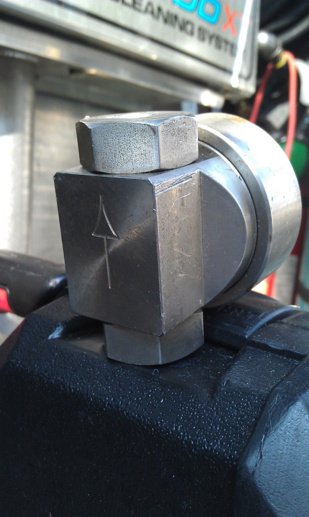

Also replaced the old chem pump (600-700 max) with a new higher psi chem pump (1500).
Old one is for sale - if anyone needs one - may need a new diaphram.

Where did you get your temp gauges?

I was told that pulsation dampeners should not be ran on their sides.
Put it out on an elbow
