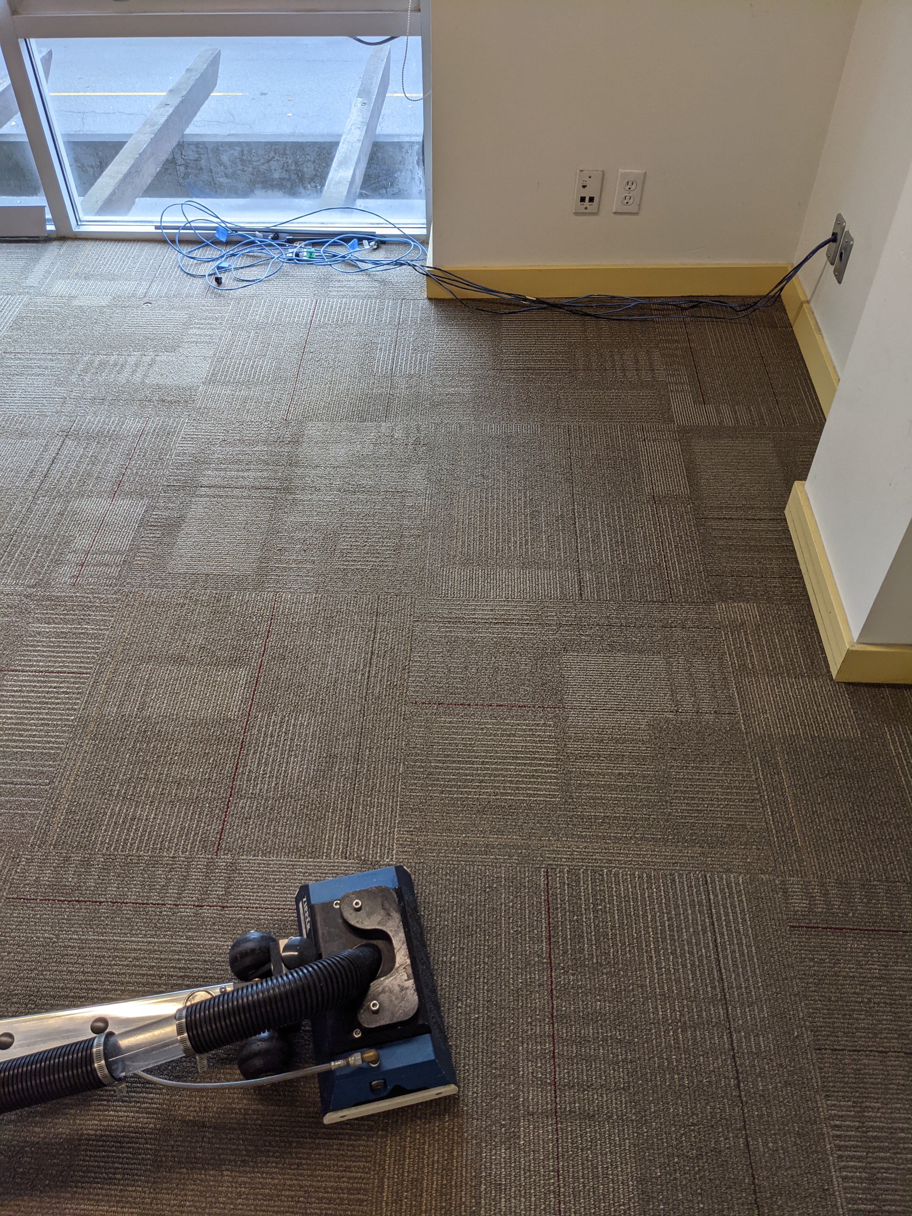

Just Zipping through this 1000 sqft office. Prevacuum, prespray with Saigers Code Red and nothing stands in our way.
PXL_20211102_171242217.MP.jpg PXL_20211102_170848414.jpg PXL_20211102_170545041.jpg
