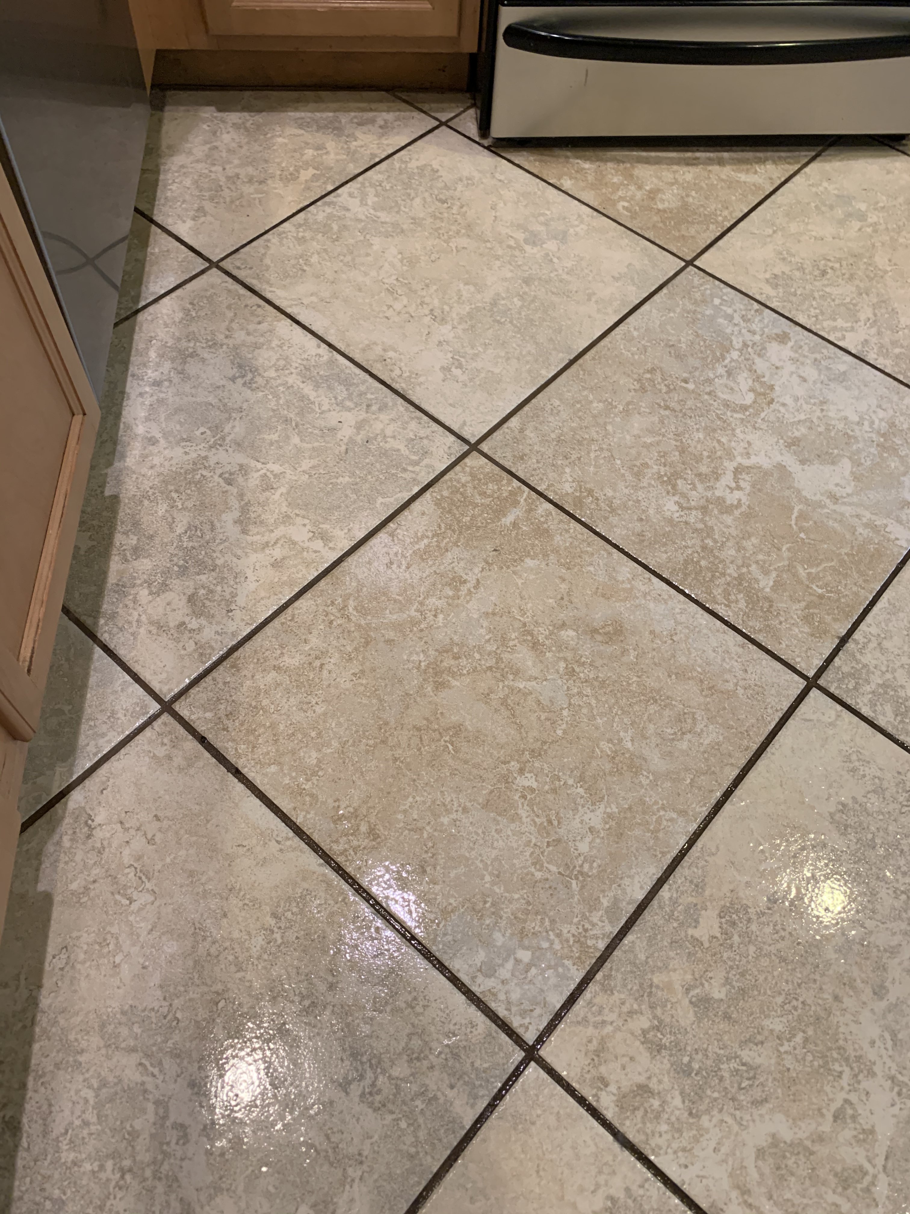

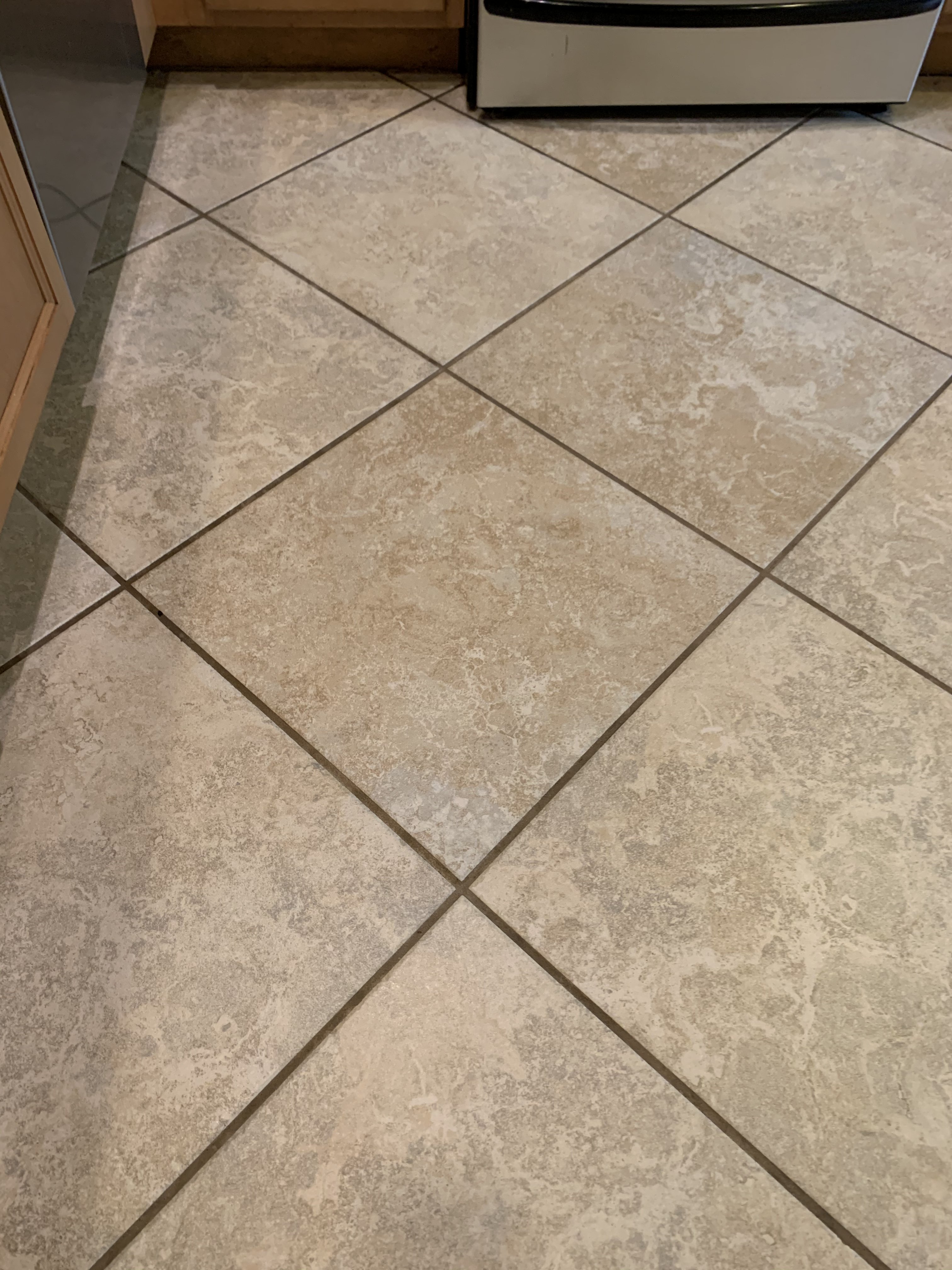

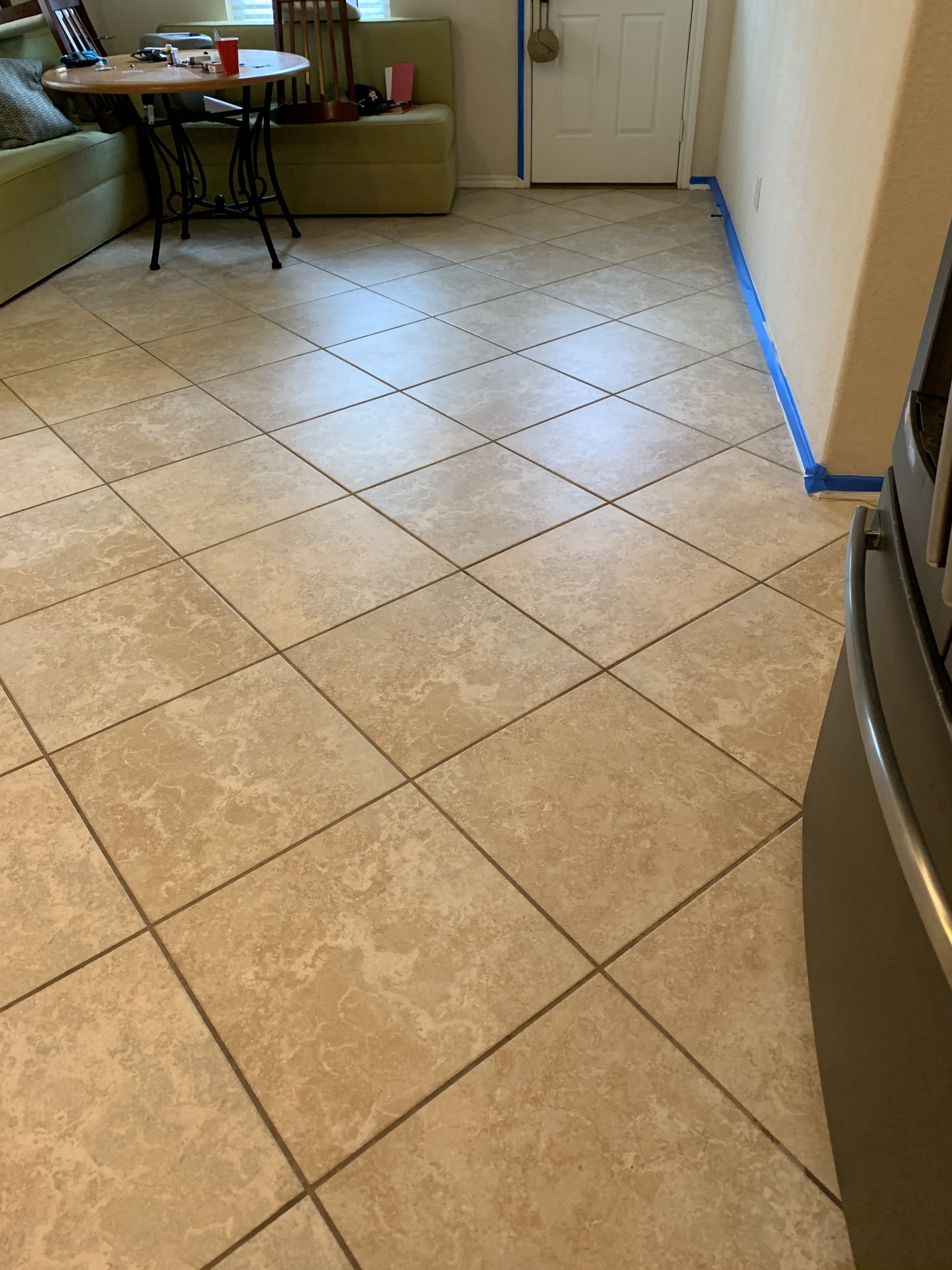

Did a tg job a week ago went back to clean her carpets and noticed the grout lines still looked dark. Grout lines were heavily soiled when I first cleaned them in her kitchen/breakfast room. I used Tsumani, crb and rinsed at 900psi. When cleaning was done it looked great, but after a week grout looked I didn’t even touch it? What might of happened??

First pic on top was the before pic middle and bottom pic were the after.

Was the first picture taken when it was wet? If not there could be a topical sealer on it. If they liked the shine they may have went back and put topical sealer on it again because they like the shine.

Pic was taken after ps was applied.

grout lines were reddish in color after cleaning...once grout lines dried after a week, noticed black spots in the grout. Blotchy dark areas on some of grout after drying.
117,327
Is it possible you removed some dye from the grout?
How about trying and Acid rinse....
Sealing with an Enhancer may fix it if acid doesn't
