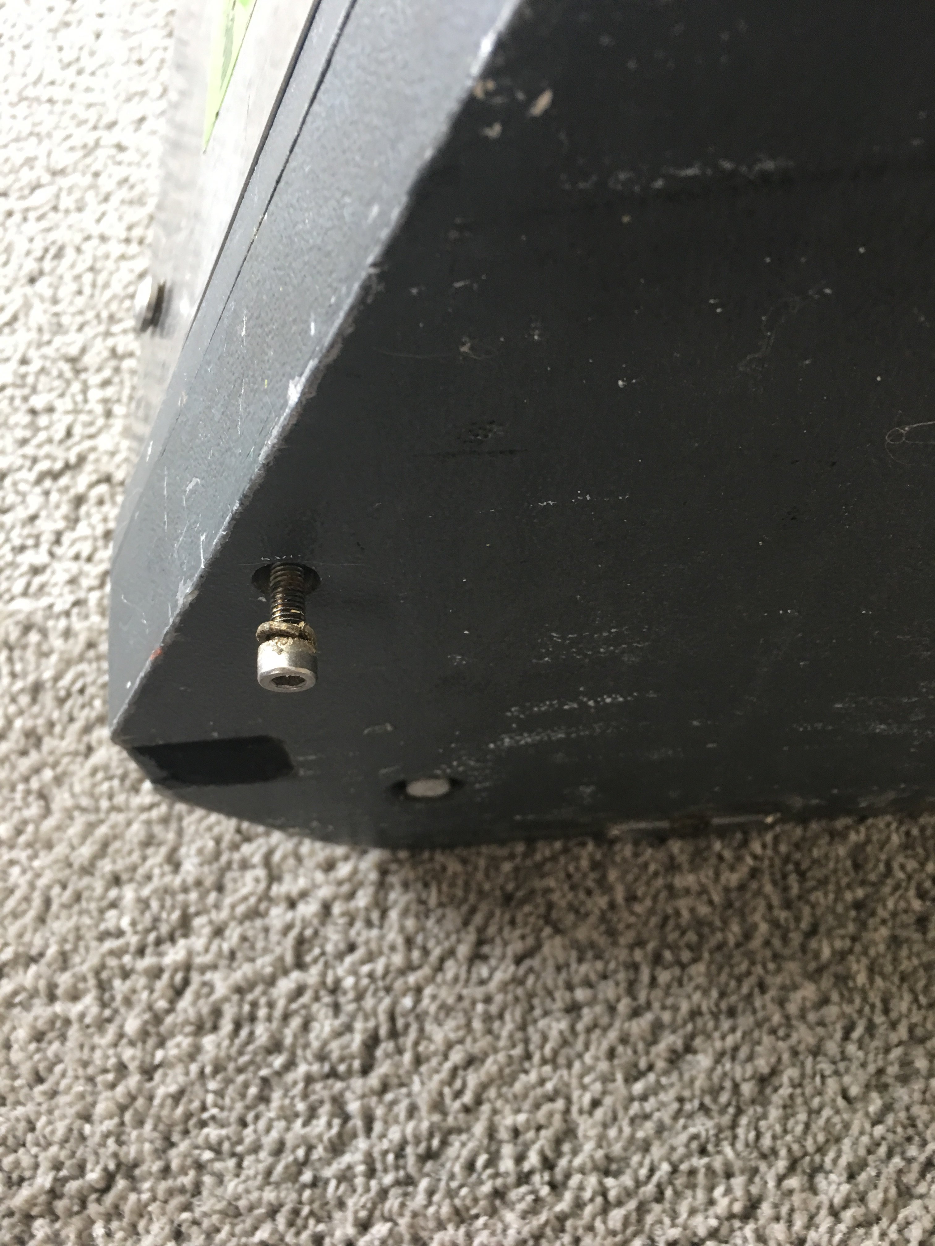

This might explain why my CRB is making so much noise
Cleaning Professional
Everything was finger tight. Odd. Maybe the big flux in temps lately lossend things up

Mine started making a lot noise. Kind of a laboring and squeaking. I loosened the screws that go into the center brace rod that goes between the brushes. Noise is gone. Don't know what would cause it to become to tight. I had never touched them before.
