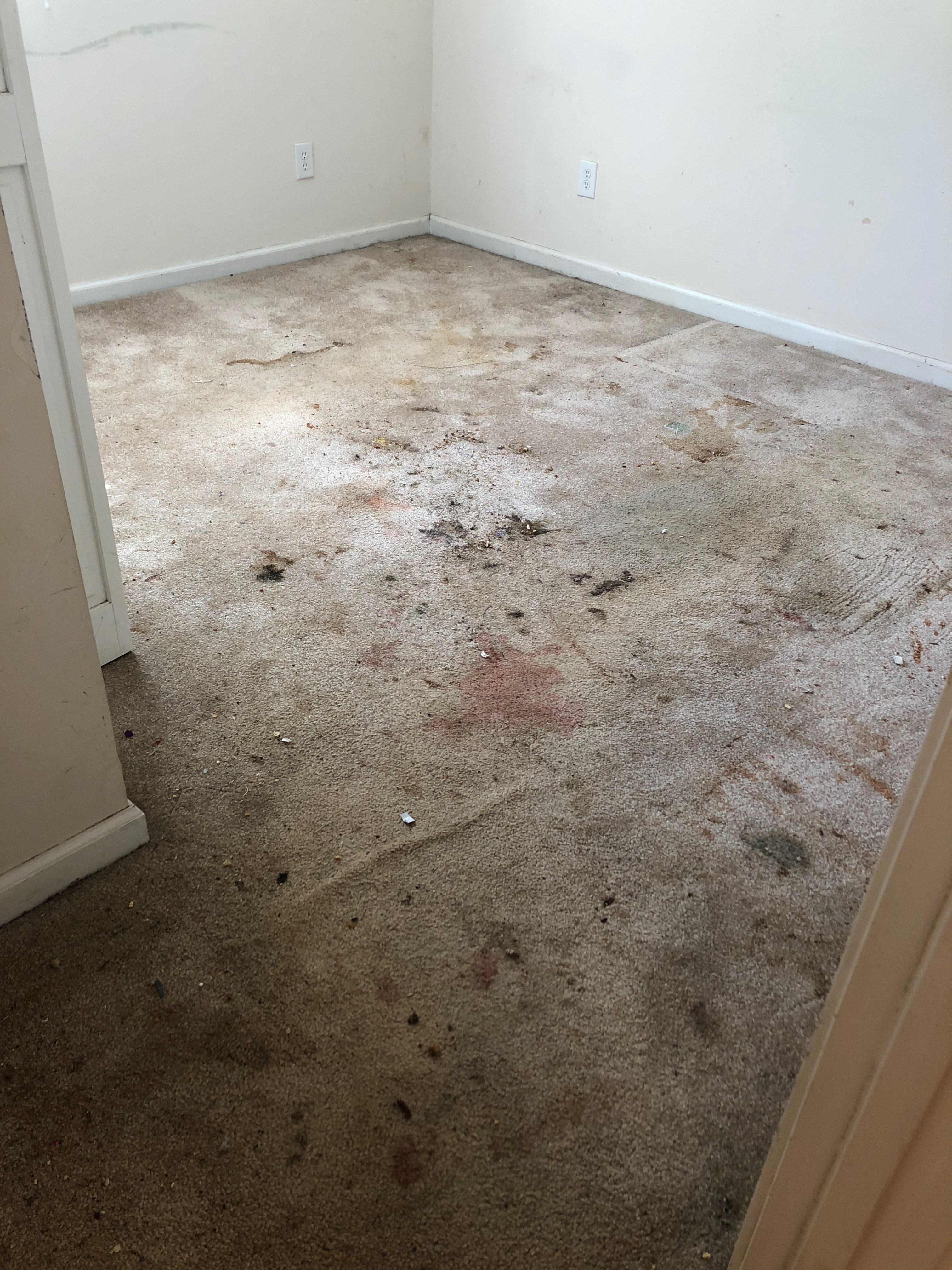

This forum is about cleaning carpet so here's a fun one
14,253
That I'll be doing this Thursday. I'll post after pics when I clean it

I wouldn't clean it....sometimes customers need to be told it's time to replace the fn carpet
nah. Besides the heavy soil and a small area where urine is, it should clean up just fine. You know as well as I do that it won't look new, but I can make it clean enough for another tenant. That's why I'm in this business. But they will be charged extra $$ for the extra steps needed to make it presentable since this is far beyond a maintenance cleaning.
Looks like it was used as a litterbox to me.
I couldn't in good conscience make it "clean enough" for another tenant especially since there are good odds that would be a child's room...
I probably wouldn't "help" a homeowner with this problem much less do what I know shouldn't be done to help a landlord save a few shekels...

Here is my question. If you start cleaning jobs like this are you not opening yourself up as the Miracle worker of what should clearly be replaced after cleaning and stretching costs. To me it is not worth my time or effort. I would rather stay with the reputation of being the high end professional cleaner. Once you clean that carpet, more jobs like that are going to come out of the woodwork and you are king of the Trashed Carpet.

It's not my job to tell the customer what I "think" they should do with the carpet. These stubborn people would just call somebody else if I tell them it's not cleanable. If the carpet is covered in urine over a dramatic percentage of the room, then yes, I would refuse it. But it's not. You know as good as I do, that I'm not just going to spray whatever is in my HF and do a quick HWE and leave. I don't need a lesson on ethics so I'm not ashamed of making the carpet cleaner than it was

Now I feel like I owe your judgmental ass my process for cleaning
1. Treat stains after vacuuming (red stain)
2. Heavy acid rinse all urine spots (I don't do the peroxide/bucket flush method on carpet anymore with a wood subfloor and pad underneath due to increase of dry times and added growth of bacteria)
3. Treat carpet with surfactant/heavy peroxide mixture
4. HWE with 600psi of top heat and Milban 1-2-3 24oz/gallon set at 4 on rinse.

Exactly. The customer says, "I know it needs replaced, but I just want you to clean it". Ok So you satisfy the customer's needs. They don't need a lesson on ethics. You do the best you can and don't overpromise and let them know that gravity is still in effect underneath the carpet.
They don't have the phrase "professional opinion" for no reason
So? If you've advised him the carpet should be replaced you've done your part.
Mr.Owners may not need or want a lesson on ethics but you should have some

So did you do the right thing.....or did you clean it?
If you did clean it, with it now being wet, can you explain to me how you've done anything but create a cat 3 water situation where the carpet and pad would be disposed of?
Poor little Timmy will probably have Toxoplasmosis now....
