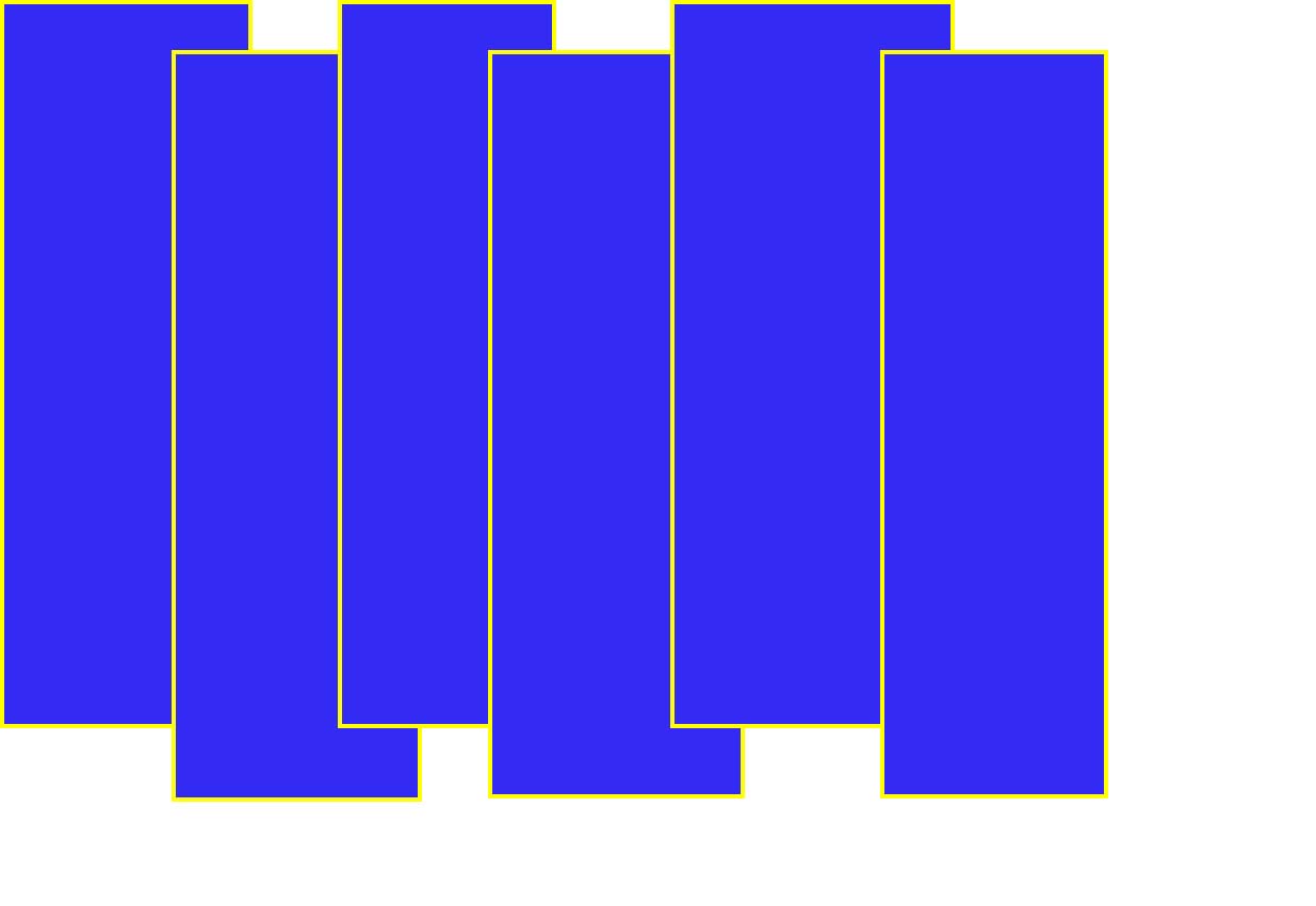

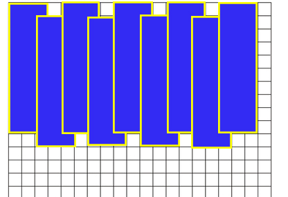

The proper wand stroke will ALWAYS produce better results.
We have figured out that 2 wands moving at the same time (running dual wands in different parts of the jobsite) will produce excellent results and will cut our time at the job by about 40%.
Time is money as long as you are still doing an excellent job.
unfortunately not
I compensate with my ss12 by overlapping by 1/2 for extra rinsing as was suprised what the window showed

It's certainly doable but I haven't done it
ss12 6 flow, my main wand for light-medium soiling
devpro 8 flow, medium- heavy soil
rotary for trashed
I only overlap by half with ss12 towards heavier soiling when haven't got devpro out, as its a lighter and nicer wand to use
