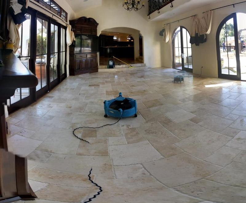

the NUMBER ONE essential for tile and stone cleaners..
116,393
in 3 hours we swept, Flex'd, Turbo'd, Airpath'd, Cobb'd, Airpath'd again and collected a check for $1240..
"just" one buck a foot for clean and seal.
Work smart and fast.

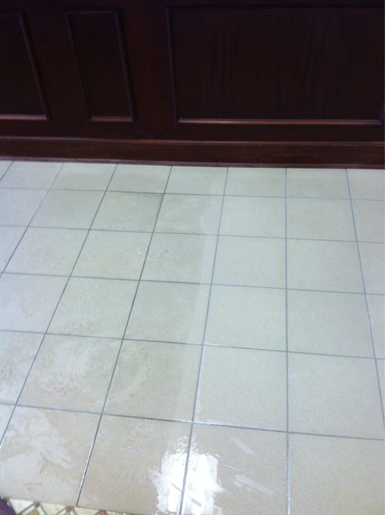

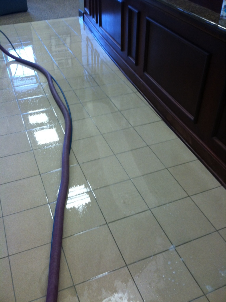

This is a shot of a bank lobby we cleaned this morning. Cobb's PowerMax mixed at 2 oz per gallon in super hot water. Mopped on, a few minutes dwell and then the turbo at 850 psi. No scrubbing.
Reactions: Art Kelley
116,393
Some grout just needs to be agitated no matter what nuclear jizz you put on it
Raise your pressure above 1000 or crank the heat and you'll risk cracking joints

On castle( ashlar) installs like mike has shown, improper installation technique is the norm.
With a near butt install with chiseled edge, sanded grout for most part ends up only in the bevel and not between the tiles themselves, where it's suppose to go.
By definition, an improper install.
You will often see this install with varying grout "fullness"
12 inch polished marble with micro bevel falls in same category
So yes, agitation is preferred over hi pressure in getting grout clean, as well as other process.
