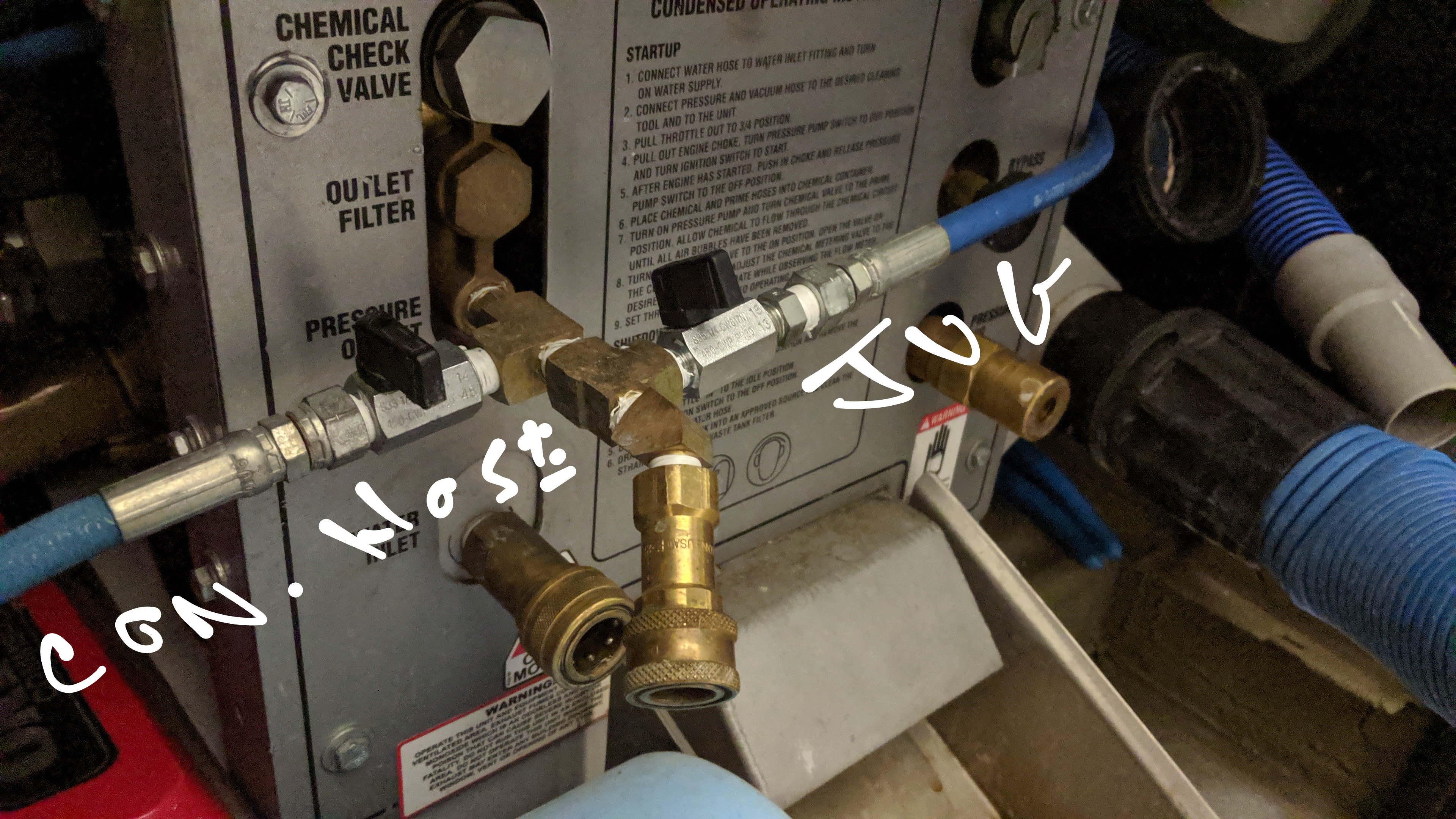

Good to know. My system is vastly different than your system. It seem that your system produces heat and maintains it better. I wonder if i can improve it.. would cover up the heat exchanger completely with insulate blanket improve heat?
Still learning it. Maybe winter just make it colder as fresh water just cold.

Do you keep your wand planted on the floor when you clean? The less you pick your wand up off the carpet, the hotter it’ll get
And did you also check your engine’s rpm at full throttle? These machines are known to have a setting that isn’t accurate
