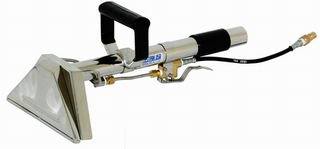

I gut down my steamway wand for a long handle stair tool . Works great.
G
Greenie
If Mike didn't like the UT-40 for stair and a general all around utility tool, he ain't gonna like the SW wand cut down.
Actually I think Mike is screwed, cause he probably won't like the aw29 cut either?
for a guy who is 6'7 wouldn't an aw29 already be a stair tool?
The SW does have way more value (and weight) on ebay, you'll get $200 instead of $75 for it.
Honestly, since you are used to wanding stair with your Titanium wand, you probably just need a 40" long straight 2" pipe, 14" wide stairtool, and call it good.
And keep the aw29 or SW for Todd when he visits.

Then, maybe you shouldn't cut a 12" wand, this 10" wide wand may prove more useful on partitions and small stuff...and yes there is a glide for it.
Mikey P said:
I
I actually may be doing 200 partitions soon and want a quicker tool then my PC uph.
That's a horse of a different color than a stair tool.
for partitions, church pews and long straight fabrics with areas large enough to make wide wand head use practical,
a glided AW29 over the SW wand any day
