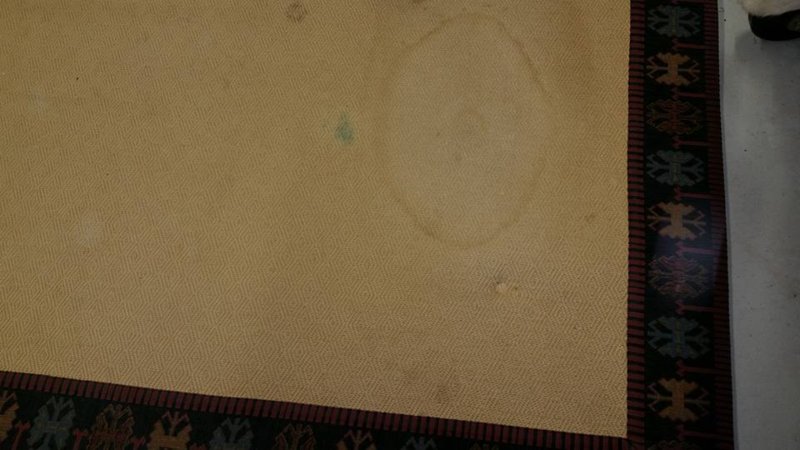

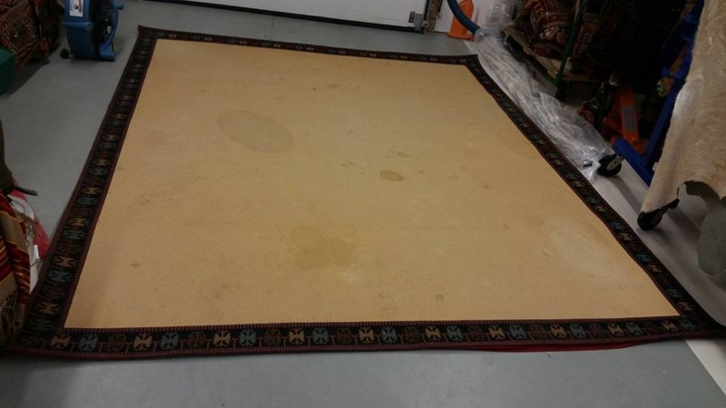

A client got this rug as a gift and wondered if it would clean up? What do you think?

The Stark label means it is a pricey rug. You could afford to spend a little time on this and charge right.

Not Sisal with that design! From what I can tell. Synthetic? Wool? I would test first then hammer it hard....seems to have been hammered anyway! Structurally looks OK?

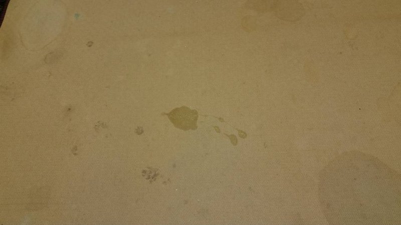

It is already doomed. It is a Sisal field and severely bleached-out in some areas along with a great deal of stains.

What's the worst that could happen?

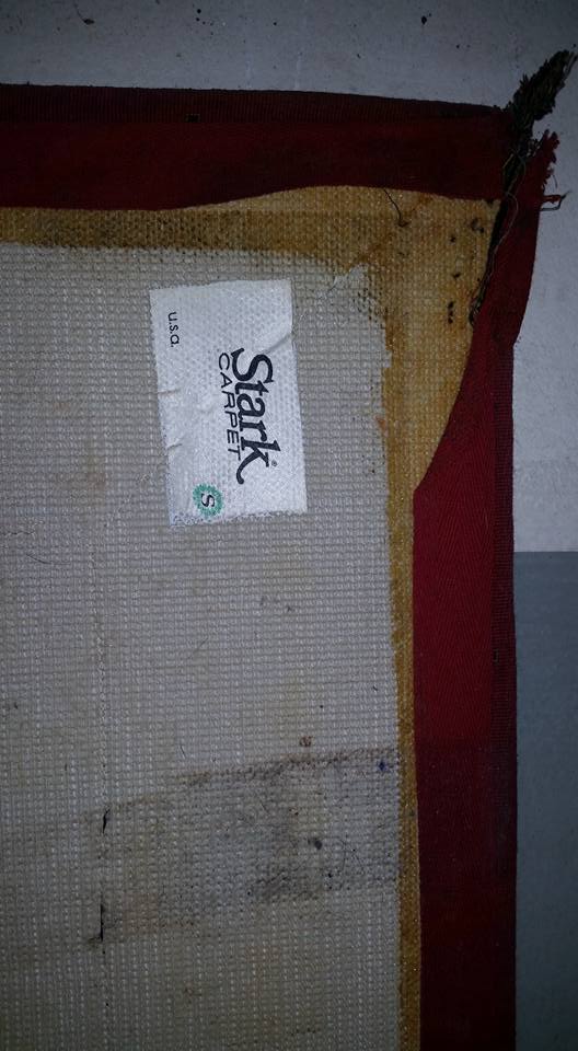

As you can see the corners are already Curling up and this is just from absorbing moisture from the atmosphere. Once the border get wet the corners will pull/shrink in different directions--- which means you might have to disassemble the border and restretch the carpet and border and put it back together.
If you are new to rug cleaning just avoid rugs by Stark--unless you have a lot of extra money in the bank or great insurance to pay the customer for the rug.

The Stark brand meant something pre-recession. Now they stick their name on anything.
You might see how well the label cleans up, then glue it on one from the actual manufacturer of this rug. That's where the value of this rug lies.

What I find funny is the work performed. The tapestry border is falling off. It looks like a kindergarten kid applied to much glue. Lol sloppy. I'm glad my label is not on that. According to the backing it is not sisal.

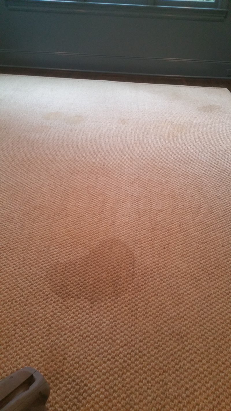

Here is one I did today. Piss as well . It was still damp . I know it is going to dry up nicer.
