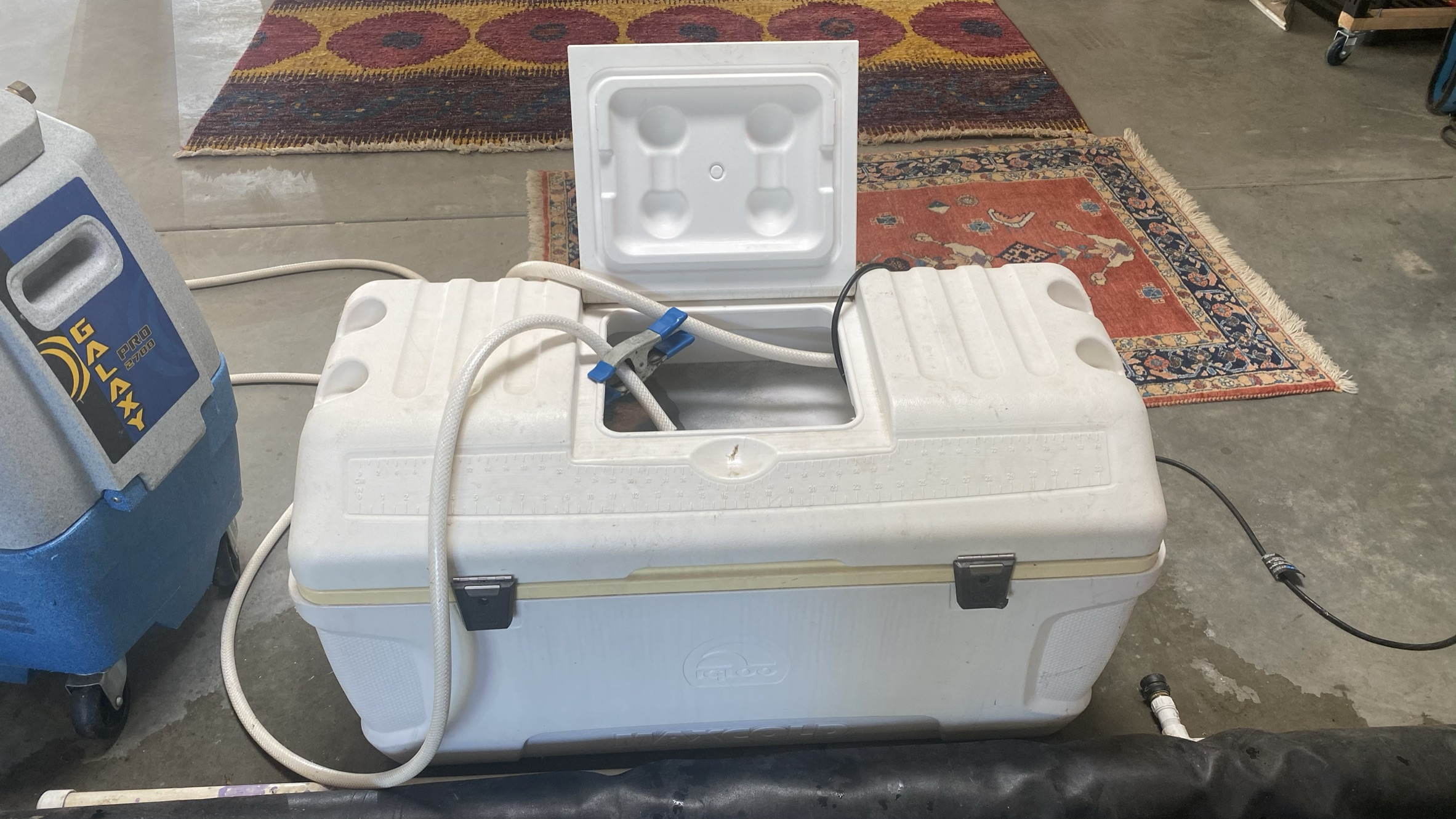

Anyway, I have a bunch of rugs in the shop and they are all urine soaked. Not sure how I'll do the bigger rugs but for now I'm using a large cooler to soak the smaller rugs in Rug Restorer for 8 hours. Inside the cooler I installed a submersible pump to recirculate the water. I need to do what @Joe Appleby does and make some large tanks out of some pipes. Joe, Any chance you can send me some pics of your soaking tanks and maybe let me know where you got those large pipes? I thought I took some pics when I was in your shop for @Jim Pemberton's class but I can't seem to find them. My cell is 530-355-3363. It would be much appreciated.
