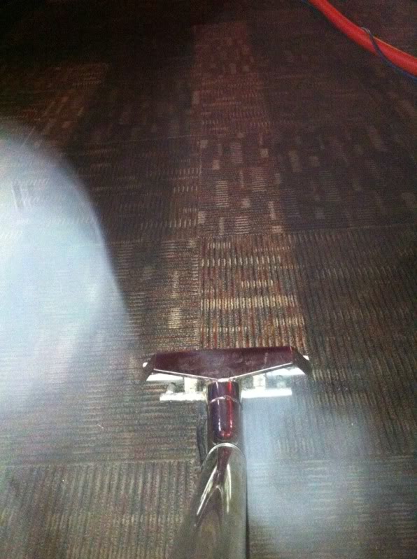

side by side Powermax to S&G..not much to show
I though sure we'd hit pay dirt today with one res and three sec 8's
I knew the res wouldn't be dirty, but thought sure at least one of the sec 8's would be..but not so.
this is dirtiest carpet we saw all day
Typical builder grade Nylon
quick vac and split the dirtiest part down the middle
Mixed one scoop of S&G
2.6 scoops Powermax .
Scoop used was the typical scoop in most jugs of powder (2oz I think)
Mixed in separate, clean jugs using hot tap water from the kitchen faucet .
I'd estimate 100-110 degrees
Application RTU @ 250 sf pr gal
I'll let ya'll judge the results
BTW, i have no idea why the red areas ..there was no visible red to the eye
If you look at in the right corner above the register, there's red on the wall too....
Unless it's one Duane's ghost oRbs :shock: I haven't a clue where or how it showed up

So you set up some cue cards and red tape on a lightly soiled carpet that virtually ANY carpet prespray would clean with little to no dilution
JHC did Mikey ever send a painter to do a carpet cleaners job
I hope you used the same PSI

fook that was suppose to be trashed???
anyway 2 things....
sometimes when you clean...it cleans the dirt off the stain.....come on rookie 8) 8) 8) 8)
nah, there were no red stains before or after.
and there certainly wasn't red on the freshly painted wall above the register in the last pic

You don't need some passed his prime section 8 cleaner to do the test. I can tell you because I use both products regularly. Slop and gobble mixes better cleans awesome. Powermax mixes shitty and cleans awesome. you have 2 high Ph cleaners that clean. Besides that Larry that carpet isn't clean because you glided it, if you want it truly clean you have to wand it again with the face open/////HACK
If you want to pimp a nasty section 8 get slop and gobble or powermax(you are going to need hotter water to mix powermax) boost with some magic wand oxyblaster and cruise. Make sure you prespray, prescrub, glided wand then open faced wand. That is what we do everyday
