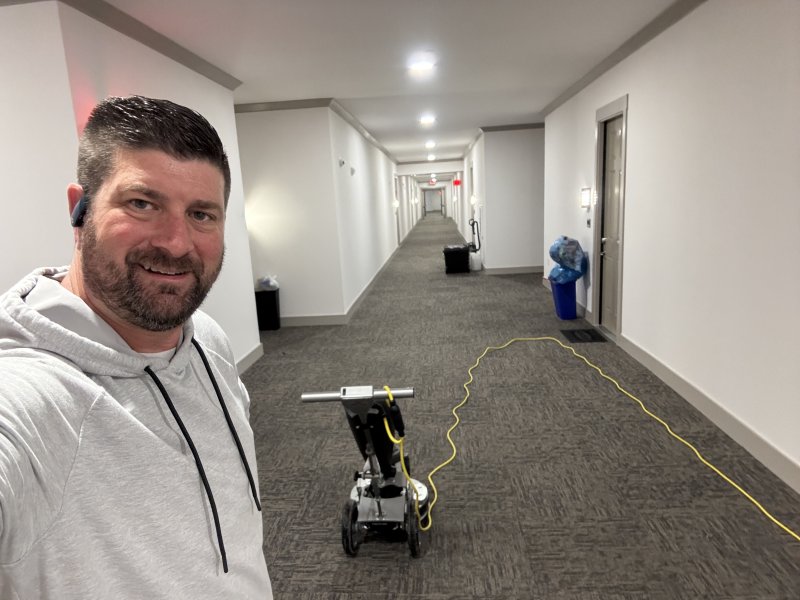

104,000 sq ft that included 15 four story stairs. 8 total days but had 1.5 days off to fit in a few other customers. (6.5 days on the job) My first VLM job. Mark never did show up but his 2x Oxy encap sure did. Stuff worked great. Went thru probably 9 gallons. It was my oldest son an I for 90% of the job. That’s a lot of work. But I’m now ready to VLM full time. Way more profitable. They are pleased with the results and booked 3 more units all almost the exact same size. Only 320,000 sq ft to go. Thanks for the info in my prior post to get me going. I did watch a lot of Mark’s videos before I started.

We're you using the Saiger Blue or the Red?

VLM allows a guy to reach any job. The sky is the limit when someone understands the process and concept.
We did 2 jobs over the last weekend. Both commercial, both VLM. Neither one was accessible by TM. I sure as heck didn’t want to porty them, as the soil load didn’t warrant it.
Used properly, it’s a viable way to maintain commercial carpeting…
Just remember, vacuuming is an essential part of the process.

I underestimated the amount of time vacuuming would take. Fortunately they had a ride on vacuum and a large area vacuum. Each of the facilities I’m cleaning do. I will need to buy myself a large area vacuum vacuum soon if I’m going to continue this.
Any recommendations on one with baseboard brush? The ride on had one and it’s very helpful.
