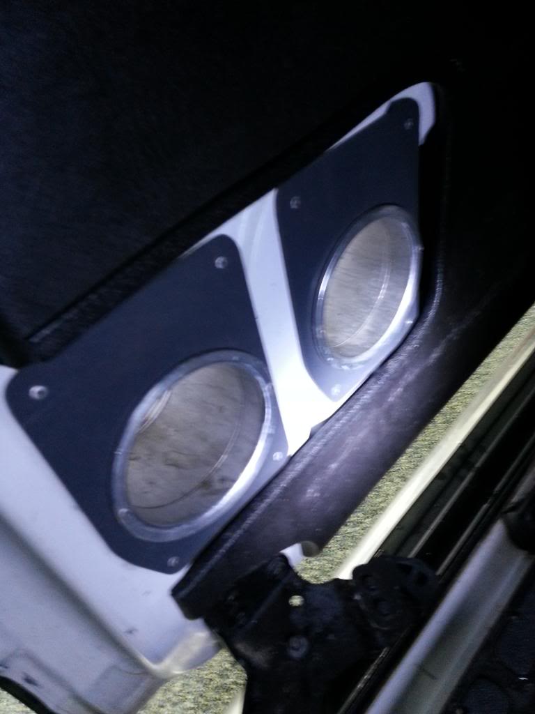

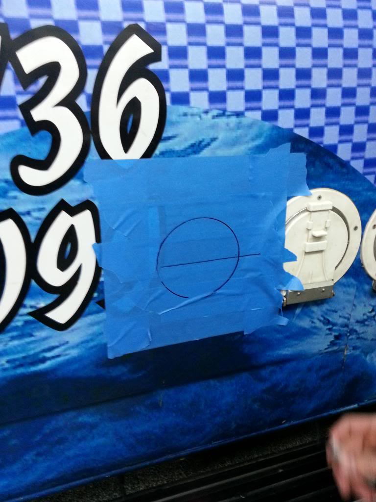

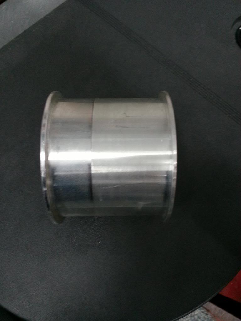

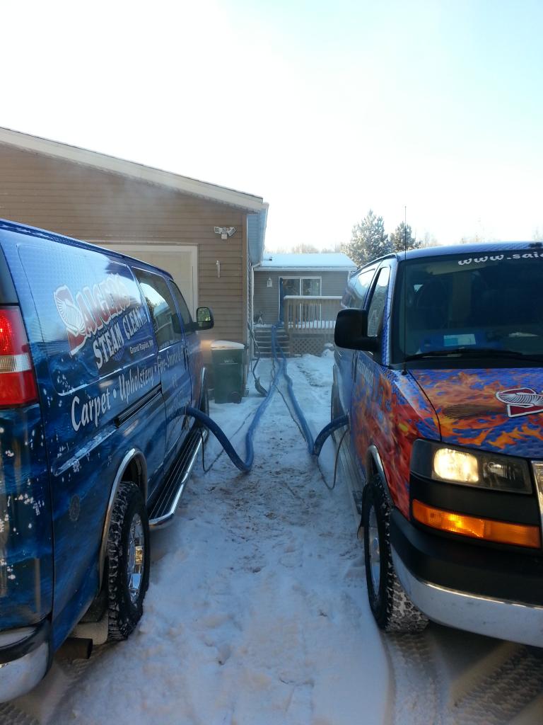

  • Mark, that is very neat and thanks for the pictures. Is opening or closing while hose in create any issue? What's the distance from door to where hookup is?

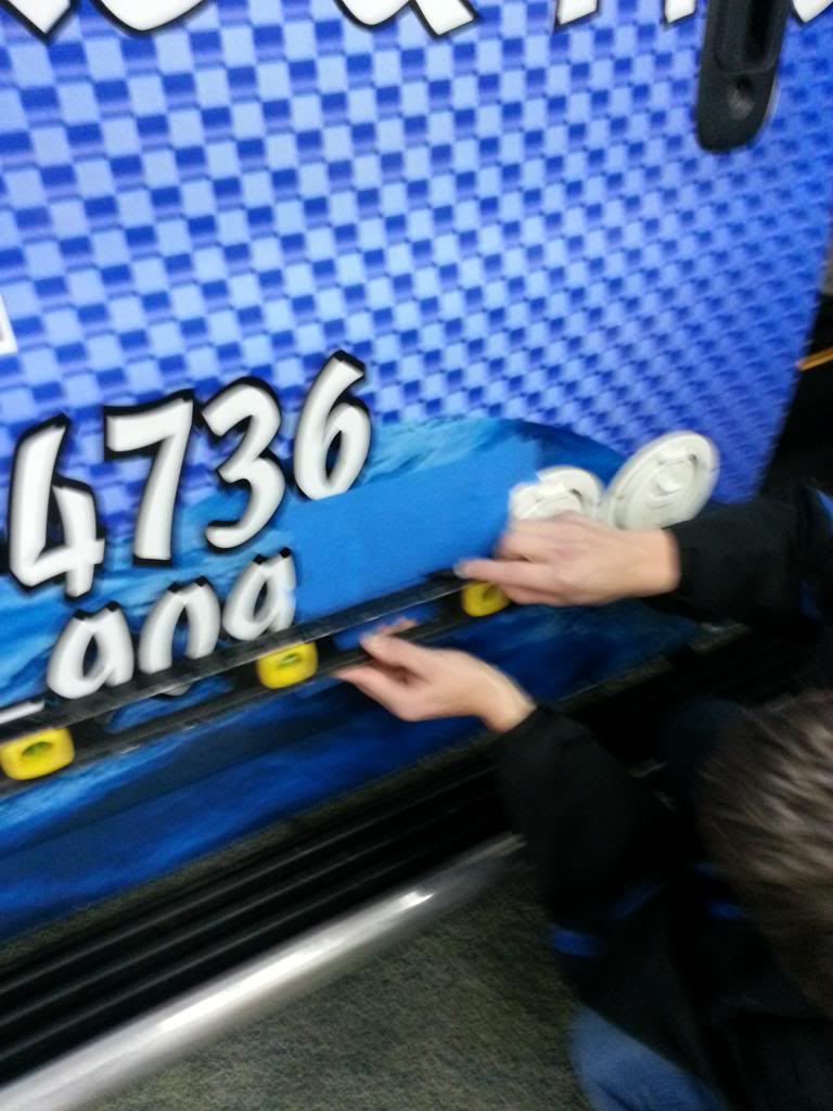

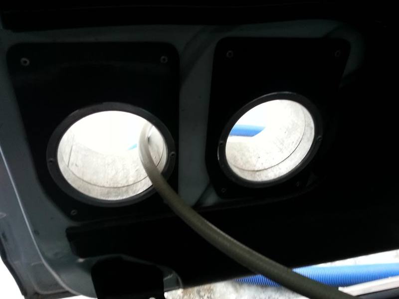

Hopefully you just got a chance to see the videos posted (while you were both posting your threads)
The videos will maybe help with all the ideas mentioned.
