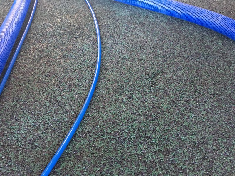

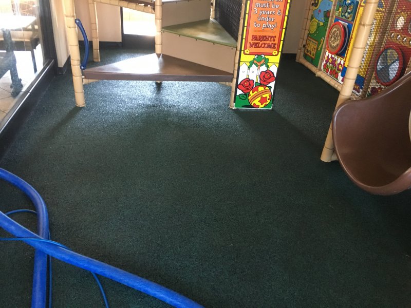

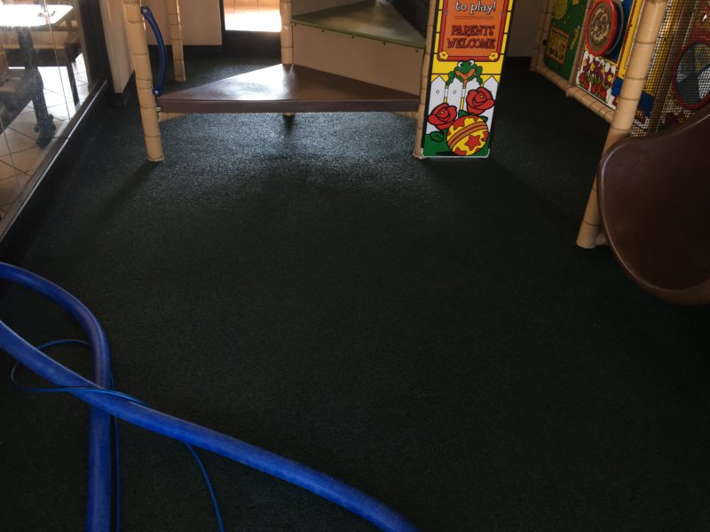

I cleaned it just like carpet, except I turned up my psi to 750. It was my first time. Has anyone ever cleaned one of these?

All those pics are what it looked like after. The change in darkness was just my flash being on and off

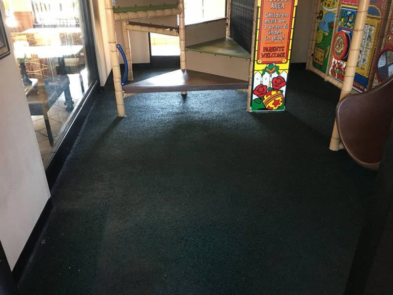

This was before
